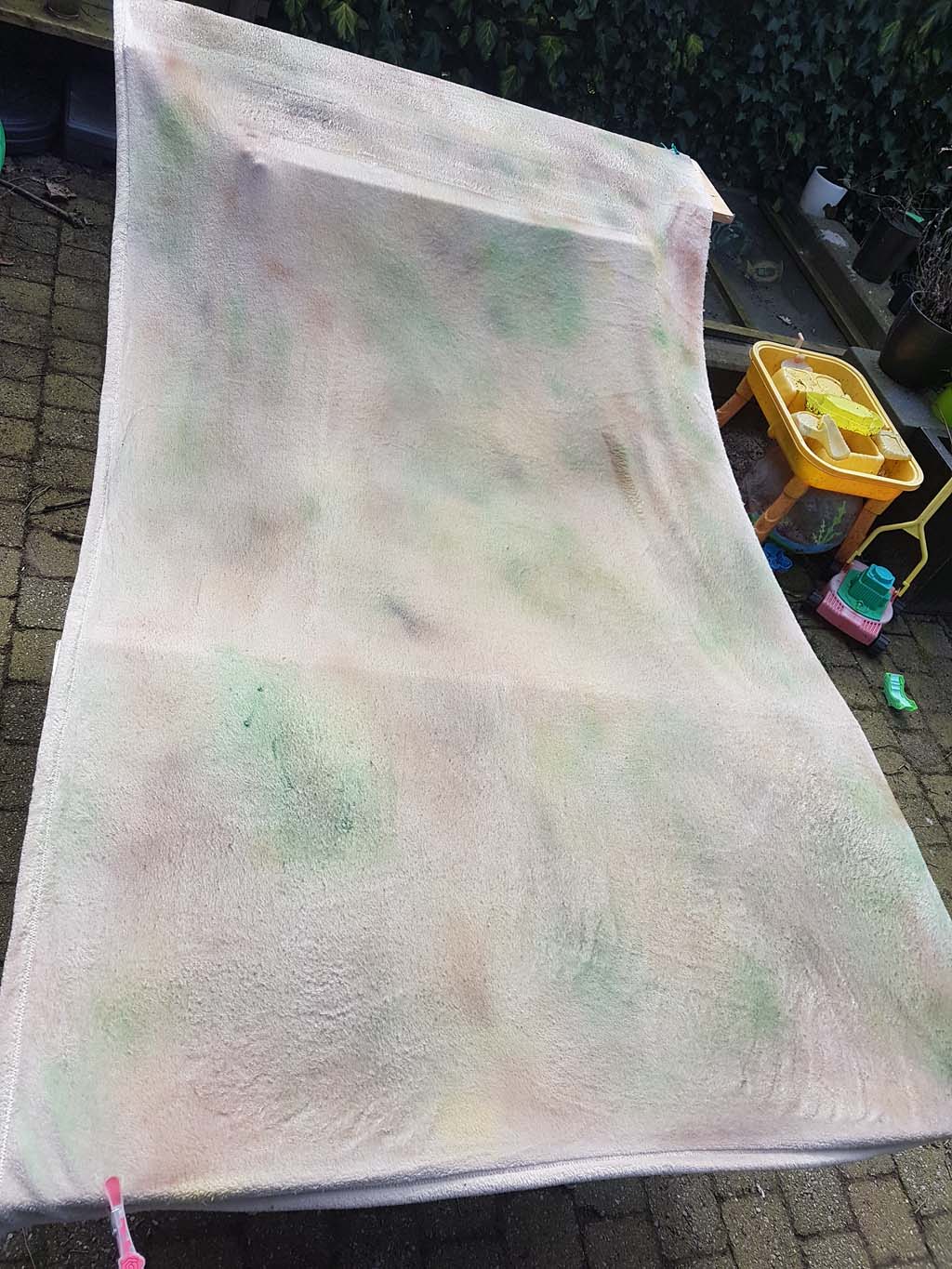

I first cut the blanket mat in half, storing one half for later, and stretching the other half out for the application of paint.
The base colour is a light tan colour, which is great for a number of different types of mat. But here, I just went for a simple natural, patched look, just breaking up the even surface enough to make it believable as a gaming surface.
The only pictures I took during the process are from when I was basically finished though; the entire thing went so fast, it was done in about 30 minutes, and I really took my time too. Drying time was also almost nonexistant, as the misted paint dried immediately when it touched the surface. Of course the burning sun really helped in that regard too.
What I did was mist the cloth with different colours of spray paint in irregular patterns. I went from a very light brown, to darker brown (I think I used 4 different colours), using less as the colours became darker. I then went in with a medium green (this is where the only mishap occurred; I wanted to use a dark green can first, and even though I shook it well as usual, the can merely spluttered a couple of very thick drops of green goo on my mat. I quickly wiped those off as best as I could, but they remain visible. Not annoyingly so, but I know they're there. It was an almost decade old can of special graffiti paint, which is made to cover any surface in one go, so is extremely pigment heavy. Apparently, after that long, I should have shaken it for at least 10 minutes...). And then I misted those areas with a pale yellow.
Then some light grey and finally some darker patches with black and I was done.

First, here it is, drying in the sun after I applied all the paint. It looks really pale and washed out here, but the colours are much more vibrant in real life.
In the first picture, you can see the remaining traces of the green incident:
And here it is with a corner flipped, so you can see what it originally looked like:

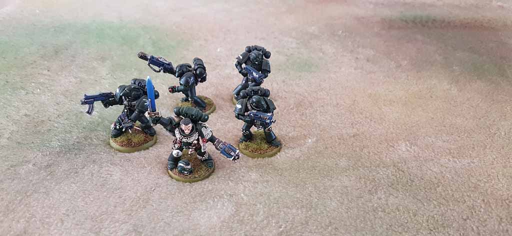

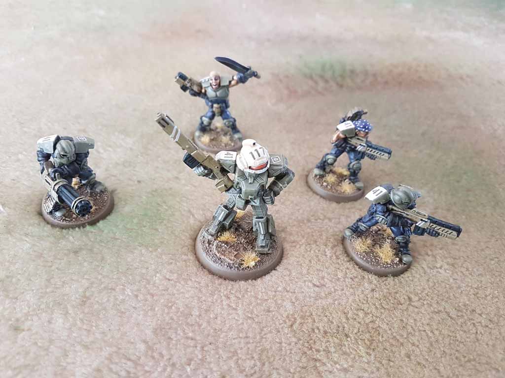

And then some pictures with different types of miniatures and different types of basing, so see how well they work. I use the same bucket of wall paint I had mixed up years ago (approximating the old GW Graveyard Earth) as a base colour for all my bases; just the finish is different on each army. And the sprayed mat works very well with them.
It works especially well as a Kursk-like plain for 15mm miniatures:

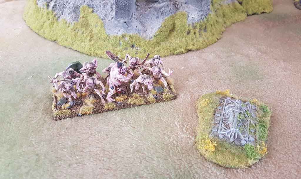

Classical green base edges don't work as well. These guys are really old though, and rebasing them has been on my to do list for years now:
The same goes for some unit trays, but in my experience, those never work very well. That partly has to do with the square edges I reckon. Square bases obviously are the same.

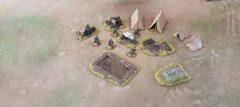

Here's and archeological dig being scouted by a group of Fallschirmjäger. Even though the terrain pieces were made to blend into a traditional grass mat, they don't stand out too much:

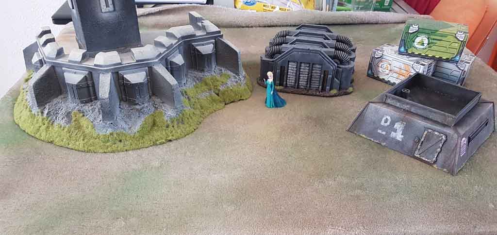

And finally a shot of some larger terrain pieces. The same applies here; the green does not really match, but doens't really look out of place either. Elsa is courtesy of my daughter, who helped with the setups and wanted to play with her dollies as well... :)
