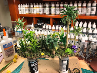

I just finished some Jungle Terrain sections for my upcoming Historicon game (DAK & Dragons 2.0).  These were inspired by a video series on the Terrain Tutor youtube channel but probably not executed as well.
I really like how they came out, especially the bamboo sections.  The plant spacing was done to ensure figures could move through the terrain as these sections will be used with a variety of rulesets.  I did try to add vines but those became really cumbersome and reduced playability so that idea was abandoned.
There are 24 sections which were cut from a 1/4 inch 2x4 sheet of hardboard with one side being a blackboard  - that side faces down and I've found having the finish both prevents the plates from warping and ensures they don't catch any ground flocking.  All of the vegitation was sourced on Amazon - the palm trees models were really cheap ($8.00 for 15) and the other "plants" were just plastic and/or aquarium plants cut up into small sizes.  I think I spent less than $75.00 on all the materials, including the hardboard.

Looks good. It's not always easy to find that balance between aesthetics and playability. It looks like you've got it right.

They've turned out great  8)
The only thing I would mention is the sheen on the plants but that's more of a personal thing and not an easy thing to combat.

Totally agree on the shiny comment - I ran out of dullcoat and have some on order

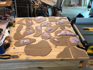

Thanks for the kind comments.  These were a lot fun to build and I used the following steps:
Making the bases
1) Draw out the sections on the material you will use for the bases.  I used a 2ft x 4ft sheet of hardboard that has a blackboard on one side.  I've found the blackboard version of hardboard resists warping and the blackboard side also resists grabbing any material on your table top.  These are roughly $10.00 US for a 2x4 sheet
2) Cut the sections out with a jig saw and then bevel the sides with a dremel the mounts a sanding disk.  This is the most tedious step of the project so I suggest you do a large number of these at once.  It also creates a great deal of harmful dust so have a way to deal with the dust (I clamp the hose of my shop vac to my workbench).  You should also wear a respirator as the fibers are not all the friendly to one's lungs.
3) Add some height variation to the bases by glueing some EPS foam and sanding it smooth.  This is an optional step but I thing it adds some visual appeal and allows for some customization.  Again wear the respirator when sanding EPS.
4) The last step in making the bases is to texture them - I like to use a mixture of flexible tile grout and white glue - roughly 3/4 tile grout, 1/4 white glue.  I get a pre-mixed version of tile grout thats already colored (earth tone).  Put a thin layer of the grout/glue mix on and let the bases dry for 24 hours.  The result will be a rock hard covering that has a very nice texture.  Once the tile grout has dried, I then painted each section a light brown.

Holy deadly sawdust, actor in tights playing a super hero!  A dremel tool for the beveling?  Man, that is way, way too much work.  Hi thee to a hardware store and get thee a belt sander.  While still some serious work, will save a lot of time.  And if you use real wood - like underlayment - it isn't nearly so unhealthy as hardboard dust.  Still good to use a mask, though.
