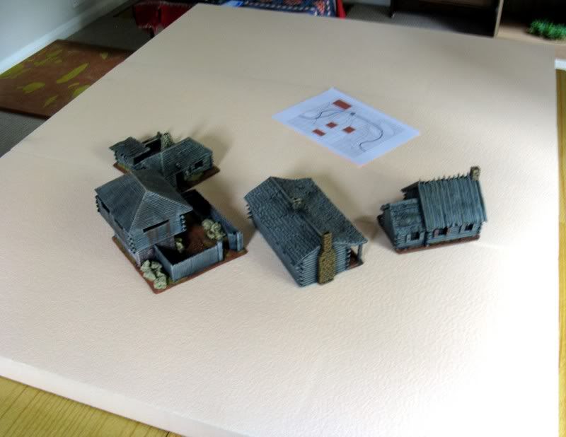

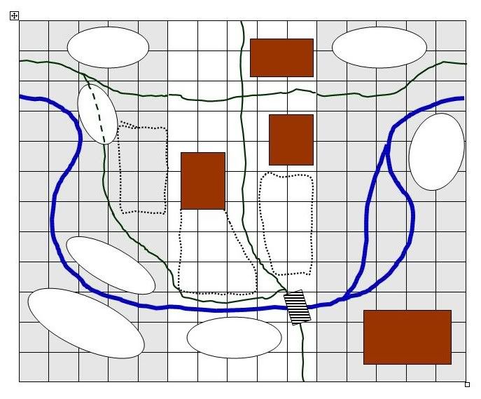

Step one. Think about the game area, and draw a rough plan which I'm then going to scale up onto the boards themselves...
Issues:
1. I have four Grand Manner 'Americas' log buildings I want to use - so the terrain will need to be designed around them...
2. I also have lots of individually based trees, which I'd like to re-use. So I'm going to need to leave some flattish areas for them to stand on... The whole thing can't be too undulating...
3. I'm going to include a river - obviously - but I need to arrange it so that each river section enters and leaves its board at the same point along the edge, so that - theoretically - I can put the boards together in different combinations...  ::)
So, here's the plan...
And here are the boards, the plan, and the four buildings...

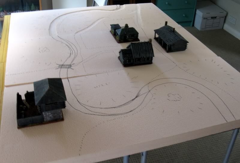

And now here's the plan transferred onto the boards with a Posterman marker.
You can see where I've started to sand out the river bed and trackways on the first board using a Dremel minitool.
I'm going to make the three boards one at a time, get each board to the primed stage, and then paint and do the scenics on the three of them all at the same time - which'll be in about 2 months time at this rate!

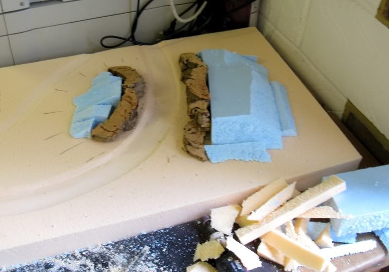

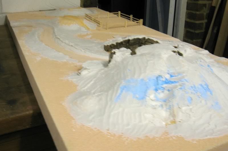

Right - onto board one in earnest then... I'm going to include a small gorge for the river to run through at one point - which will probably have a single fallen log bridging the chasm, for the helpless heroines to flee across from the savage huron...
The basic superstructure of this natural marvel is cork bark and blue foam...

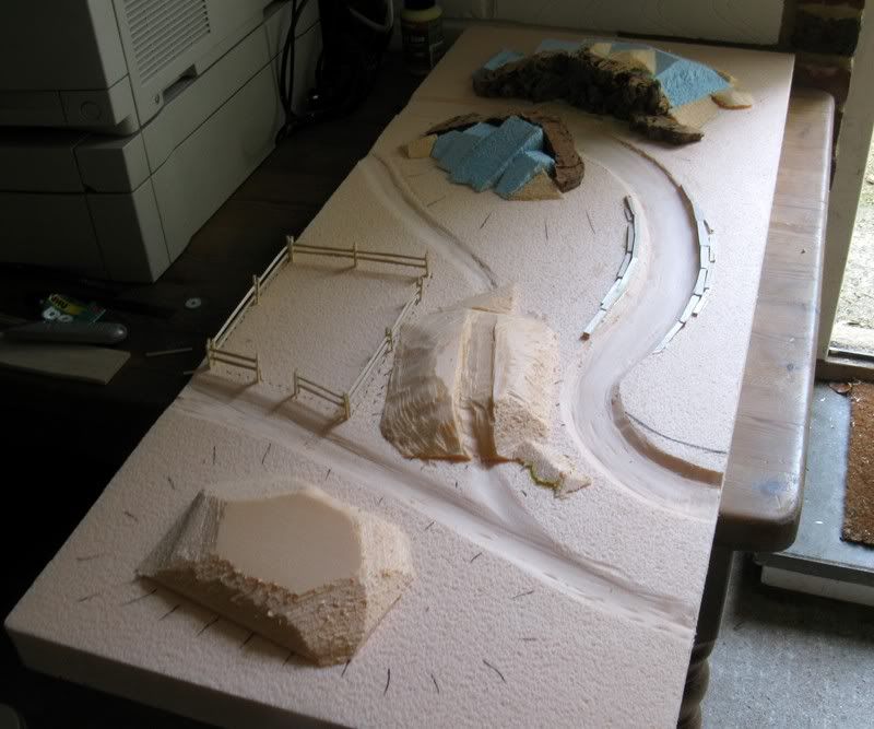

Next, I've added the other lumps of high ground - yes I know they look clunky - but fear not, all will be neatly sloping and blended-in on the finished product.
I've also added the first field with fences created from matchsticks and coffee stirrers  :)
All glued into position at this stage, because I don't want to be trying to shove sharpened matchsticks through the crust of my filler and sand / grit / PVA hard surface...

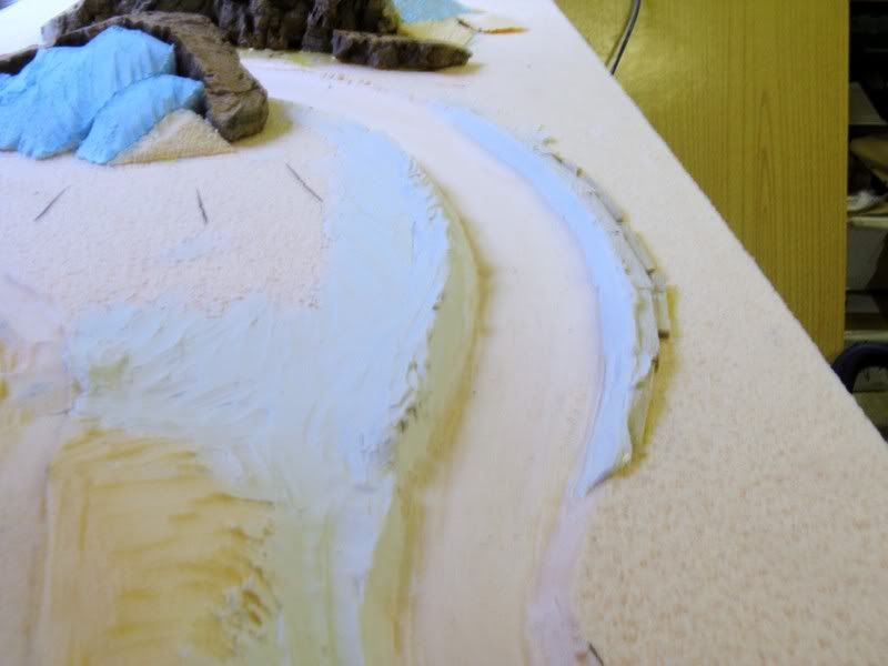

You can see where part of the river bank is going to have high banks... I've stuck on some small pieces of balsa which follow the curve of the river. These will provide the structure to do this...
And here you can see how the riverbank is built up... Nice smooth muddy banks, filler applied with an old knife. And then what will be turf spilling over...

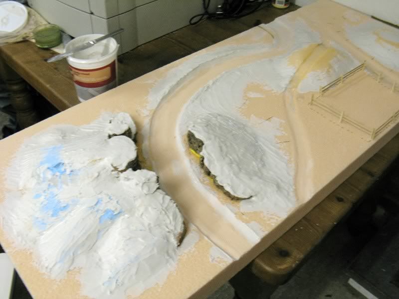

And finally - once I managed to get the right bloody glue for the styrofoam and the stuff finally went off - I got on with 'icing' the whole thing using ready-mixed B&Q filler - lovely smooth, sticky stuff this :-*
Mind you, believe it or not, I've just used an entire 1.5kg tub on just one board...
And that's it for now...
If the filler has fully hardened by tomorrow evening, I shall get the first layer of sand / grit / PVA surfacing over the top, add rocks and so on, and will be able to see rather better how it's going to look... It always looks crap at this stage. You have to be able to visualise the end product you're aiming for...
