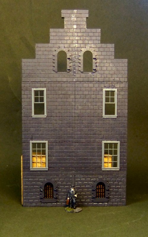

Here's how I used a few sprues. This is the east wall of the Colonel Stone Hall. It is put together with three square tower sides and three 2height enhancer" pieces. The bottom row, which will be the  basement gets to keep the  out-of-the-box windows and  grating
but the ground floor and first floor's got new window frames. They really should be somewhat recessed for for this architectural style but  for the sake of expedience I ignored that for this particular building. I will try to achieve that for some other wings. As you can see I already have managed to bust the bottom left panes. Also I have to go back and reposition some of the top row windows which have slid all wonky like... :-[
The north wall of the hall, two wall sections wide and two crow-stepped gables. Normally I would fit two windows wide per section but I have left space for a passage building between this and another hall.
On the back side you of this wall you can see how the customized window openings work out. As you can see there are pre-moulded slots you can cut out for windows but I have cut out new openings which makes for taller floors and  larger windows which is more fitting the Baronial style.
Next I shall fit the four sides, and the S:t Mattias tower on  it. I am not a great believer in sub tectum wargaming but I will be fitting internal floors, one flagstone and two planked between the floors. The top one will be for practical reasons as it will be visible through studio windows.
« Last Edit: September 27, 2011, 08:30:10 AM by Hammers »
