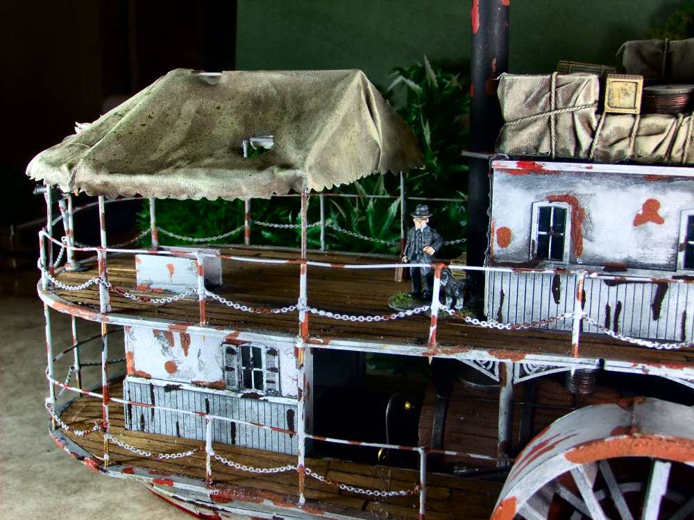

Detail of aft upper deck.
The canopy is made from a pair of old boxer shorts, just because they had the right kind of weave. The fabric was cut into the right shapes. I wrapped plastic foil over the  structure and glued the fabric in place. When dry i burnt, tore and darned it in place to make it look old. It was then painted tan and stained and spattered with inks.

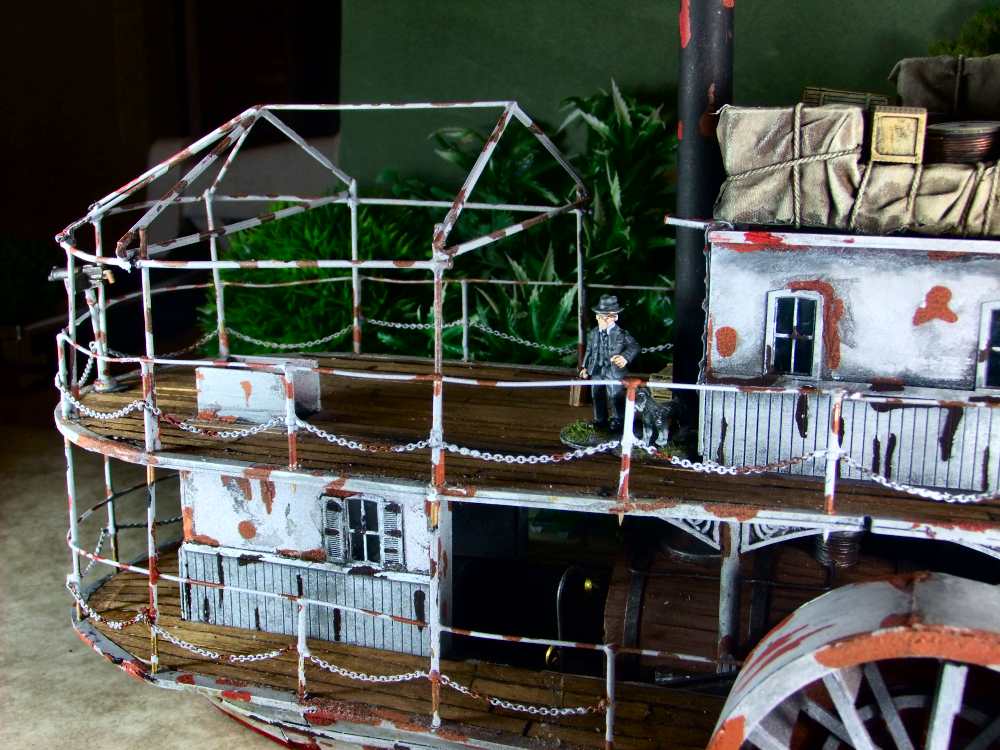

The support, painted and weathered.

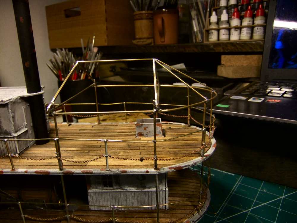

The canopy structure was made from soldered brass wire. You can here see how the handrails were made to.

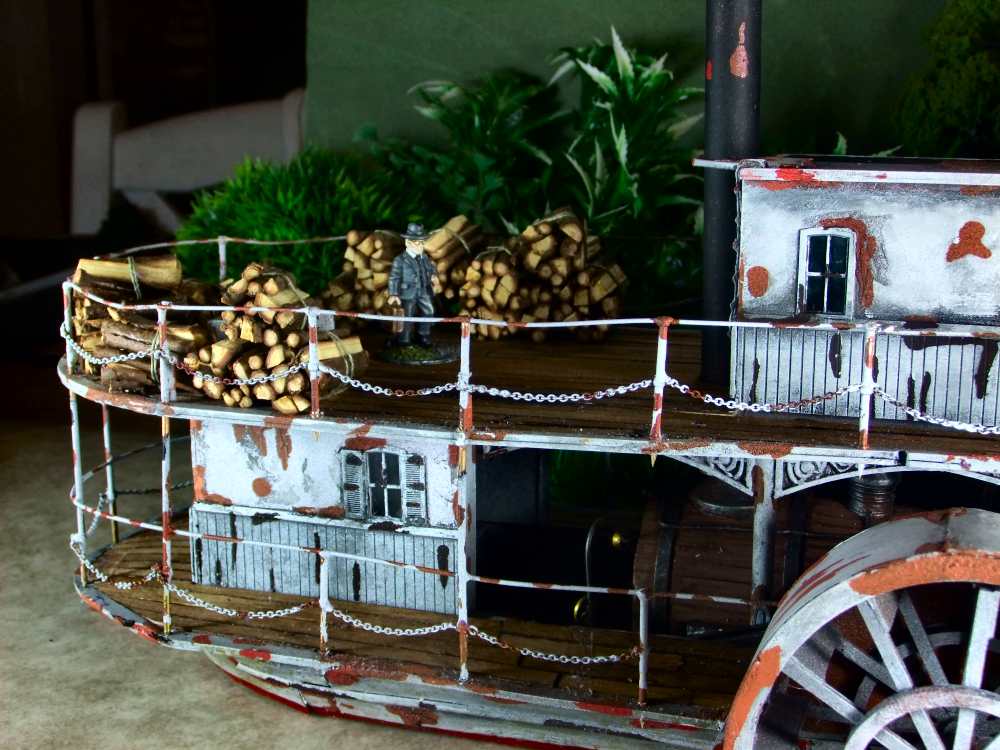

I made the canopy because 'it looks right' but I realized from the start that it is not very practical from a gaming  standpoint. It is therefore removable. Here I have loaded the deck with bundles of wood for the boiler. They will work as cover in a fire fight to.
