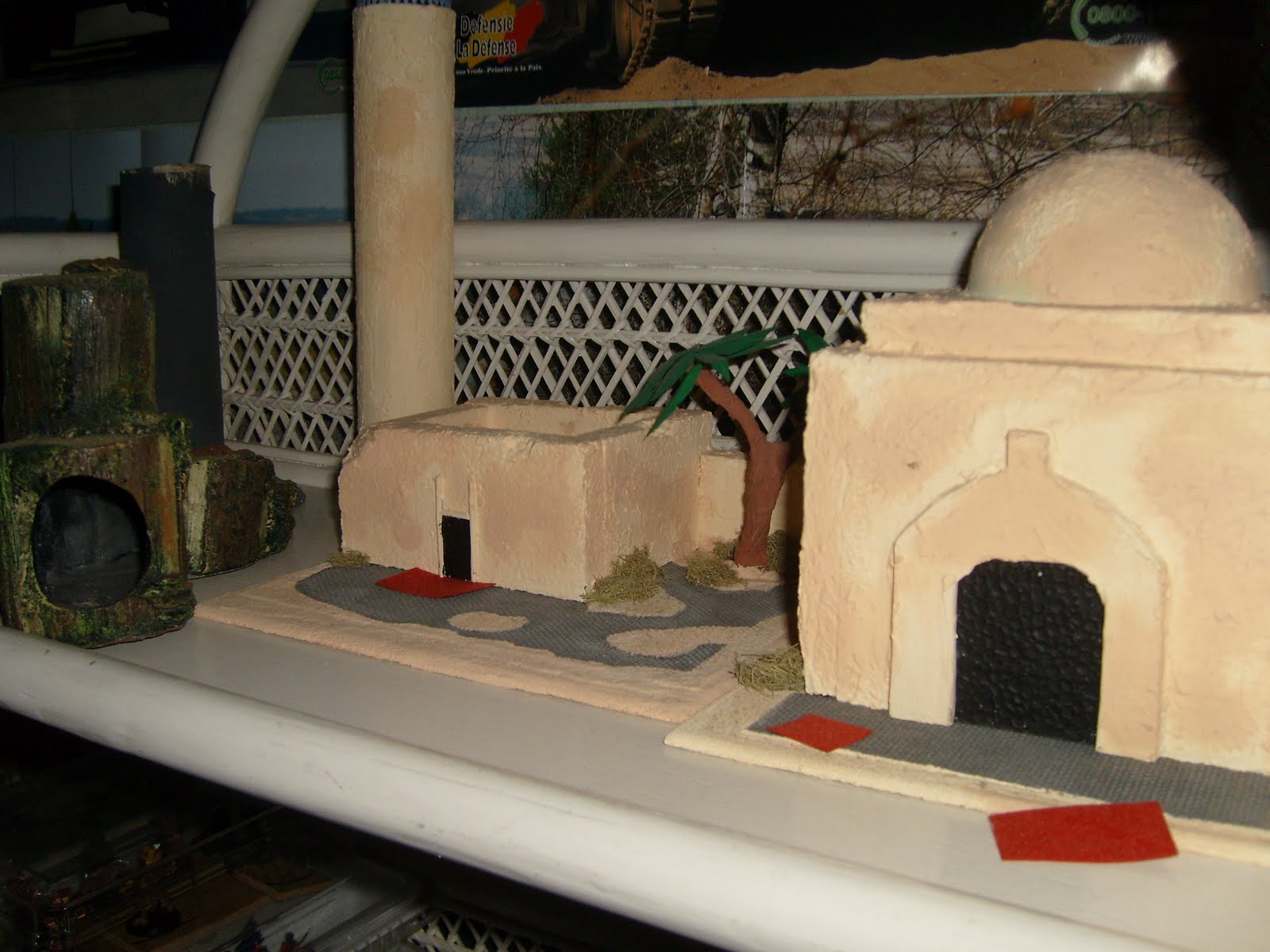

Here's a picture of some small buildings I've textured with filler.
http://1.bp.blogspot.com/_9Ty9XIdJAyg/SwlrbgF3oqI/AAAAAAAAAgU/HPmxNgt_a8o/s1600/S7303984.JPG
Hopefully he's clear enough.  :)
