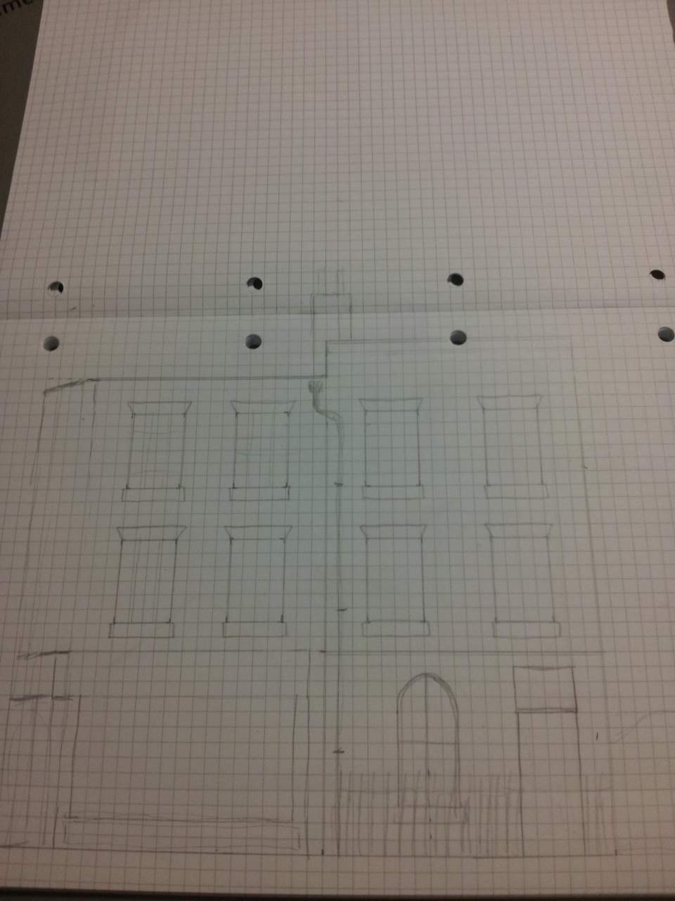

First of all I drawn up a plan of the build to see if the dimensions and measurements work and to see if it scales well with my other buildings. Nothing fancy I hasten to add! This is just the front but I also draw up similar plans for all sides of the building along with an overall plan of the layout:

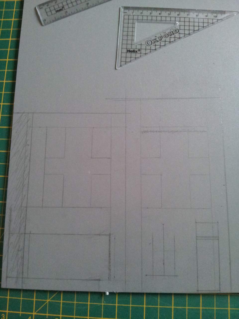

Once I'm happy with the plan the fun starts. At the moment I'm using 3mm foamed PVC for my builds. I use 3mm as it's thick enough not to warp and is easy to cut with a sharp blade:
I transfer the plan of the build onto the PVC (told you it's going to be a detailed WIP ;) ):
