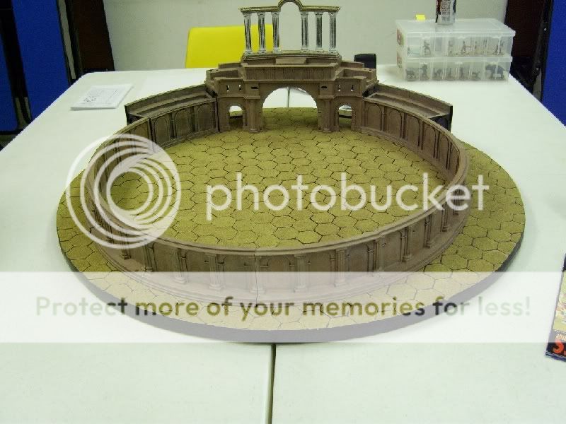

I am currently working on a Gladiator Arena but have the Gladiator Grid finished for the Arena.
The purpose or reason to have a gladiator grid is to have a bigger area to have more fights outside the arena.
The gladiator grid is also used when the Gladiator Arena is used.
Here is a picture of the Gladiator Ring that is made of Styrofoam.  First I had to cut out all the hexes for the arena so that it could be layed on the Styrofoam and pasted onto the Styrofoam.  Next, the hex pieces were painted with a Brown Sable (by Americana - acrylic) paint and then the spaces between the hexes were painted black.  After that, a Sandy sand (flock) was applied to the hexes.  Since, the Styrofoam was blue in the first place the bottom of it was painted black and the sides.  A friend of mine actually did most of the painting & the rest of the gladiator grid.  I just cut out all the hexes!
I bought a Gladiator Arena from Amazon and it looks like this.  This is how it first looked like-
I first started painting the gladiator arena with black.  It was a Krylon Fusion For Plastic
Textured spray can.  I used nearly 4 cans of the black paint!  It is the 'flat' paint and not the 'glossy' kind.
It took 2 times to make sure the Playmobil was fully sprayed on the inside and the outside.
The next step, was painting the whole Gladiator arena the color Brown Sable (by Americana - Acrylic),
and then the next step was painting the whole gladiator arena the color Country Tan (by Apple Barrel - Acrylic).
You can see the Brown Sable color on the 3rd piece going clockwise of the gladiator arena. Check this out -
As you can see the stands for the arena have been painted but seem to be dry brushed a 'lighter' touch.
I think that is what happened.   The gladiator arena as you can see I have painted Brown Sable and in this picture you should be able to see the Country tan.
And the rest of the arena has Country Tan...
Check it out -
I'm currently working on the front part of the arena where you walk in.
Currently with the Gladiator Arena , I'm painting the 3rd color for the Arena.
It is called Antique White (by Americana-Acrylic).
It makes the Arena look more sandy looking I guess.  Some say it does.

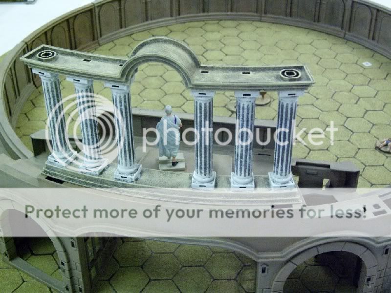

Here is a picture of the Pillars that has the 3rd color applied to it. -
