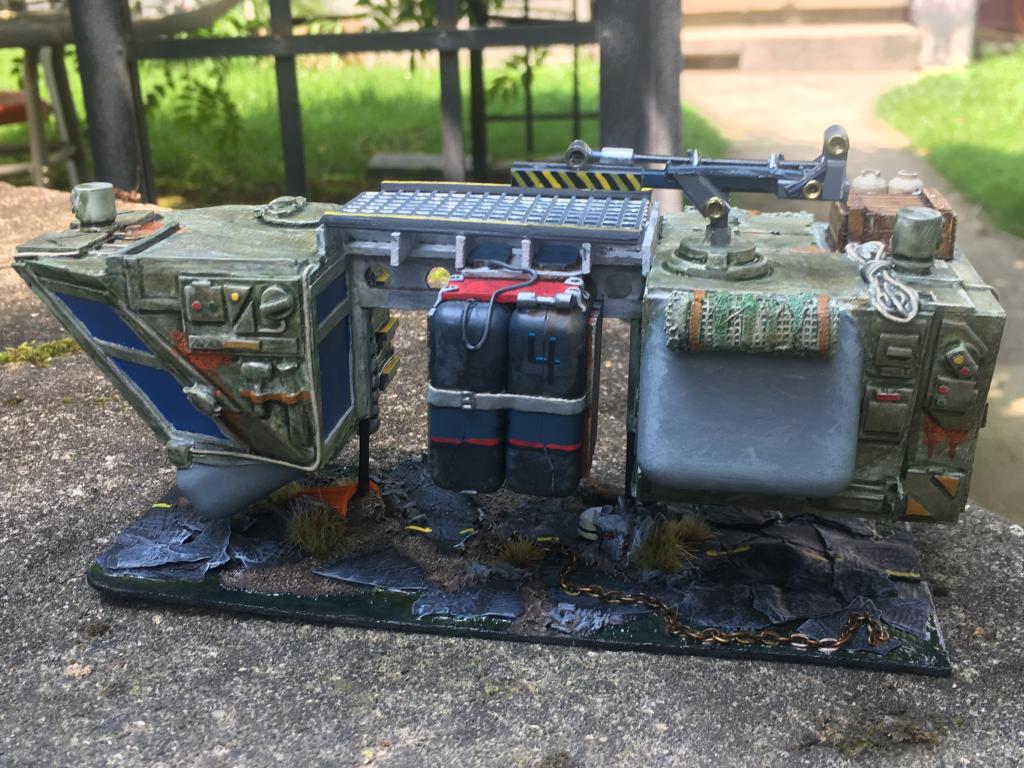

Grav Vehicle.
Hello again all,
On my Rogue 1 post I said that the interior was sawn & glued inside out.
http://castrarunis.blogspot.com/2019/07/rogue-1-for-15mm28mm.html
Well here is how the wip looks like , a huge 15mm grav vehicle.
https://castrarunis.blogspot.com/2019/07/grav-vehicle.html
Thanks for your comments.
Z

Looks good. What do you use as gap filler?
Logged
my 3d designs -
https://www.thingiverse.com/cookandrewb/designs
zrunelord
Mastermind
Posts: 1358
Re: 15/18 mm scifi Grav Vehicle
Reply #2 on:
15 July 2019, 07:38:43 PM »
Thanks Cook,
Milliput, Green stuff, White Glue, Super Glue, Plasticine & Squadron White Putty.
Depends on the situation not all of them together & what I have in hand.
On this one I used Milliput, White Glue & Super Glue
Z
