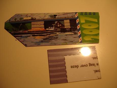

Now start by cutting out four sides for the skip (I used a sharp pair of scissors), you will not need a bottom or a top, just two sides, a front and a rear. The good thing is that if you want to make multiple skips you can just use one side as a template so you won't have to measure everything over and over again.
These obviously aren't all the parts you need, just the templates I managed to find again.
