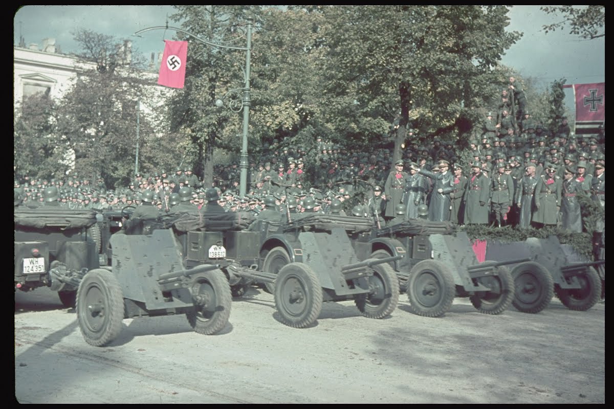

This is a colour photograph taken by Hitler's personal photographer, Hugo Jaeger, of German troops standing around waiting to parade. It's early in the war; the panzer troops are still in their big black berets, and all the equipment is still painted grey. Interestingly, there are no balkenkreuz or tactical numbers showing on any of the vehicles, but they may very well have been freshly painted specifically for the parade.
Although it's a colour photo (not a colourized black & white photo), that doesn't necessarily mean the colours are accurate. At best, we can look at elements that are in known colours to judge the colour balance and exposure of the image as a whole.
In this case, there's not a lot to choose from. The colour of the German No.1 uniform of the men on horseback is reasonably well known from existing museum pieces, and there's the skin tone of the men. To me the colour balance looks fairly good, maybe a little on the green side, which would be normal for colour film of the time, and the image as a whole is perhaps just a fraction under-exposed.

Fitz - the trucks (at least) are in the two tone 2/3 gray 1/3 brown scheme - the darker patches on the sides are the brown.  The PzIIs may be in the same scheme. Other photos from parades from the same period do show other vehicles in the two tone scheme.
Not so easy to tell but the gray-brown scheme again. The lack of contrast between the gray and brown was one of the reasons why this scheme was withdrawn.
This photo, also by Jaeger and of the same parade as the first photo show the effects of dust on the gray paint. Compare the towing vehicles to the AT guns. It's attributed to a parade in Warsaw October 1939.
Also note the difference in the red colour on the hanging banner between the two photos, taken by the same photographer on the same day in the same location and presumably using the same camera and film. Effect of the sunlight or some post processing manipulation I'm not sure.
Lots more from Jaeger here: http://wraki39.pobitwie.pl/index.php?/category/276
