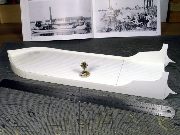

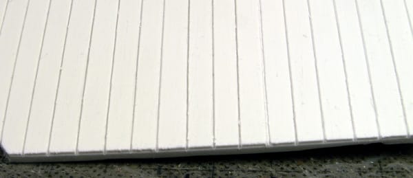

Started the hull from medium thick sheet styrene in a laminated fashion and used styrene strips as spacers between the two hull pieces. The deck piece was "wood planked": first heavily grinded with coarse abrasive paper in one direction only for the wood-like grain structure, then scribed with a scribing tool to similate the separate planks. You will see it better once painted and weathered. Side walls of the lower hull were added and thoroughly glued with liquid polystyrene cement.
The Abu Klea was a stern paddlewheeler, so on to the paddlewheel. I needed some time to think about a simple but convincing solution for that, and only a good search through the scrap arsenal discovered two old Historex 54 mm (1/32 scale) gun wheels from a french napoleonic howitzer carriage (from my very early modelling beginnings some 35+ years ago ...). Using those as a start, everything else was just working and glueing some strip-material from Evergreen.

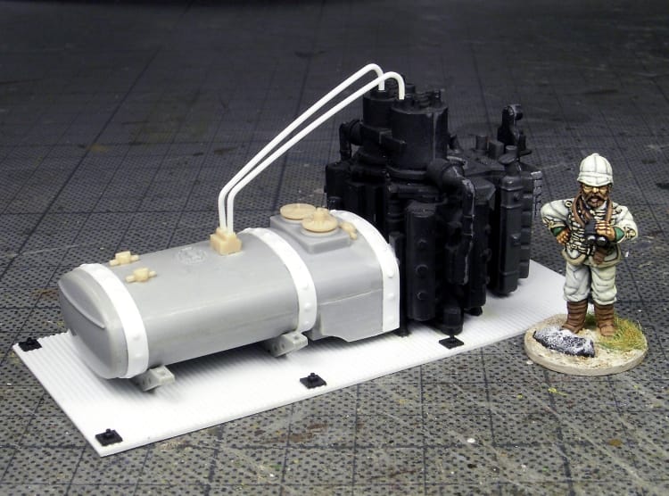

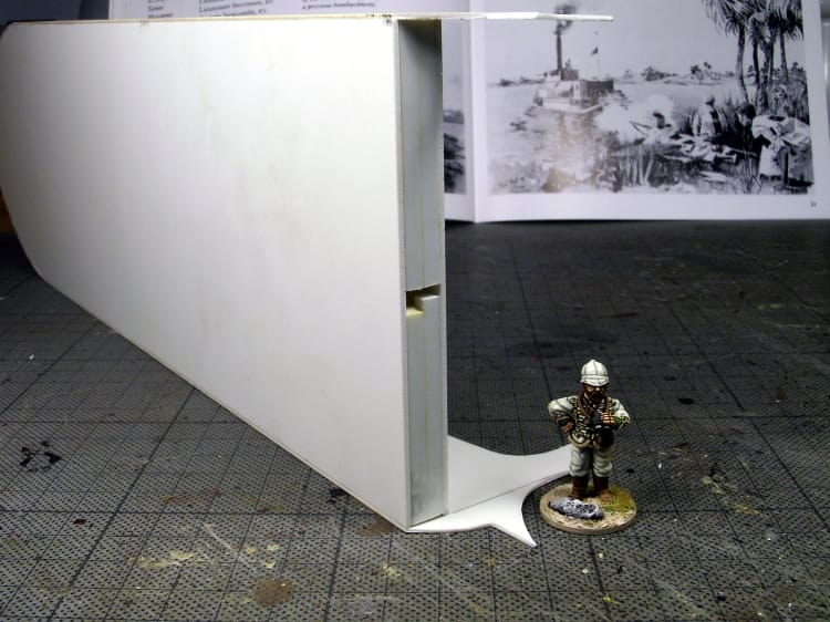

The miniature is just for comparing the size, and was painted by the great Steve Dean.
I had most fun building the boiler and engine unit for the ship. This is by no way anything which would work in the real world, just simply looking good! Parts were taken from an Airfix 1/72 scale airfield tanker and some old 1/48 scale tank engines from the early Bandai WWII range (yes indeed, ages ago I had them all collected, but after some years I decided I could make better use from some of their parts ... Ahhh, heretic!  lol

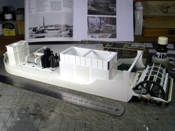

Alright, had some time over the weekend to proceed to this state of affairs:
Main deck structures have been built for the lower deck including main and front cabins, and the paddlewheel has got its sturdy frame to connect with the ship. For the basic frame I used some rectagled sprue piece from a kit; this is already right-angled and more durable than some single strips glued together. You can see the rest of the sprue on the next pic in the background. Then I added a kind of driveshaft/piston plus universal joint for the wheel drive, looking reasonably operable (I hope ...  ::))
Cabins have been constructed quite sturdy with some inner spacers to prevent warping later, and of course right-angled. I added some thicker styrene strips to the upper wall ends to get larger glueing surfaces when glueing the upper deck in place later.
Upper deck was cut from 3 mm sheet styrene and a wooden structure and planks were engraved with abrasive paper and a styrene groove cutter.

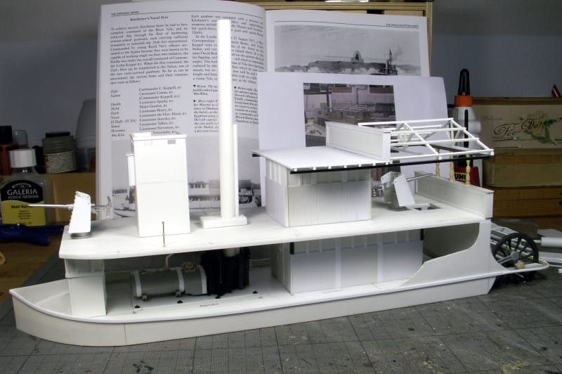

Some hours working time on the ship yesterday, now she is looking more and more like a gunboat. Main components are finished now, deck houses glued onto the decks, sun roof construction above the upper deck finished (- and being the most fiddly job of this project). Here she is:
Here's a shot of the sun roof. The biggest difficulty was to construct the main (dark grey) support beams as the deck house and it's roof where glued together already, so everything was free floating and I had to construct a kind of jig to fix the beams together firmly. The three wooden supports are a bit of artistic liberty as the original ship had another small deckhouse there, but my version is slightly shrinked, so no room for another house ...

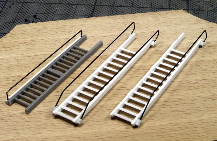

I built some ladders from Evergreen stuff and a railroad fence set, hand rails were added from stiff steel wire:

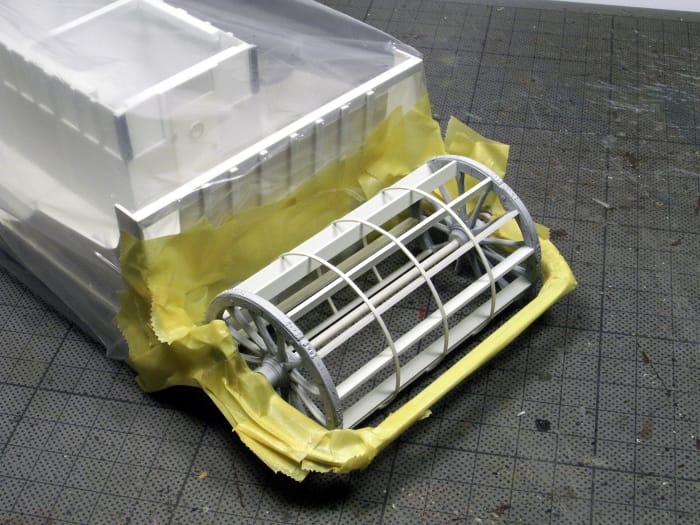

Then the lower deck was put into a plastic bag to save from overspray, and all parts around the paddle wheel were seriously masked with Tamiya tape. It would be the easiest way to paint the wheel black with my airbrush, using a brush would be nearly impossible or very time-consuming ...
Painting has started now, and airbrushing the wheel cost me ten minutes for a nice even coat. I repainted the main white structures with a slightly off-white enamel from Model Master, and used a wood tone from Humbrol as basic colour for the three decks. That was a bit tedious especially when painting around the rail posts and under the sun deck area. Slightly thinned enamels were used as they tend to flow better than Acrylics into any recesses like the wood grain on the decks. I will continue to use inks for washes and acrylics for the details. But as I said, no more progress shots of the ship till after the competition, maybe the one or other pic from detail painting.

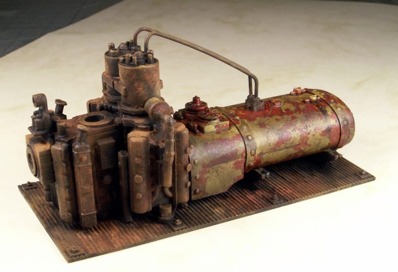

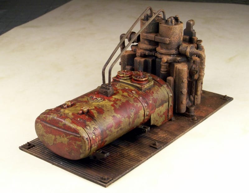

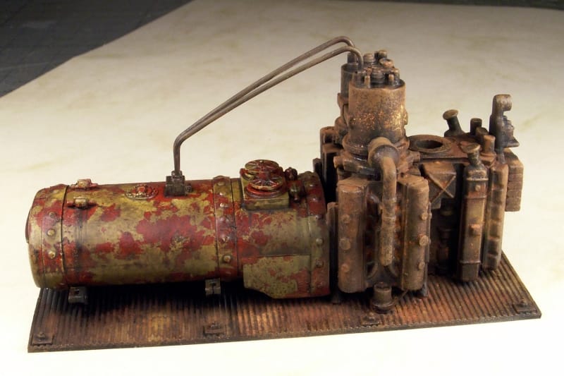

Fresh from the workbench - I finished painting and weathering the boiler and machinery:
This boiler has indeed seen better days! The former redish paint is barely seen, and the rest is a heap of rust. But the old engine is working as reliable as ever, that's what I've heard from the Captain at least!
It was a real lot of fun to practise some of the techniques I've learned from the masters of railroading craftsman: rubber cement masking to get old paint layers, pastel and alcohol treatments and pure pastel rust finishing.
