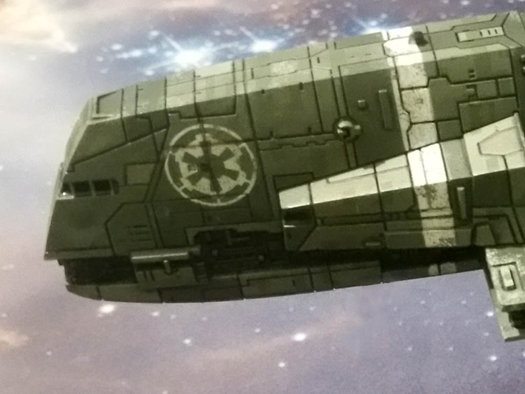

I am looking for a custom print job because I need to print WHITE onto clear backing. No, I can't use white decal paper because the shapes I need in white are too complex to cut out.
I'd still try the white paper...
I used white decal paper to make the below Imperial Logo*. I simply printed a very thin outline of the logo and cut that out with a small margin on the outside. the inside 'open' parts I left untouched. I applied the transfer and then painted outside of the lines in the same colour I used on the background.
Of course I first put a coat of varnish over the transfer first. What I did though, is use a matt varnish as opposed to the glossy varnish I previously used (and is recommended. I think the result is better, as there is not even a trace of glossiness now, something I battled before, as no matter how many coats of matt went over it, some shine always remained).
I later realized that if I had proxied the background colour on the transfer already, the overpainting would have been even easier (especially in the  smallest corners)...
