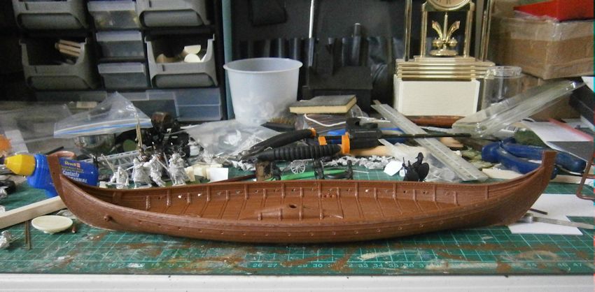

I "waterlined" a boat once using sand. Flat area of sand, sit the boat in it, (just the hull) and then spray painted what was sticking out of the sand. left a nice unpainted area under the sand which then got removed.  :)

I like it simple and quick.A quick spray around the edge,then a rough saw through the hull,and sand paper down to the paint line,Job done.This method also allows you to play with the pitch,and roll angles of the hull without cutting.Changing these from a dead level deck give's a model a bit of a movement and a bit of story telling.With out it a boat is just a pritty hill on your table.

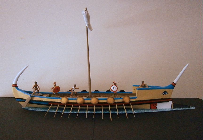

I used this same model as the basis to make the ship you see below.
I sanded the keel off, down to the actual hull. I then added a plasticard base & topped the base with a bunch of artists impasto medium (you could add a lot more under the hull). It isn't quite waterline but for this conversion the prow helps to create the illusion.
