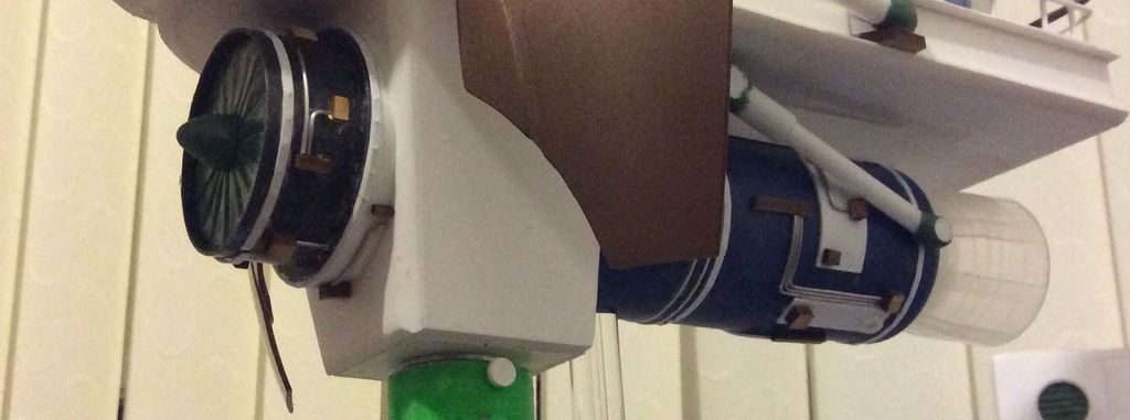

Depends what kind of look you’re going for? I used Green Stuff to this airplane style turbine..
...or this, for a Sci Fi bar...

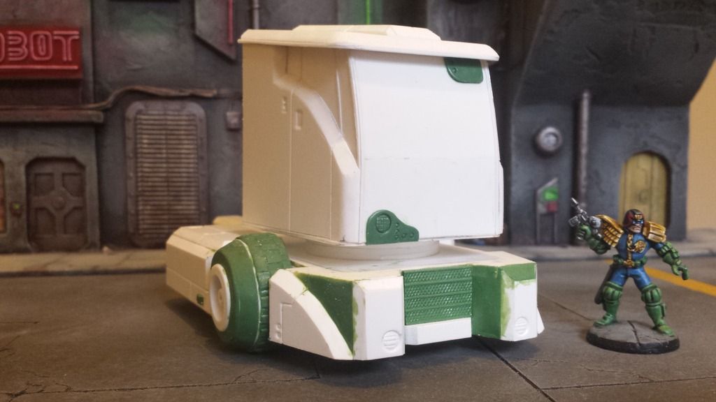

......or I used a flattened piece of GS and rolled my sculpting tool(which has a cool pattern on the grip) across it. Once it dried I cut it square to fit in front of this truck....
The other thing, as Daothar says, is plastic card cut and glued in slats.
This last one was corrugated card, which once cut and bordered with thicker card looked half decent....

Wow, Andy; that truck is awesome! 8)
Did you ever finish it? Regardless, that's some grade A plasticardjitsu!

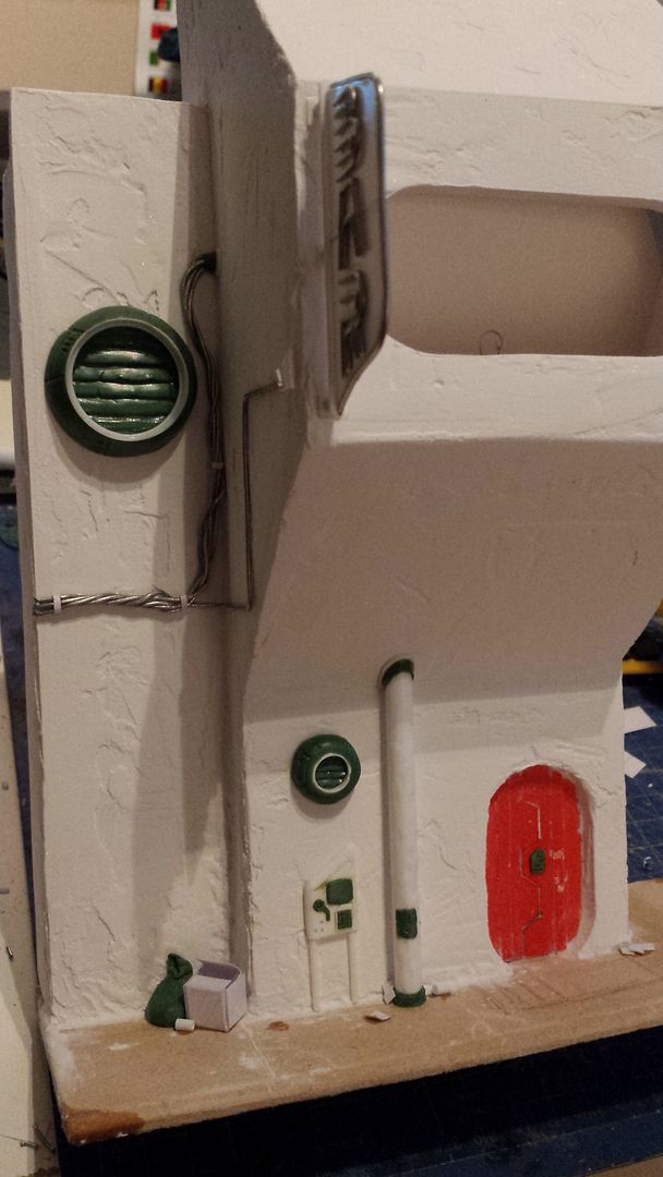

I used scrapbook window things. Cut off the wings, glue in some screen, and done. I didn't even paint them, but I wanted the steel grey look anyway.
I glued mine to a hardboard piece since I needed to be able to move them around for a sci-fi corridor system.
Its still languishing in a box somewhere. I was always planning to see if I can cast it so I could've made loads of trucks for my 2000ad project, then I found the cheap Poundland toys.
