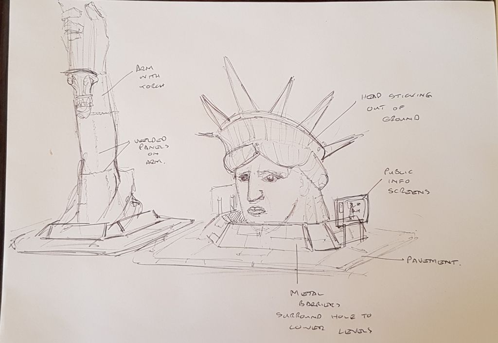

I’ve had this idea since I first started my 2000ad thread. In one of the comics, to keep it safe, the Statue of Liberty was moved downtown. The idea wasn’t the greatest(maybe even I’ll-advised, some might say! ;)), as they built other buildings/levels up all around about it, basically hiding most of it from view. I thought this might make an nice scenery piece, kinda implying there’s more beneath the surface of my board when just the head and lamp stick out above the ground.
Here’s a crappy sketch, roughly showing what’s going to be sticking out...

So the plan....I’m planning on building two pieces. One bit is the arm and torch and the other bit the head. This is supposed to represent the Statue poking up through from the lower level.

And here is a sketched plan of (hopefully) the final result...

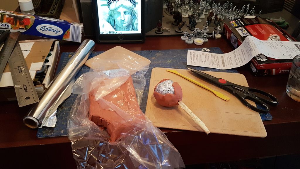

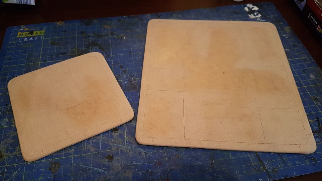

So I’ve decided to go the air-drying clay route. In art class (God! About 25 years ago!) we did sculptures of faces. As far as I can remember, we did it this way.
So, to start with, I’ve made two hardwood bases. This is the same technique I use for all my building bases on my 2000ad board.
I got the technique from this tutorial years ago...
http://leadadventureforum.com/index.php?topic=26860.0
He uses MDF but hardboard works just as well. Basically lines are cut using a knife opened up (in my case using a pointed sculpting tool) then sanded. I’ve also rounded off the edges and corners using a knife and sandpaper too.

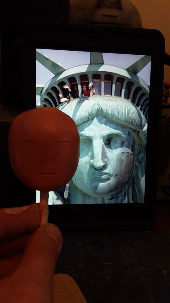

Next, I’ve taken tinfoil. My idea is to make a kinda former, something to give me a very rough shape, then sculpt on it. The tinfoil was made into a ball, I’ve jammed some wooden sticks in there to give me something to hold on to, then I’ve covered it in the air drying clay.
I’ve smoothed that off, made some markings where the eyes, nose and mouth will be, then I’ll need to leave that on top of my radiator in the house to dry over night.
The arm was done just the same only with a sausage of tinfoil covering a longer stick.
