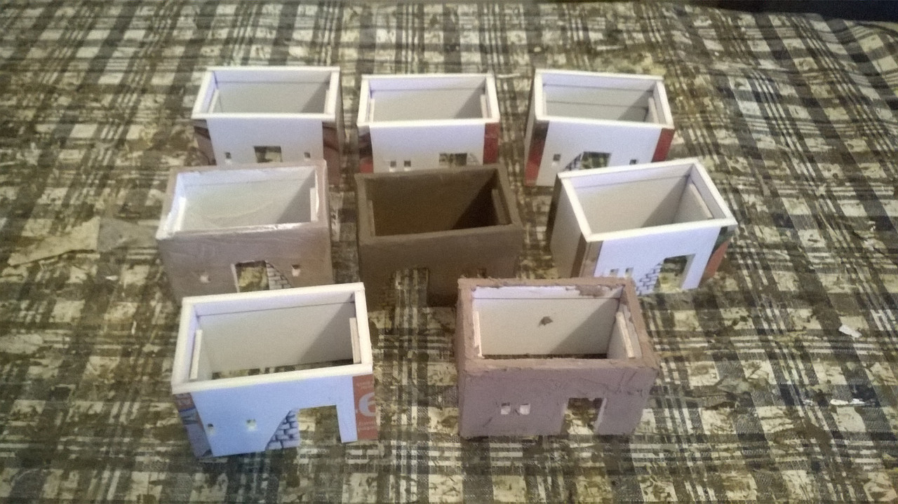

Some construction questions -
Would you be willing to talk a bit on construction?  Looking at your pics, including older ones, it looks to me anyway that some are built with balsa wood walls, some may be wood framing with slats or balsa attached, possibly foam core with wood attached, and haven't a clue on your  adobe buildings.
Do you have a standard "go to" method you use for all?
If not, how do you decide which to use for which type of buildings?
Do you try to make them all with removable roofs?
Do you ever do bases for structures, or are they all just the building on its own?
Any "lightbulb" AHA! moments when you discovered some particular thing to do (or not do) you might pass along?
And finally, where do you find your miniature carpenters to do that lovely construction?
Thanks!
Offline tinned fruit
  • Posts: 80
Re: Building a Wild West Town - Purgatory nears completion (update 22/02/22)
« Reply #46 on: February 24, 2022, 10:27:48 AM »
Hi Terrement
The wooden building are made from 5mm thick balsa and are braced at the corners for added srength though as the buildings are based this might be a bit of overkil on the single storeys. I use mdf laser cuts for the windows and railings.
The adobe structures are 5mm foamcore covered with paint mixed with filler/ spackle - the corners are covered with PVA and newspaper to hide the joins. I did a "how to" in WSS 115.
The "how to" comes straight from Gary's articles plus trial and error which plays a big part. The original articles have some great inspirational photos - I wanted Silverado rather than Deadwood hence the more colourful store fronts.
All the buidings have removable roofs, and the two storeys removable first floors, out of habit but I personally rarely put figures inside.
I've decided to base these as it gives added strength plus it gives you the option of adding little details but it limits their flexibiity in gaming. I constantly debate which is better especialy if your game multiple periods and don't have an unliited space and budget.
The Aha would be get stuck in. You'll make mistakes. Things willl not be perfect but very rarely will the project be ruined.
Hope that helps.
Phil

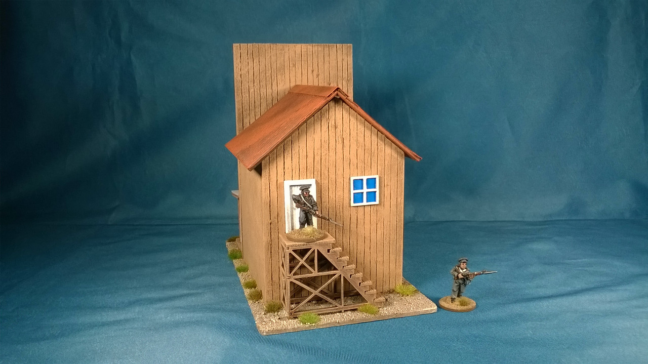

With the addition of the "Palace" Saloon for Purgatory  - the Anglo part of town is complete for the moment.
Yes - I remembered to include the Church!
The mdf stairs finally arrived for the Saloon
Although I will add some fields and a gold mine in the future.
Next up I'll be using the fruits of "Take your daughter to work" day to make the Mexican quarter of San Miguel...
More pictures on my FB page - https://www.facebook.com/tinnedfruit/
Thanks for looking.
Phil
