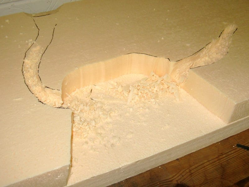

Have done a little more carving. Or should that be caving.
I've decided this project is going to be a leisurely build - I'm not going to tear into it like I usually do. But take my time to think everything through...
Well, we'll see  ;)
I’ve now added the lower deep cavern (Doom! Doom!) with cave passages running down to it.
The only way to chase out the slopes down into the lower cavern is using a very sharp blade – the hot wire cutter can’t get into that angle. You just have to slice repeatedly into the styrofoam with the knife in a criss-cross pattern, and then hoik out the unwanted material to form the approximate contour of the path.
It’s messy, but at least the spoil is in bits – and not styrofoam dust, which is what you’d get if you tried to sand it.
That said, having carved out the basic shape of the descents, I did use my trusty Dremel with a sanding bit to smooth down the resultant pathways and cave walls - making sure that the gradient was okay for figures to stand up on.
(When I ‘ice’ the interior surfaces with wall filler, I will give these descending pathways a slightly stepped finish, to make sure the passageway floor is level enough for figures).
Here’s the lower cavern with the upper caves level on top. (Don’t ask why there’s a tunnel entrance halfway up the cavern wall – I haven’t decided what to do with it yet. It might be a drop to nowhere to catch the unwary. Or I might install a rope bridge across the cavern… )
You can see I’ve also added some smaller tunnels connecting some of the larger caves.
The basic rule within the cave system will be: If a figure can fit through a tunnel or gap, then it can travel down it. If it can’t – it can’t. So while the large neanderthals and any predators of any size will not be able to fit down the narrow tunnels - nor will the bigger cavemen. They will have to stick to the main caves.
And whilst the cave women and children will be small enough to pass the smaller tunnels – so will shorter hostiles like apes and wolves… :D
Interesting huh?  ;)
The large cavern will have a small, dark pool in the centre, as marked.
To achieve this, I will slap several coats of PVA onto the surface of the foam to form a smooth shiny base for the water to be painted on and then varnished. I will then build up the rest of the ground slightly around the pool to give it a sense of depth.
The alternative would be to actually hollow out a pool and then fill it with resin to form the water. But why go to the trouble when still water is a smooth flat surface, and there’s already a ready-made smooth flat surface right there?
Here's the whole cave system stack.
I need to now do a bit more titivation to shape the entrances and walls to the caves and tunnels a bit more, and hollow out the passageway floors slighty.
Then the whole lot gets fixed together into one massif, using wood glue and cocktail sticks. Possibly cut-down bamboo barbecue skewers actually, to go through that lot.
Then we can get onto the more artistic stuff  :)
