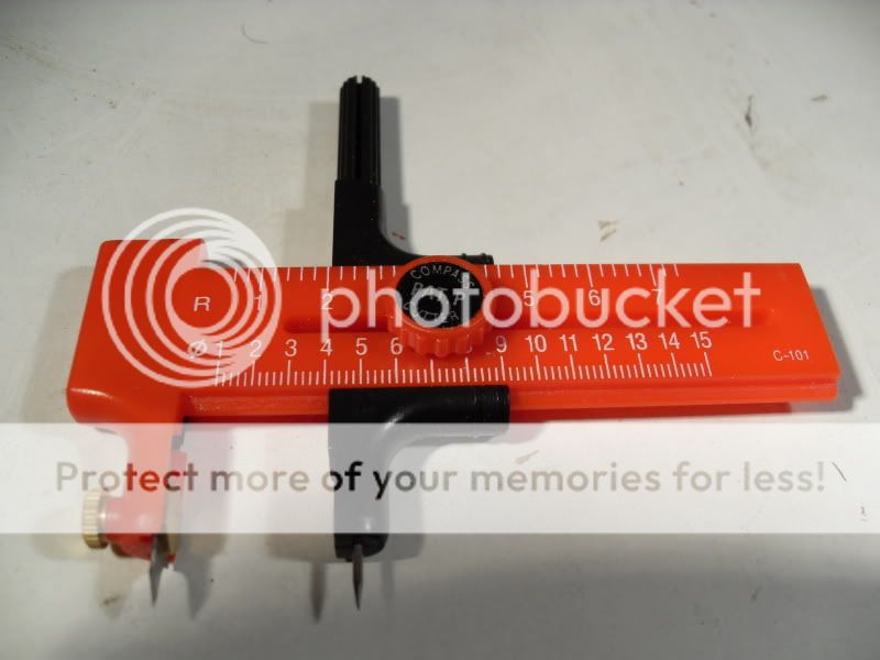

I use a compass cutter.  Not sure how small it will go down to but I have used it for 25mm and 20mm bases.  I have used it for inserts on 30mm bases such as your example.
20mm Example
25mm Example
Just google "Compass Cutter" or try Ebay - where I bought mine.  LINK
To get the exact measurement each time I use some paper and cut a template, adjusting until exact.  Once the template fits the base I want perfectly, I then cut the plasticard.
Compass cutters are very cheap to buy.

Thanks Orctrader, that's exactly what I'm looking for!

Like Orctrader mentioned. If you live in the US, hit a Joann's, AC Moore or a Michael's and look in the back with the cutters. They carry the Olfa brand compass cutters. Always remember the coupons.

I got this hole cutter from hobycraft. Good for thin card and plastic card.

That's very similar to the one I just ordered off ebay. I went through Hobbycraft yesterday looking for something along those lines but found nothing. What's the betting next time I go in I find several types straight away?
