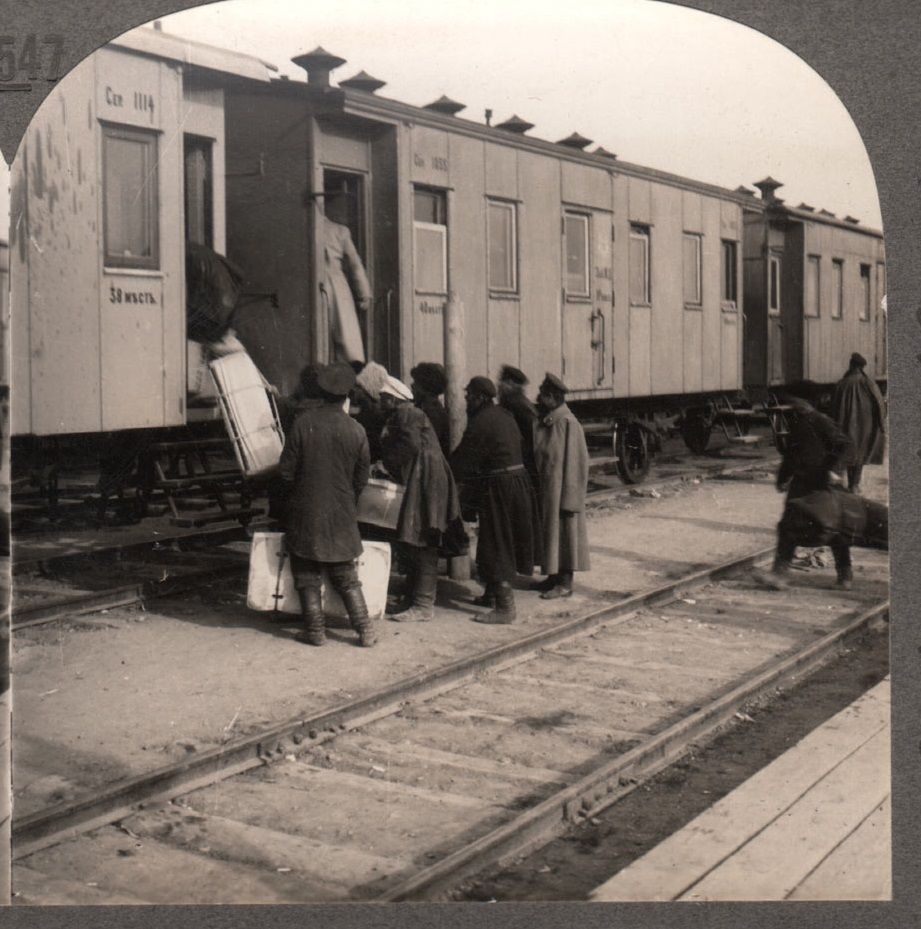

I have to say I'm somewhat in the same boat as you. I got the PP RCW armoured train and some Wild West railroad wagons, together with some TT track. Both the TransSiberian and TransCaspian railways used flat bottomed rail and lots of sleeper/ties almost directly onto a flattened ground with little or no ballast. You can see it here in this old photo...

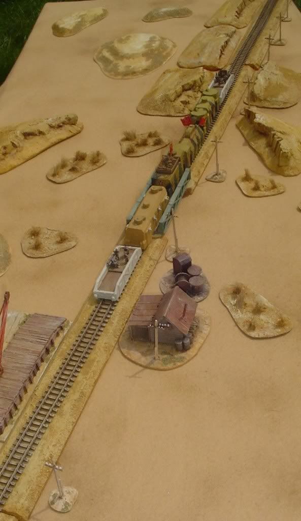

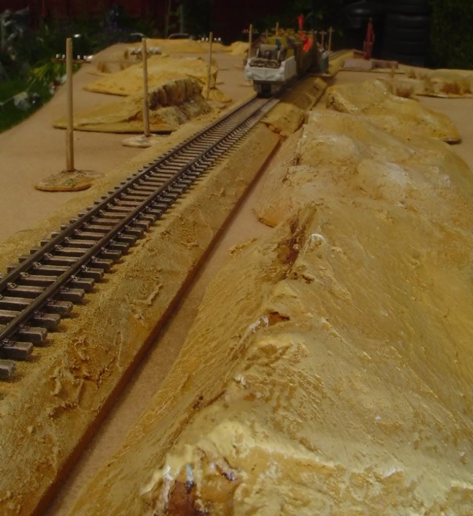

If you want to keep it simple and are more of a wargamer than a railroader, you could use the TT flexi track as is... I've also tried creating a straight raised trackbed onto which I laid the TT track which at least allows for the possibility of also modelling bridges...

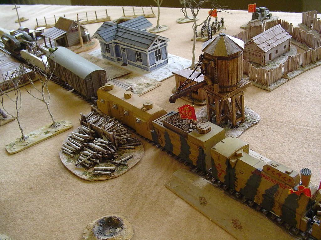

And even reusing some ditch/dyke sections I'd modelled onto hardboard with expanded poly and polyfilla as a trackbed...

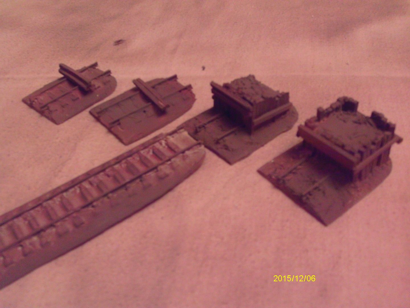

However, if you want to model curves, points etc., rather than just an on-off straight track, you're going to need to cut up the flexible TT track into manageable sections. You end up with a toy train set assortment of curves etc. And for the greatest flexibility you need to be consistent with track lengths and geometry. TSS also make pretty good resin railway sections, and being resin they come with a base and slightly raised trackbed premodelled...
http://totalsystemscenic.com/product-category/resin-buildings-walls-scenics/resin-by-range-railway/
I started down the cheapskate road and tried cutting down some 00 track my father had left over to TT gauge. That involved cutting down the length of the track on one side next to the chairs, cutting the sleepers down and gluing onto a sturdy base. The joins were camouflaged by liberal applications of polyfilla and dressing with fine sand/gravel. It also works making curves. You have to be a bit clever with the sleeper spacings which requires cutting the plastic ties underneath the rails. You can see the w.i.p. version here...
I even attempted doing the same to some points making static models, but to be perfectly honest you are far better buying those pre made for all the hassle involved. Plus the radius of curve TSS uses is far more wargaming friendly.
