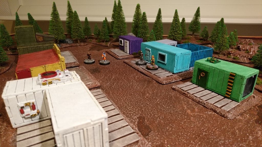

I base my 15mm buildings on 2mm plasticard. I score and snap suitable large pieces of plasticard, then cut away sharp edges and bevel the sides before sanding and painting:
