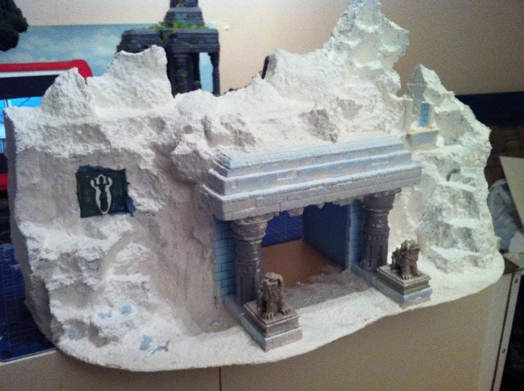

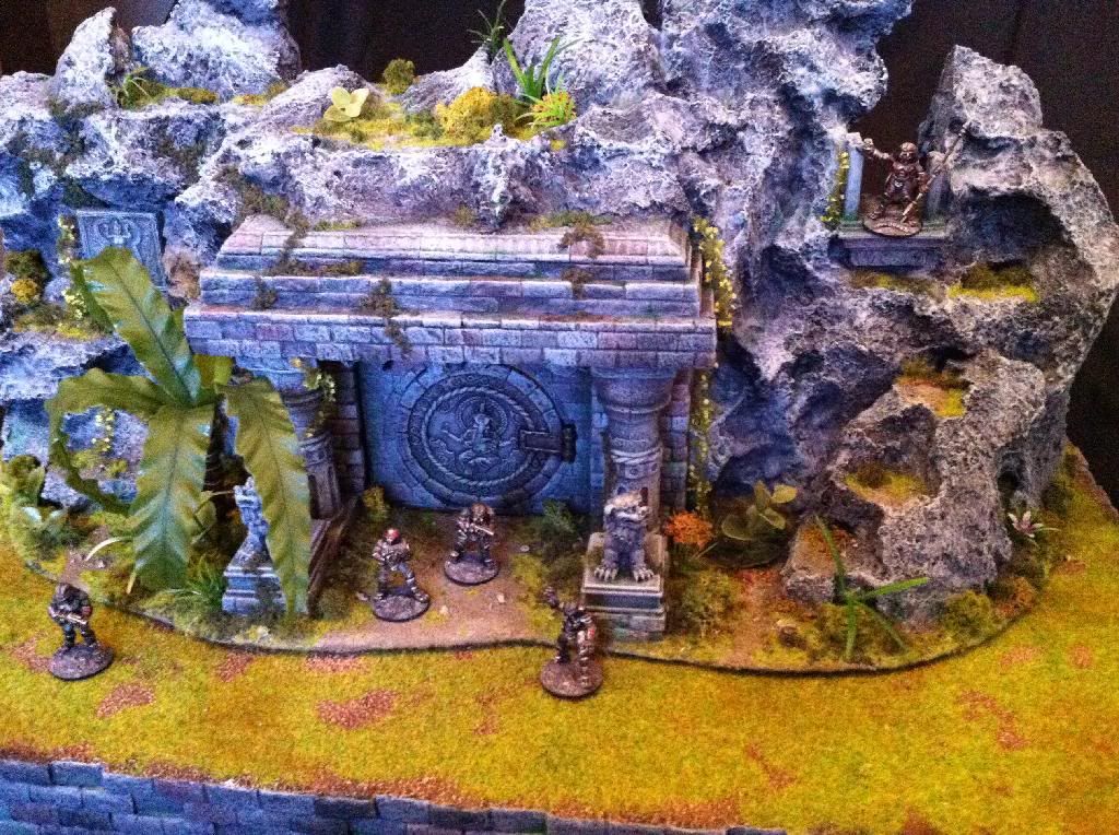

I found this website a while ago. It seems our model train colleagues have it right when it comes to hills!
http://members.westnet.com.au/mjbd/html/body_foam_rocks_-_frocks.html
My brother and myself used these tutorials to make these.....
...and I used it for this....

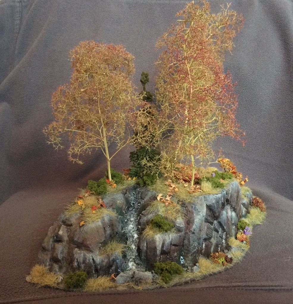

The main problem is having a hill that's usable in a game as accurate goundscales don't translate well for gaming.
I've done one new one for now but I do have plenty more planned. I've kept it low but with a rock feature at the 'front' so it doesn't become too large. Figures can pretty much be placed anywhere apart from the steepest slopes. It does for different scales as well (just about).
It's about 300mm across it's longest length and is normal blue/yellow/pink foam carved to the shape with a bit of filler to smooth it before painting the soil and then adding the growies.

Very nice sir.
Out of interest Oshiro, how many different types of flock did you use on it?
@Andym - Thanks for sharing matey, they look great and I'm sure the how2 will be useful.

About four and some of the grass was drybrushed varying tones as well.

I think its the range of textures and colours that brings it to life.
