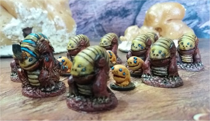

Hello again all,
Here they are all painted up..... "Smile & wave boys Smile & wave" .... Thank you for your comments. Z

Thanks guys, glad you like them.
I think yellow does suit them well ....
WM the pipe came out by chance , I was stretching sprue on a candle & the last bit turned out like that.
Would have been a pity to throw it away . ;)
