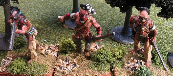

My choice is a Red Brown basecoat (I use Ral Partha/Iron Wind "Red Brown").  Then I dry brush an ordinary ruddy flesh over it.  My flesh of choice right now is just ordinary Delta Ceramcoat "craft paint" flesh tone.  I then do a black wash over it all...
Here's a pic...
Mike
