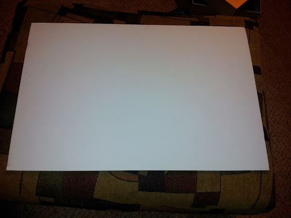

I bought a foam project board with a cardstock surface on top and bottom from Hobby Lobby.

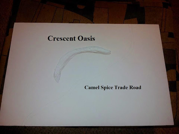

I then cut out a crescent shaped oasis and marked off a road. In retrospect I made the road way too big for my 1/600 forces that will use the board.

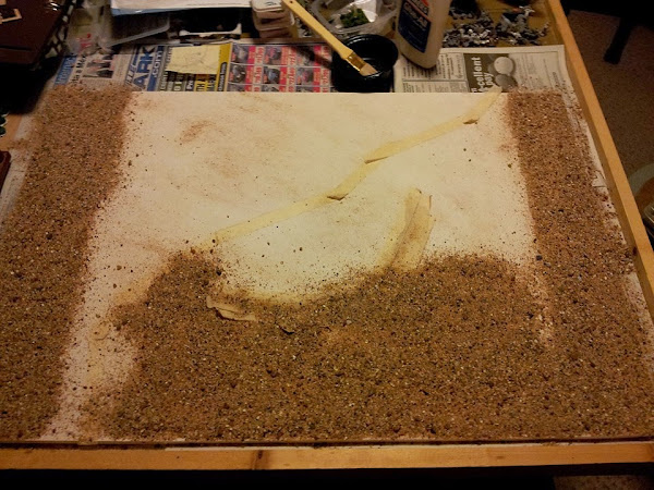

I then started adding flock, which was a mix of construction sand, hobby craft colored sand and home-crafted colored sawdust.

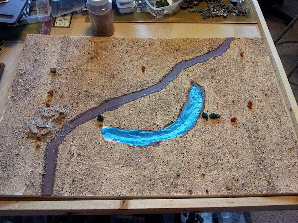

After drying overnight I discover the board has warped. However I pressed on and started painting the road and oasis while adding some permanent features like the scrubs and cardboard rock outcrops.

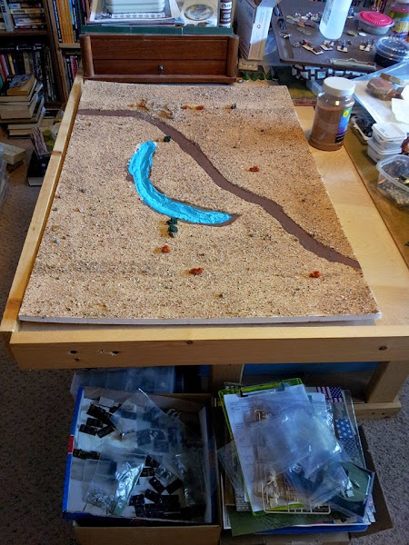

The warp can be seen in this picture.
Now I have stopped working on it and am tempted to throw it out and start over. So I was hoping some of you might share what you've done for your own desert style boards. My current thoughts are to acquire a new board. Paint it vice using glue and then sprinkle some areas with a mix of flock but not covering the entire surface, thoughts?  If I use paint to cover the surface vice flock will the board still warp?

Three things I would do...
1. Mount it all on a wooden base board at least 6mm thick
2. Paint both underside and topside of base board
3. Glue your foam base board to this
Hardboard always warps on big pieces - you can mitigate against this by painting both sides

For future reference, at that scale I'd use kiln dried sand, construction sand is a bit coarse and lumpy for small scale work. Mix in some limestone chippings or similar for texture. My boards are either backed in wood or on thick (min 25mm) foam to prevent warping.
If you want to recover the board you are working on, pva some newspaper to the underside. As the glue dries it will shrink and the paper should pull the board flat again. Won't work on really big things but foam core like yours should be absolutely fine.
