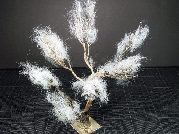

Some more work and pics since my last update. After using rubberised horsehair for the first trees I changed over to a synthetic material called filterwool, usually used as a filter-material in pond pumps.
I had to buy this very large bag as smaller ones were not in stock, so I'm able to plant the siberian forests in 28 mm now ... If anybody would like to get something of this stuff, I'm happy to part with it if you paypal me for the postage costs.
Next two pics show some trees with the new fibres already in place and then airbrushed dark green.

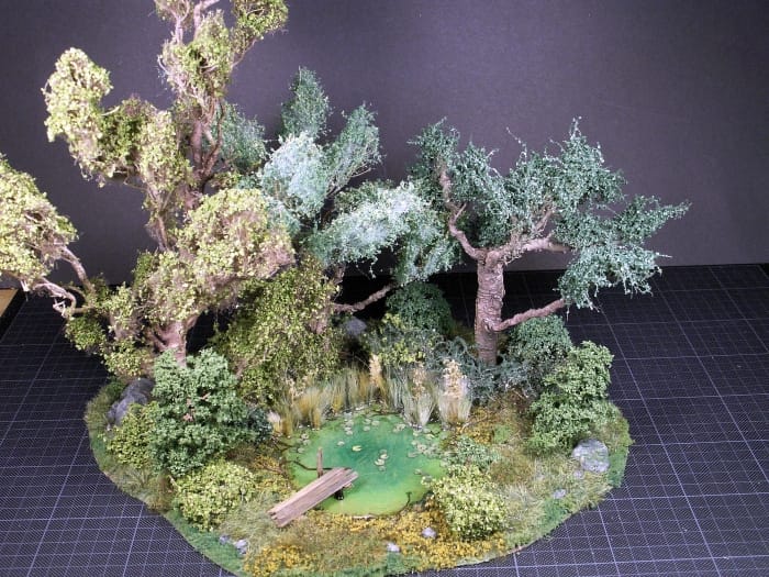

And this is the large finished forest piece with the pond I started this topic with:

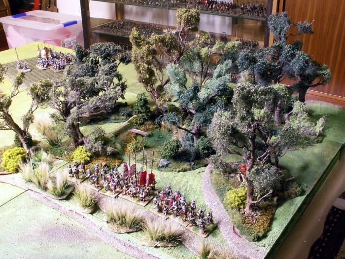

So, here we are again! As promised, some pics of the completed wood in action for our upcoming Thirty Years War game at the TACTICA. I will get lots of pics there of the game and table, but they will probably be published in a new thread at the Swashbuckling Board. This thread is now finished, so if you like, Hammers, you can make it sticky ...
