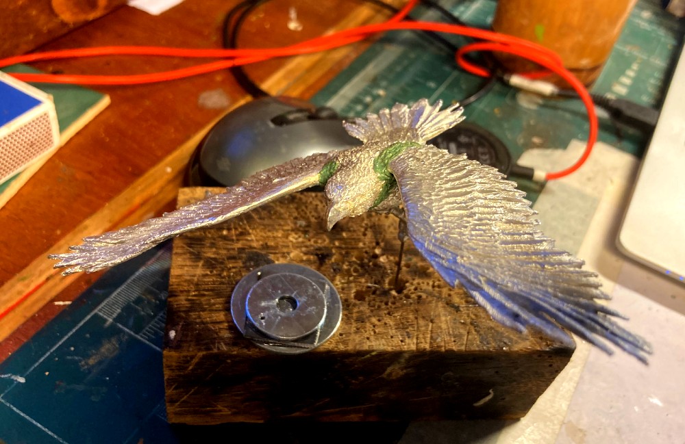

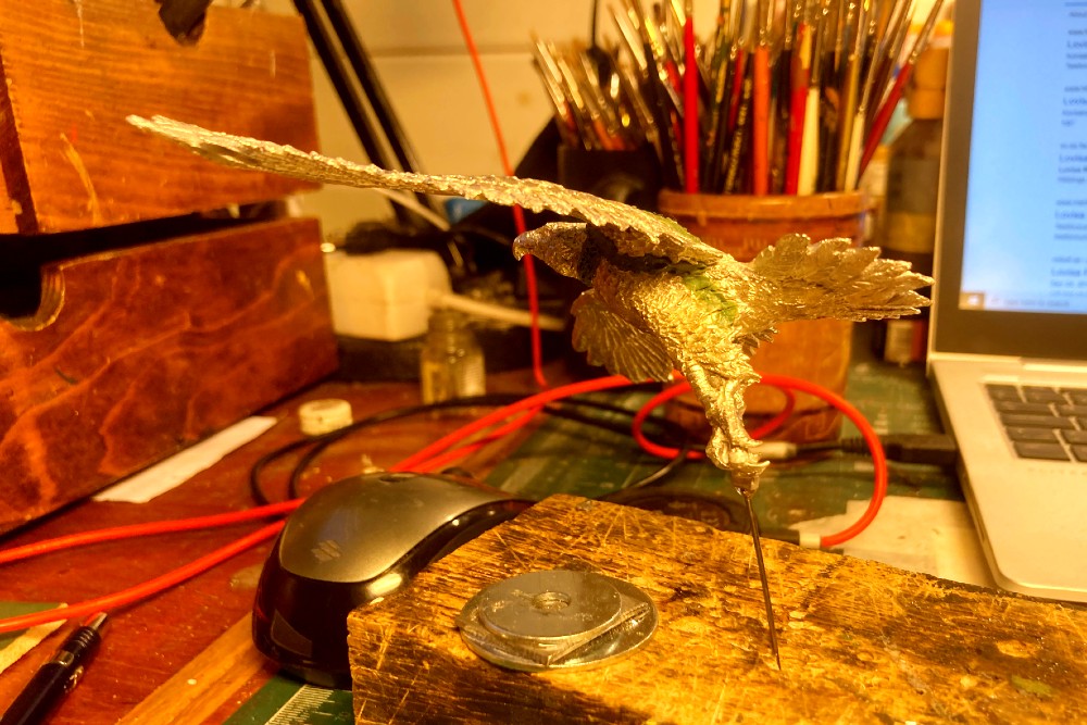

During the Black Friday sale past, I purchased a set of great eagles from GameZone Miniatures which I've had my eyes om for quite a while. As it often is with this company, the miniatures are excellently dynamic. They are however difficult to pin and glue (they are metal after all) and basing these while leaving that sense of swiftness and movement is a challenge.
Do any of you have experience from basing complicated miniatures and have a few tips to share?

I should add that I have made some succesful experiments with adding sheet lead to the bases which works fine with those models which are not much off centre above the base, but what makes s few of these eagles interesting to look at is that just the fact that they are off balance!

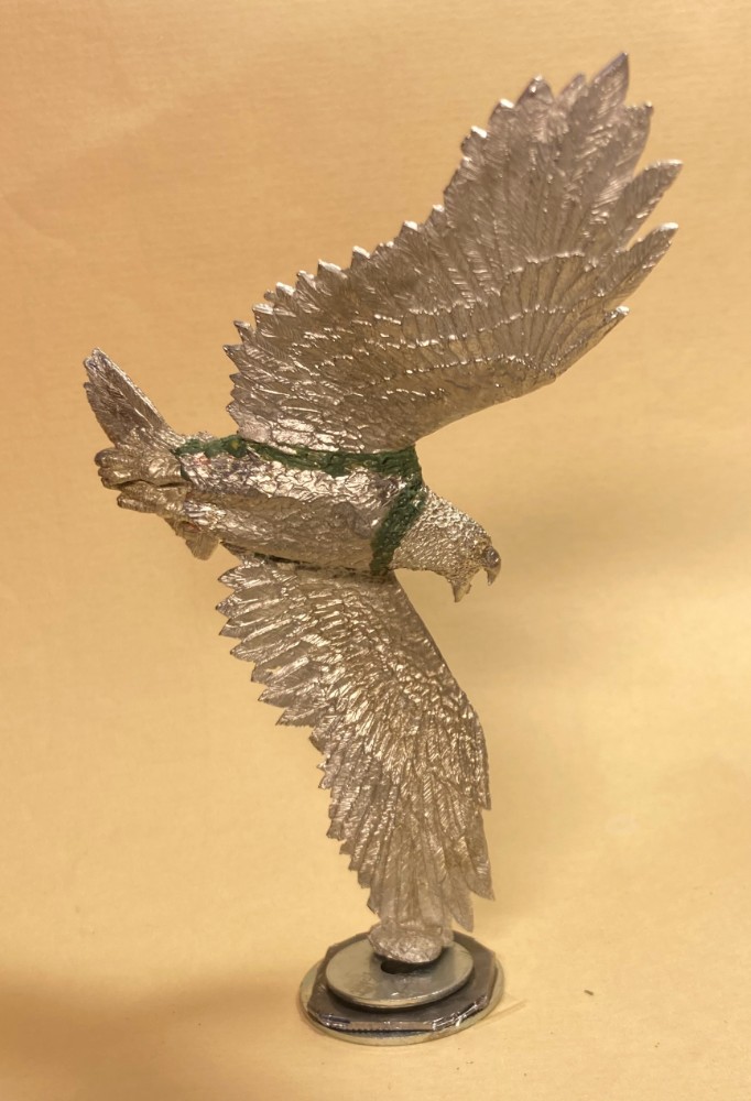

« Reply #5 on: 29 January 2021, 12:00:11 PM »
THis second Eagle is balanced quite well, it's left wing sweeping the ground just below the point of gravity. This means it stands quite robustly even on a 35mm base. That's quite a clever bit of sculpting on the artists part, that is.
