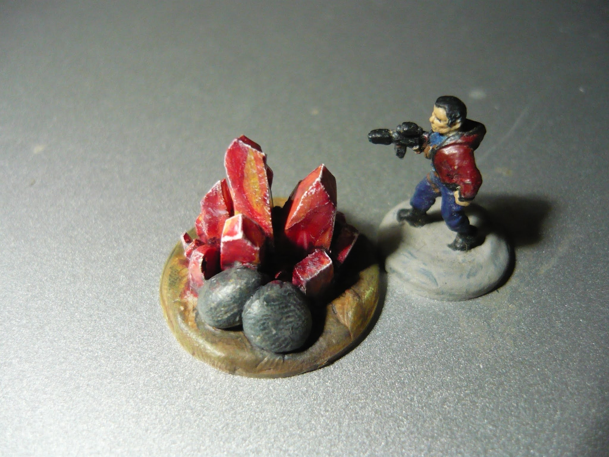

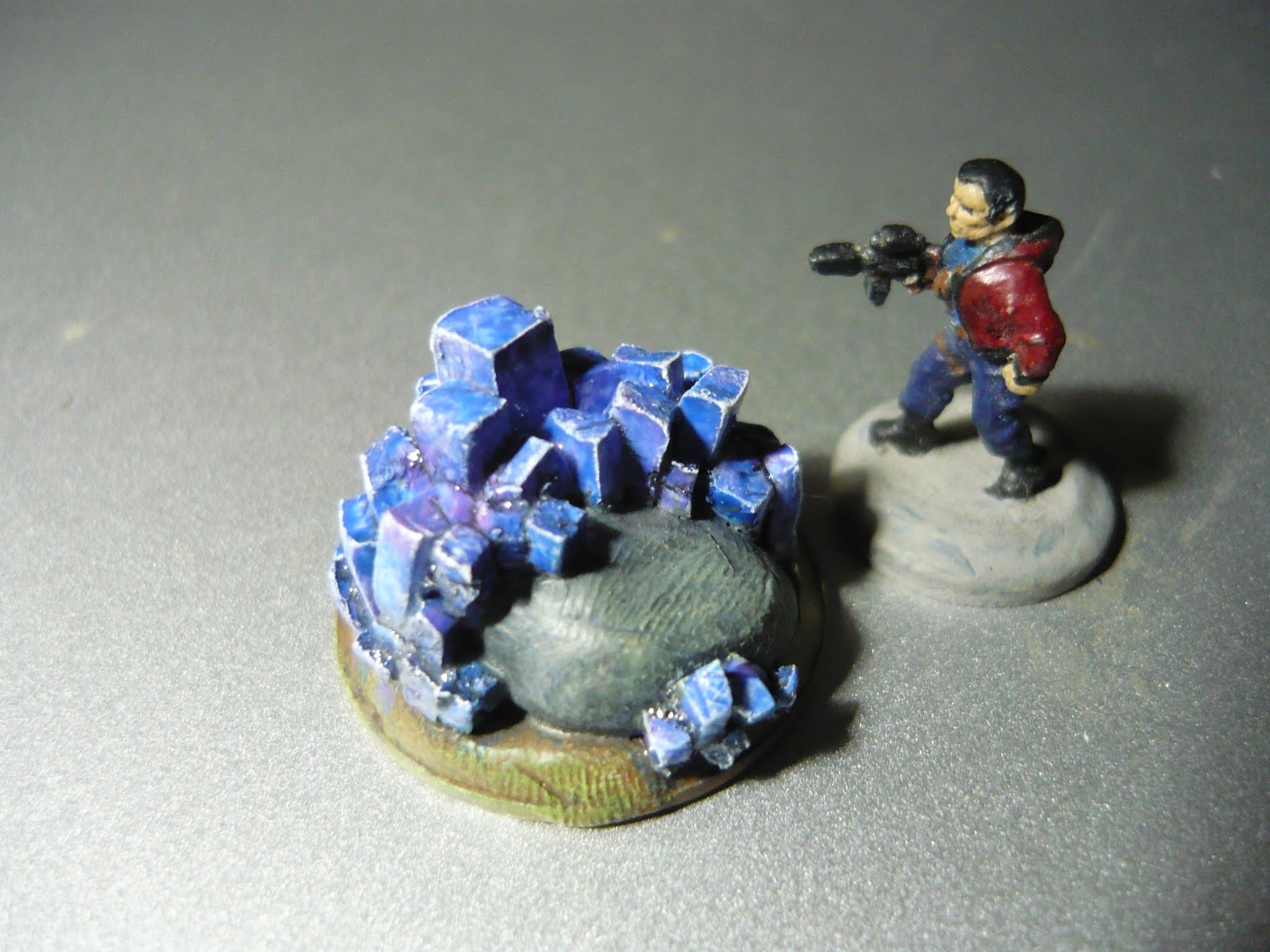

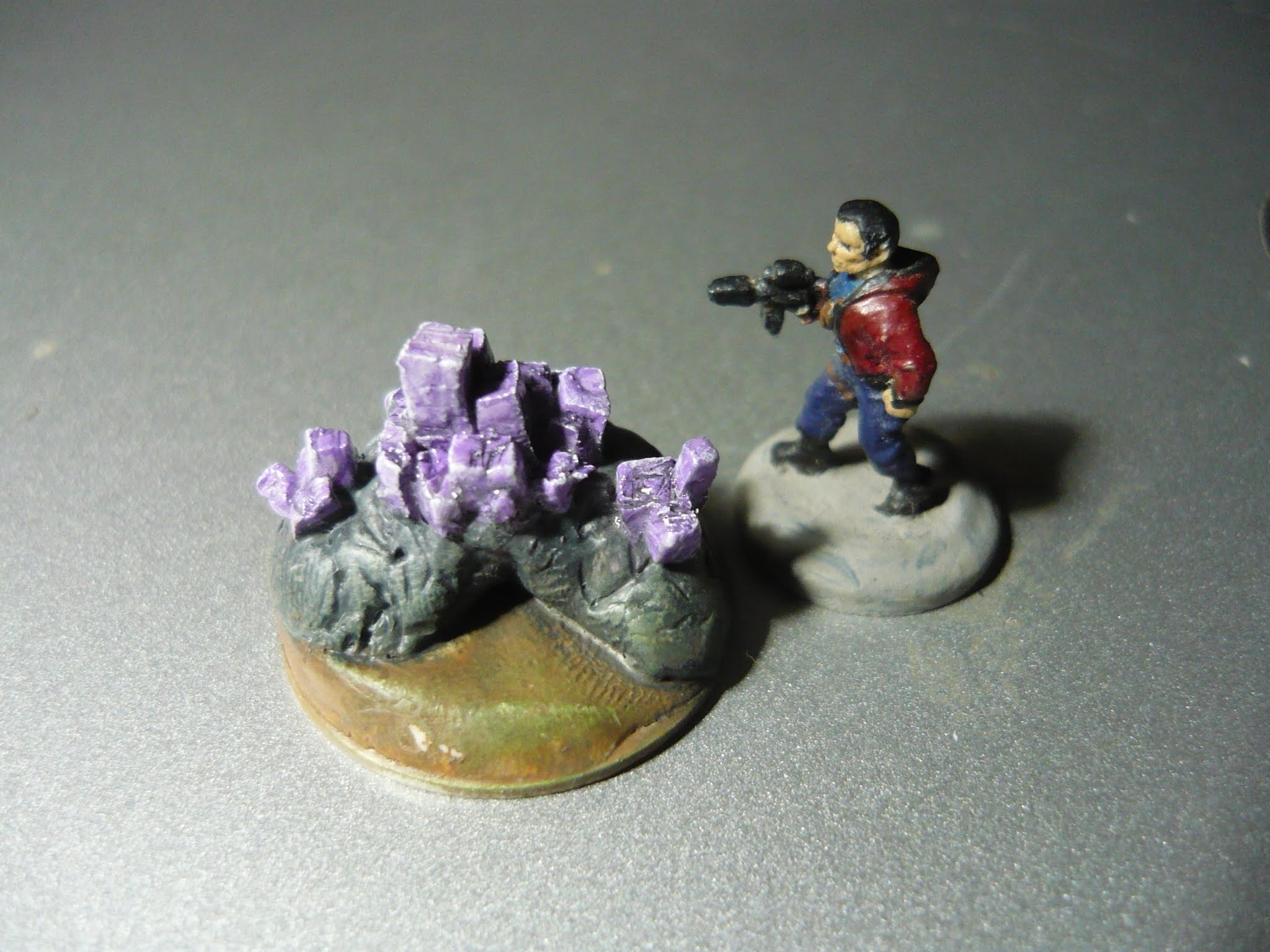

On the old workbench I want to run with an idea of some small scatter terrain. So with some fender washers and some Sculpey Clay a polymer clay. I created some pieces mounted onto the fender washers. Baker as directed then painted. In the painting process I would do a drop of different color paints right next to each other. to which I would just dip the brush in and let the brush mix the paint creating streaks of colors. After al of the paint was done I then black washer everything. Followed by highlighting with white. When that was all done I sealed everything with a brush on acrylic sealer. I paint all the crystals with a coat of Mod Podge to give them all a shine.
Purple and white was used for the crystal.
Blue and Purple was used for the crystal.
Red and yellow was used for the crystal.
The figure in the photos is a GZG 15mm figure.
I really enjoyed making these I have few more that need painting and I hope to post them soon.

How did you get such nice sharp angles on the clay?

I made the square crystal by cutting them from different size square clay rods with a razor modeling knife and the pointed crystals I made large square rods so to speak and carefully cut away from it.
With all for them I carefully lifted them with the tip of the knife and gently pushed in place as I went. if you look carefully you can see cuts or indents on the top of some of the square crystals from pushing into place.
I worked from the middle out of course and just made things small as I went, which helps hid some gaps plus the smaller ones are much easier to get into place. Once it was all baked all it need was painting.
