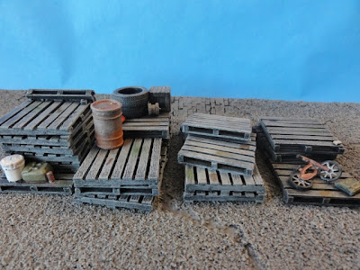

I was asked on my blog to do a tutorial on how I make pallets and I thought I would post the information here too.  They are useful as scatter scenery for any modern modern genera from the twenty's on.
Materials:
wood coffee stirrers
wood matchsticks
PVA or white glue (depending on your country of origin)
First I cut wood coffee stirrers and match sticks.  They are cut to the same length.  1 1/2 inches.
Then I glue down the two outside internal supports (matchsticks) to the outside edge of a coffee stirrer.  The second coffee stirrer is used to support the matchsticks and are not glued.
I then glue in the middle support.  Note I did not measure in any way since pallets have some variation between them.
Then I turn the set pallet base over and glue another coffee stirrer to the other edge of the top and I add another strip roughly in the middle of the supports.
I then add the next two strips to finish the top of the pallet.
When set I turn it over and glue the three bottom boards.
When completed, arrange them in an interesting stack and glue them in place.
 I usually make about twenty at a time so I have parts drying the whole time that I am working.
Hope you like.
Snitchy sends.
