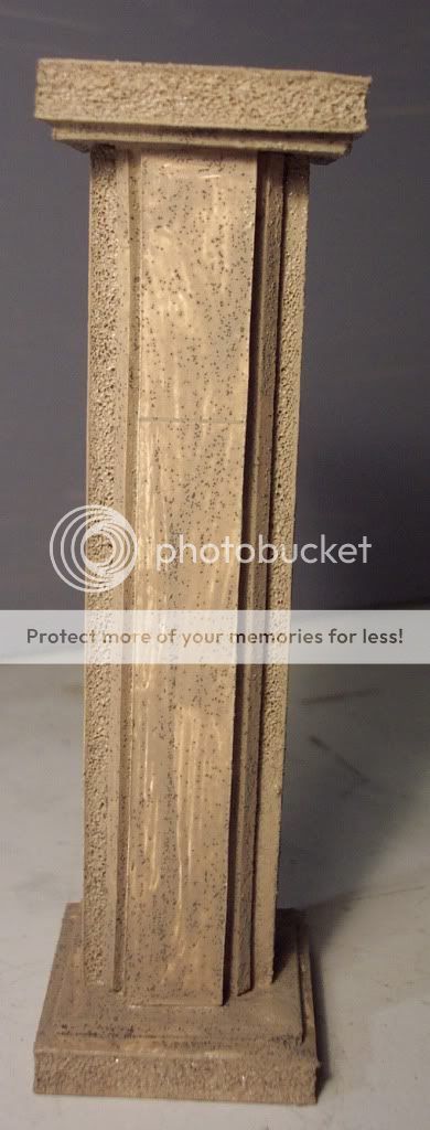

If you are wanting cheap try this. The pillar is just a WIP for a temple I am making. It is made out off Foam core and card. Then painted with textured paint. Still to finish painting this one but you can get the idea.
Painted

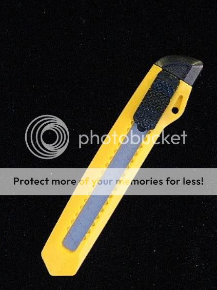

BTW, Gamer Mac, how do you manage to cut your foamcore so neatly? The foam always gets squished along the cut when I do it.
I suppose "sharp knives" is the answer, but in my experience foam tends to be murder on modelling knives.
Re: Building blocks for a labyrinth, ideas wanted
« Reply #9 on: 01 December 2008, 11:08:38 AM »
You said it "Sharp knives". I use one of these stanley knives. Quite cheap compared to a modelling knife blade. Also gives you a better, neater, square cut.
Retractable snap off blade
