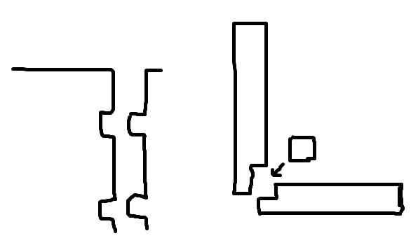

I have the same problem and find that butted joints can work if sanded. BUT you must sand before gluing as PVA is a terror to sand once hard. Do a dry run assembly beforehand.
Saxon stone buildings had stripwork quoins so it would be relatively easy to cut out the equivalent of finger joints.
http://www.extraordinarybookofdoors.com/siteimages/baldwinbrowna3master2.jpg
If using thick (20 to 30mm) foam panels for the walls, try cutting out square notches on the inner faces of the corners to make the finger joins thinner and easier to carve. Then you can glue a square section reinforcing strip inside the corner and stiffen the joint (see sketch diagram)

sukhe_bator I think this idea of finger joints might be a winner to do the Saxon stone corner work. It will also give extra strength to the joint if I make a decent job of cutting the joints. Thanks for the sketch, made it much more comprehensible.
