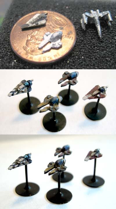

« Reply #5 on: 23 March 2009, 08:13:07 PM »
Small space fighters. Basic shapes are done with brass and then I build up from there:
