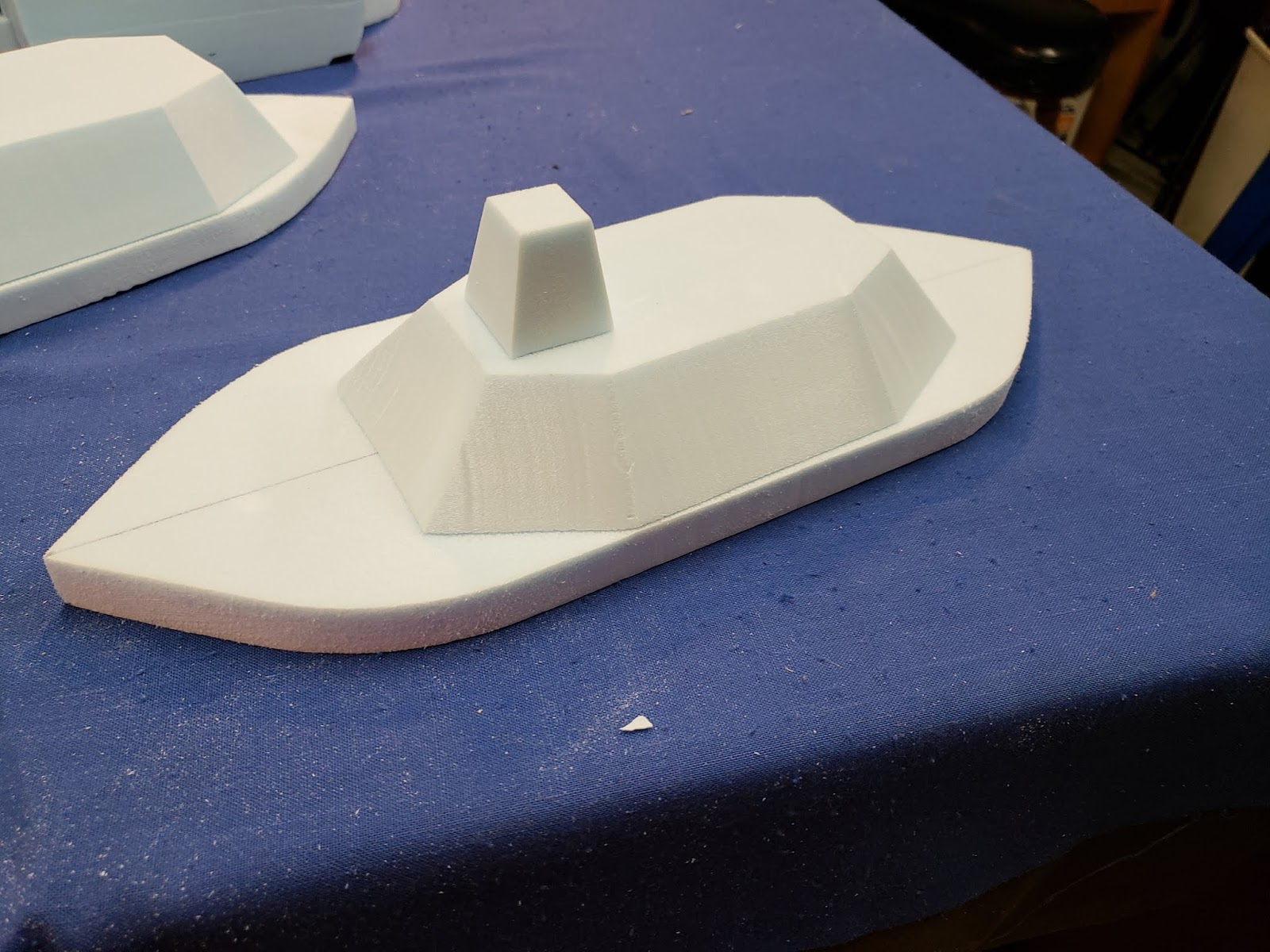

sitting there, so innocent looking, just a few simple geometric shapes

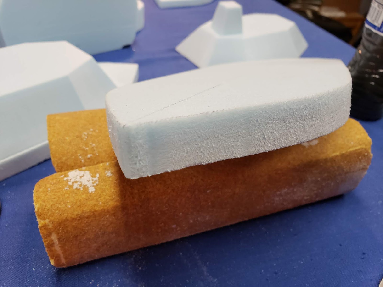

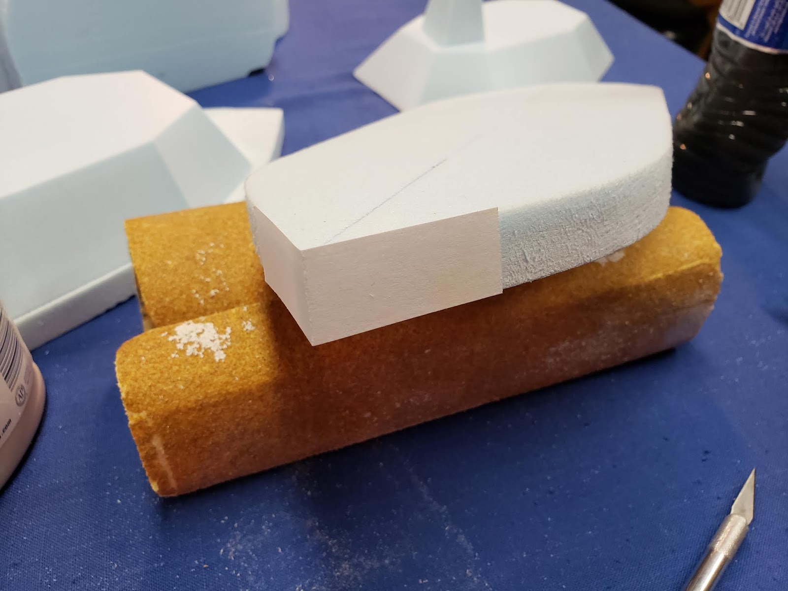

I still can't cut curves worth a darn, so there was bit of sanding involved
fitting the bow-plate

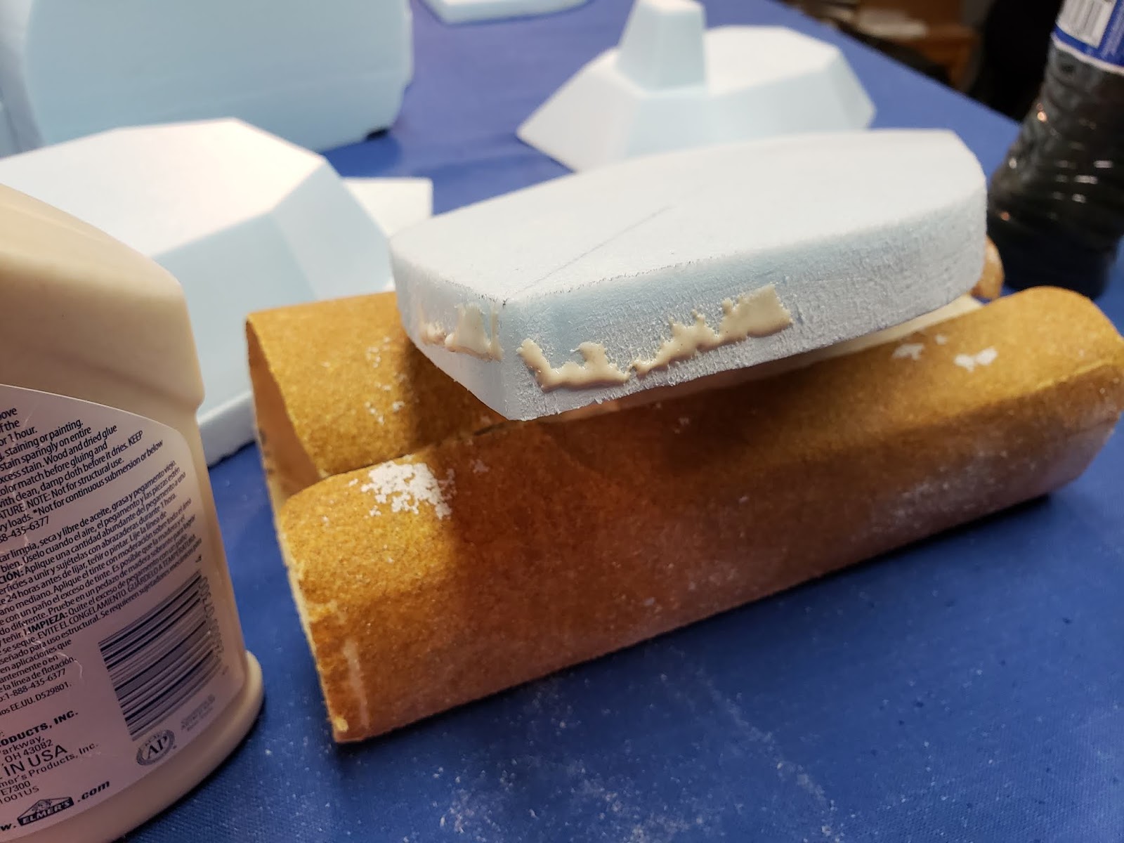

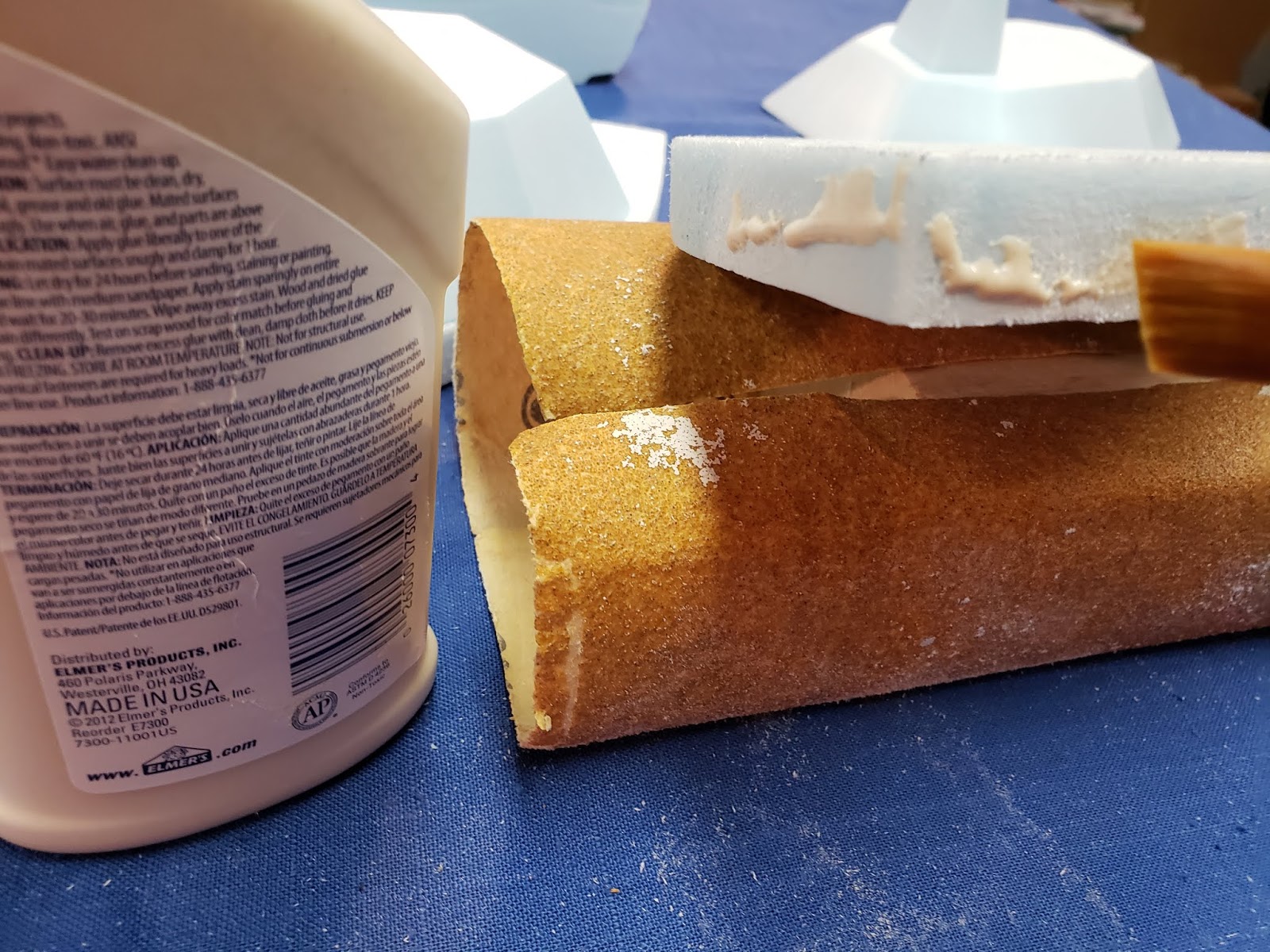

wood glue, I ran out of Titebond and used Elmer's
(which works great on real wood but behaves oddly when thinned and used on blueboard)

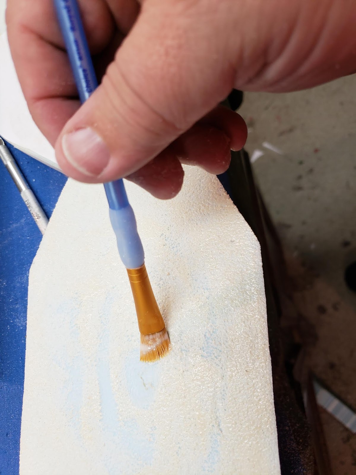

spread it around a bit with a brush to get good coverage
in no time I had the edges covered in card and a deck in place

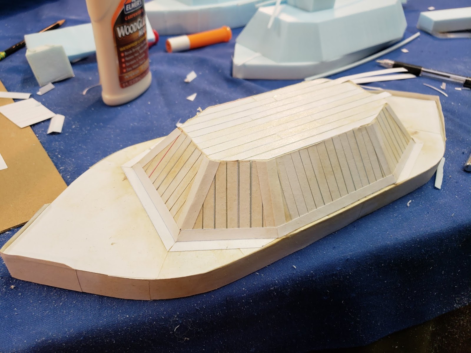

the superstructure had a huge contact area, which would dry very slowly as the blueboard is not water-absorbing, so I spread a very thin layer of glue on and set it aside for a bit to get tacky
thin the glue slightly to ease spreading,
also sand the surface lightly beforehand to give the glue something to hold onto

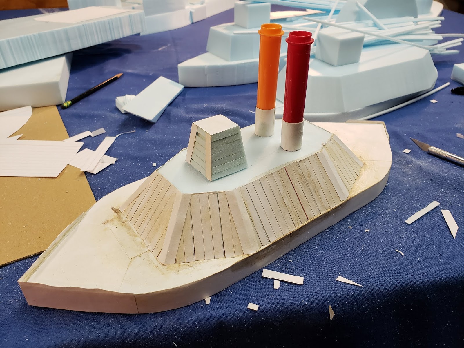

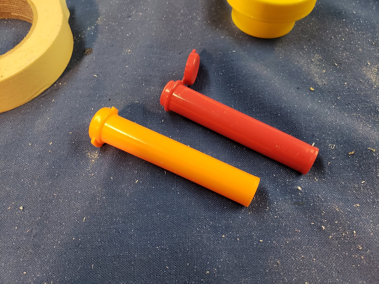

too lazy to roll paper smokestacks I resorted to using instant drink tubes
they do look the part

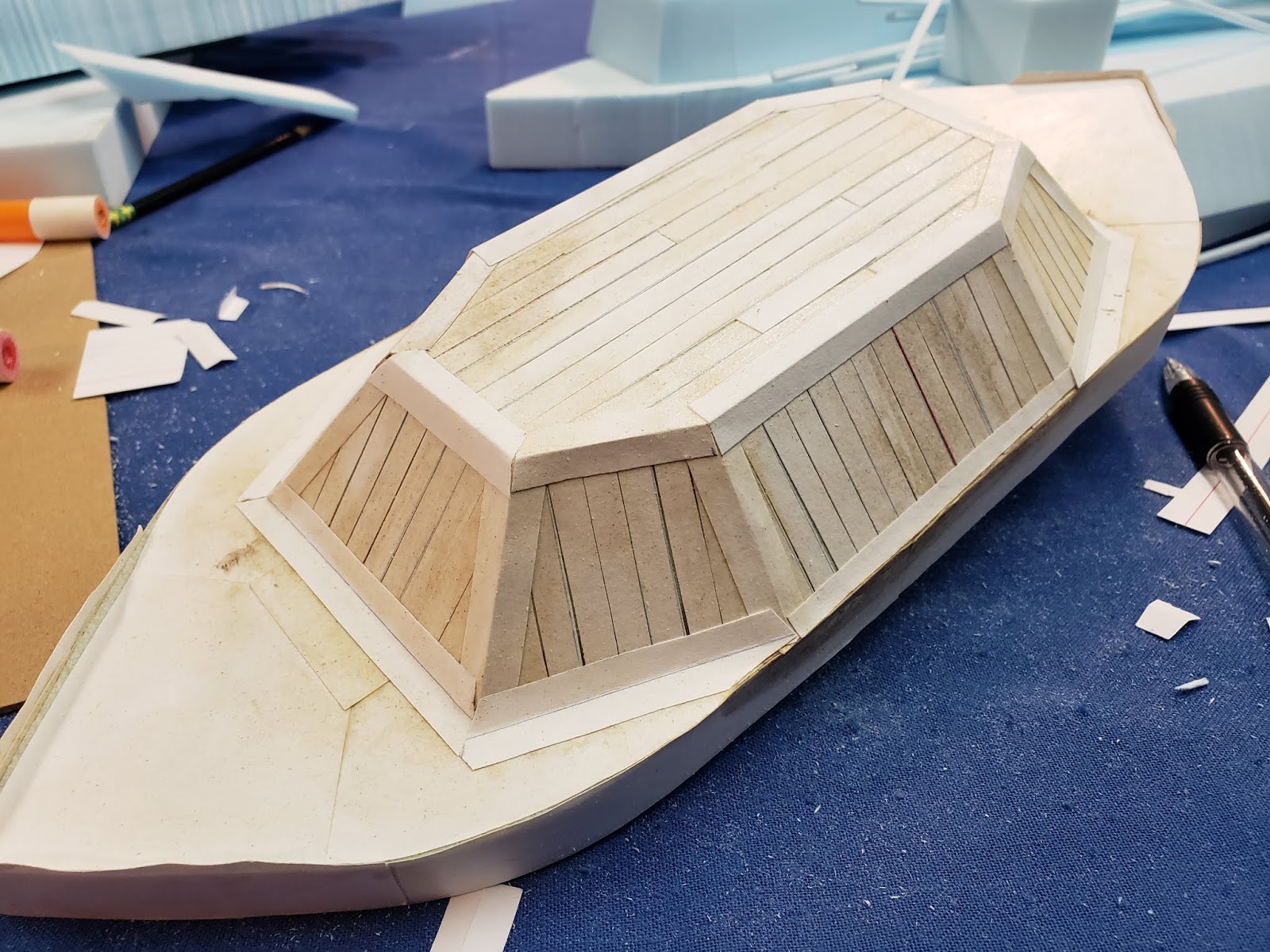

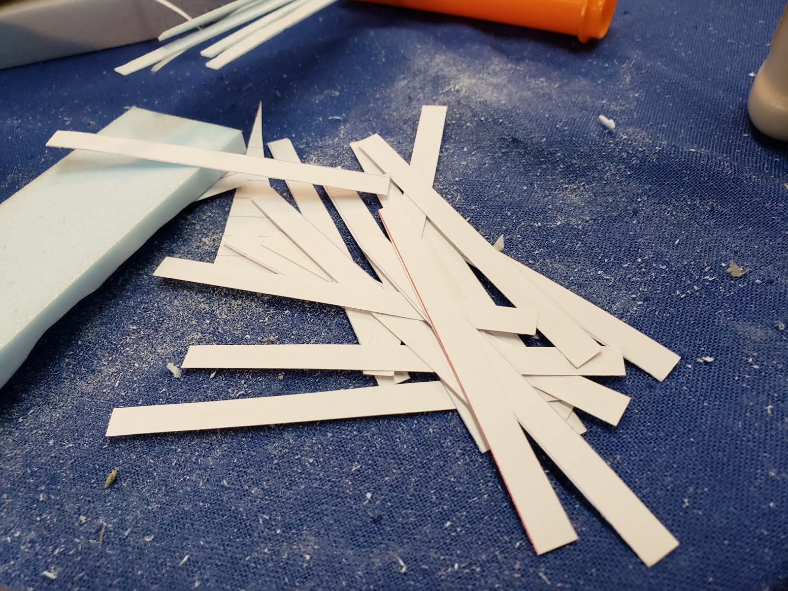

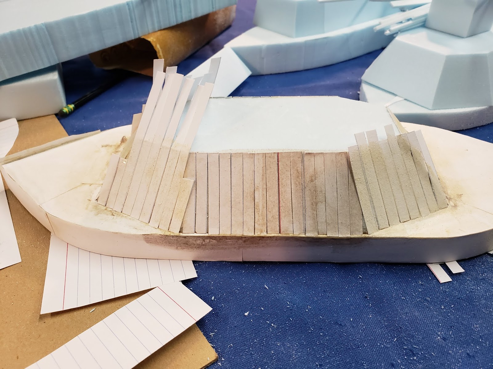

then it was time to start making the iron rails that would be the armor
index card is great for this as the lines make it easy to cut long straight pieces
a thin coat of glue and I started laying the rails into place

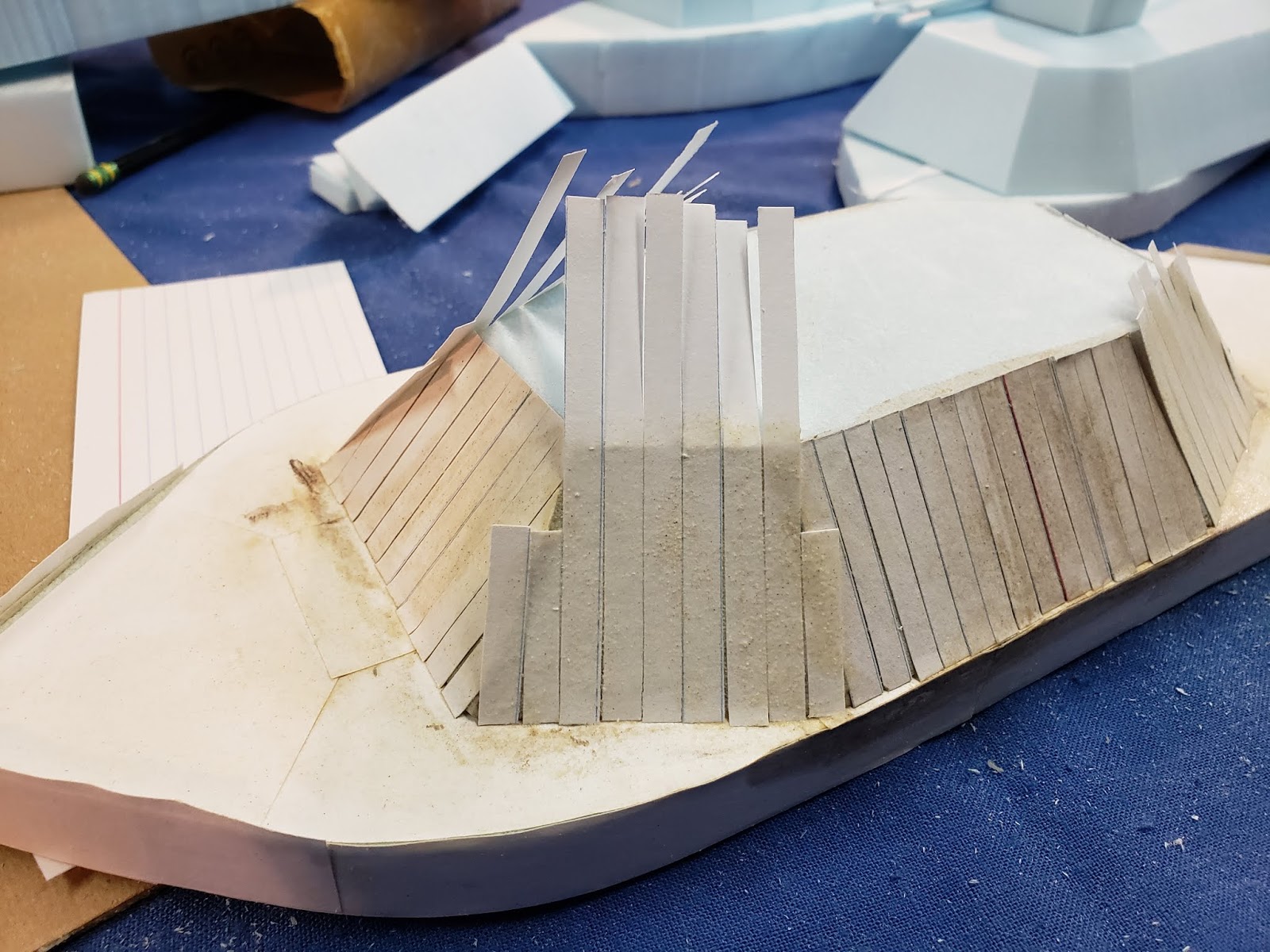

as that was drying I added some armor to the pilothouse
more armor, I leave the extra part stick up past the edge of the work,
it is much faster than fitting and trimming each piece as it is installed
once dry you can trim it back with scissors
another "look check" to make sure I was on the right path
I don't work to plans and was building this from memory
joining plates to cover the rough ends of the  railroad "armor"
nice and tidy

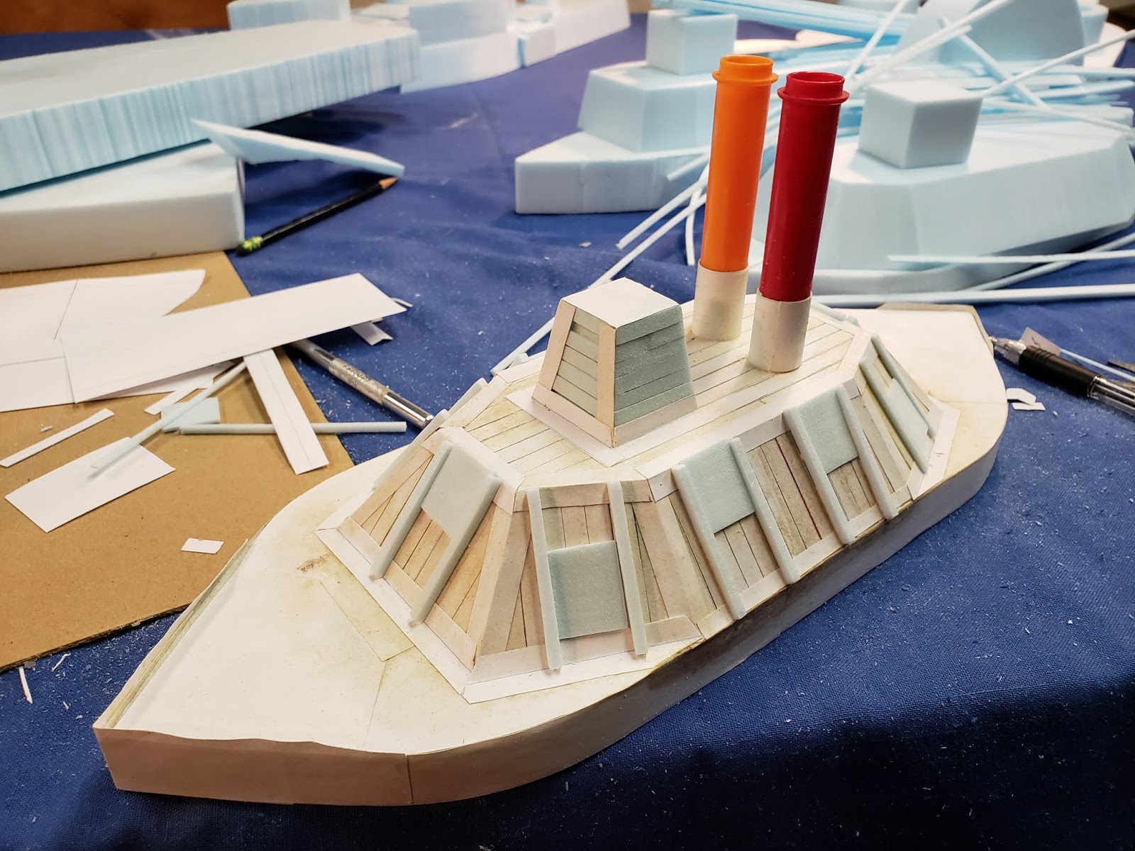

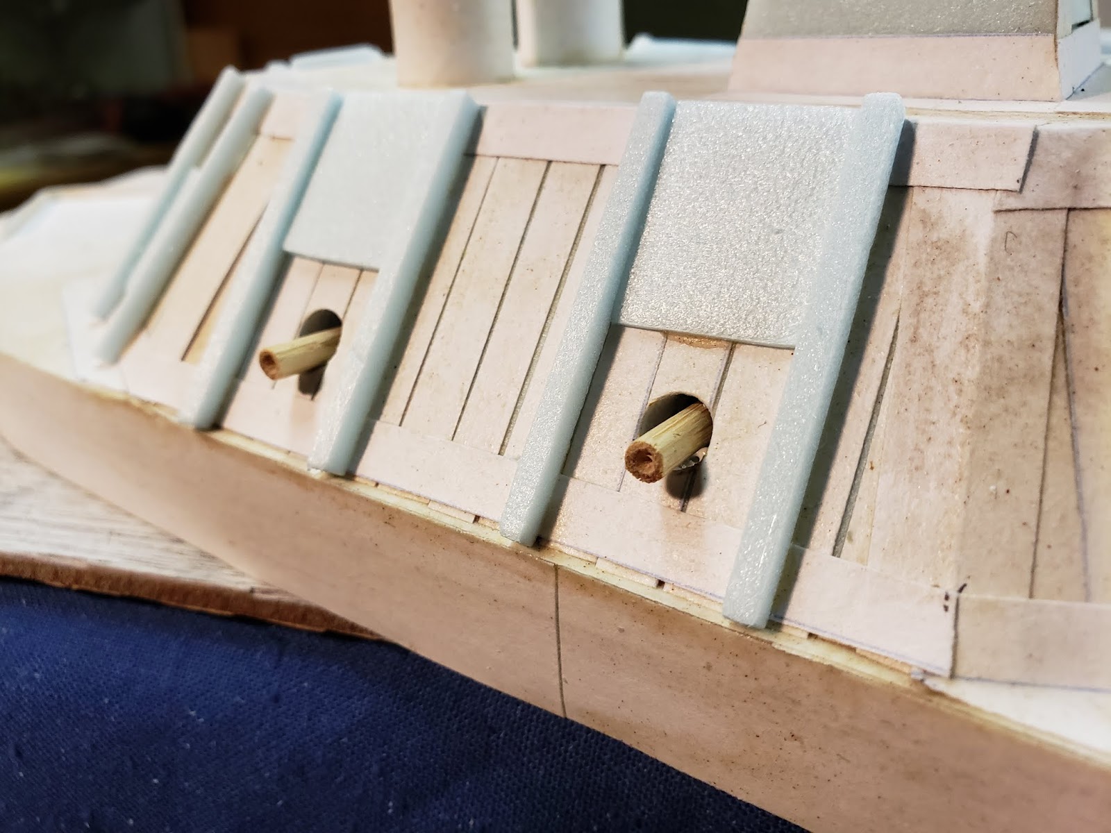

shutters over the cannon ports, some raised, some lowered

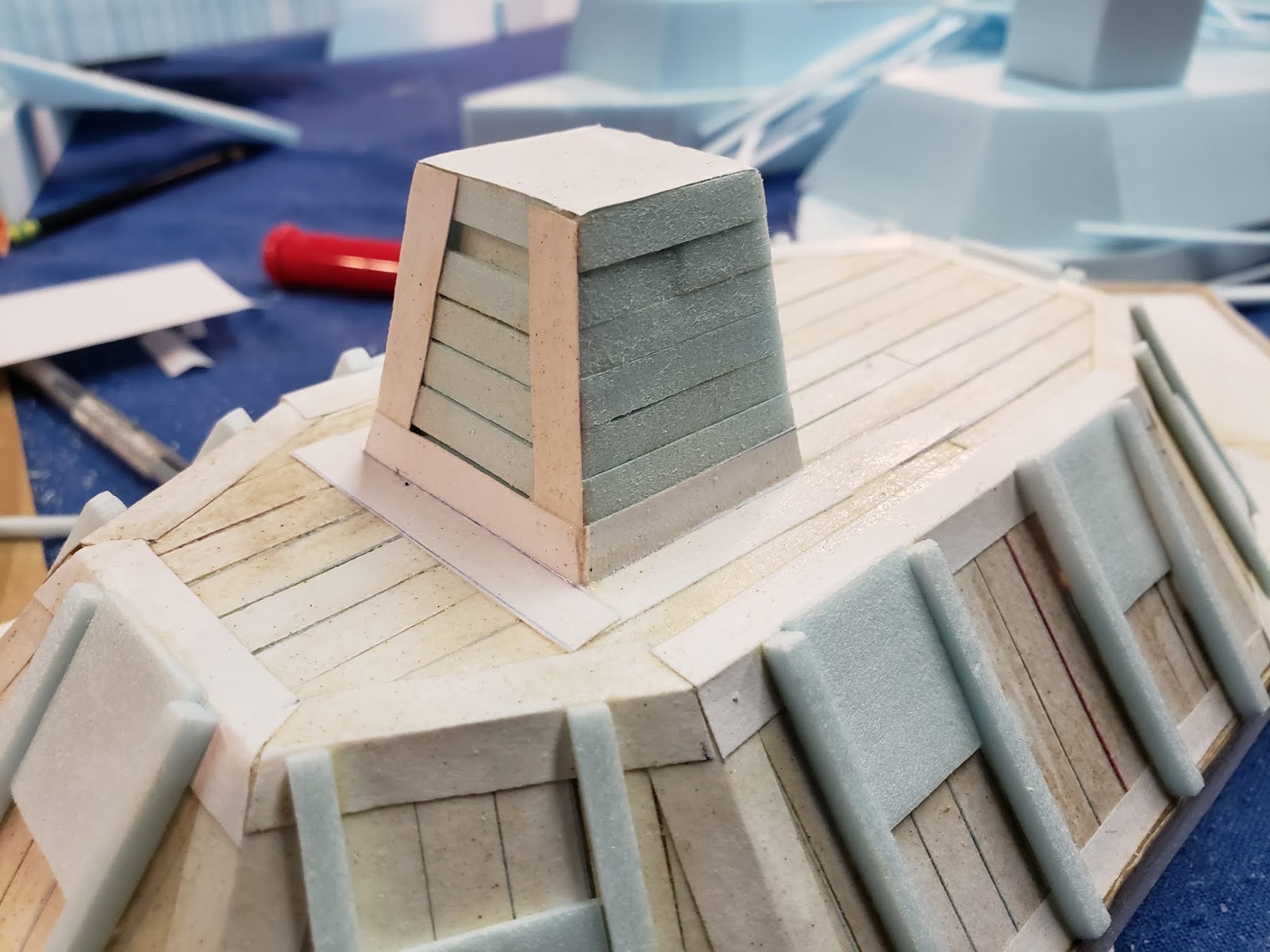

then the pilothouse got attached

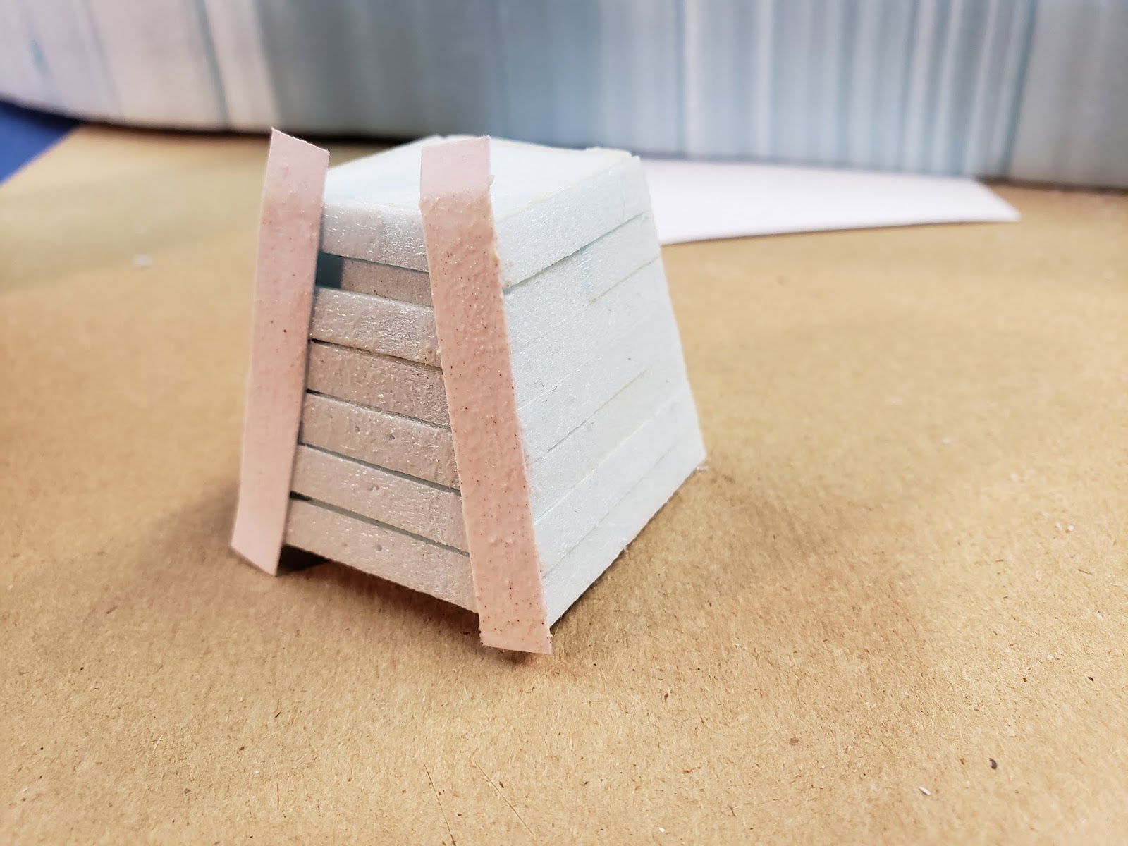

the bottom of the smokestacks were wrapped in a few windings of card to give them some heft
and make them easier to glue into place
cannon ports were cut through the armor plates

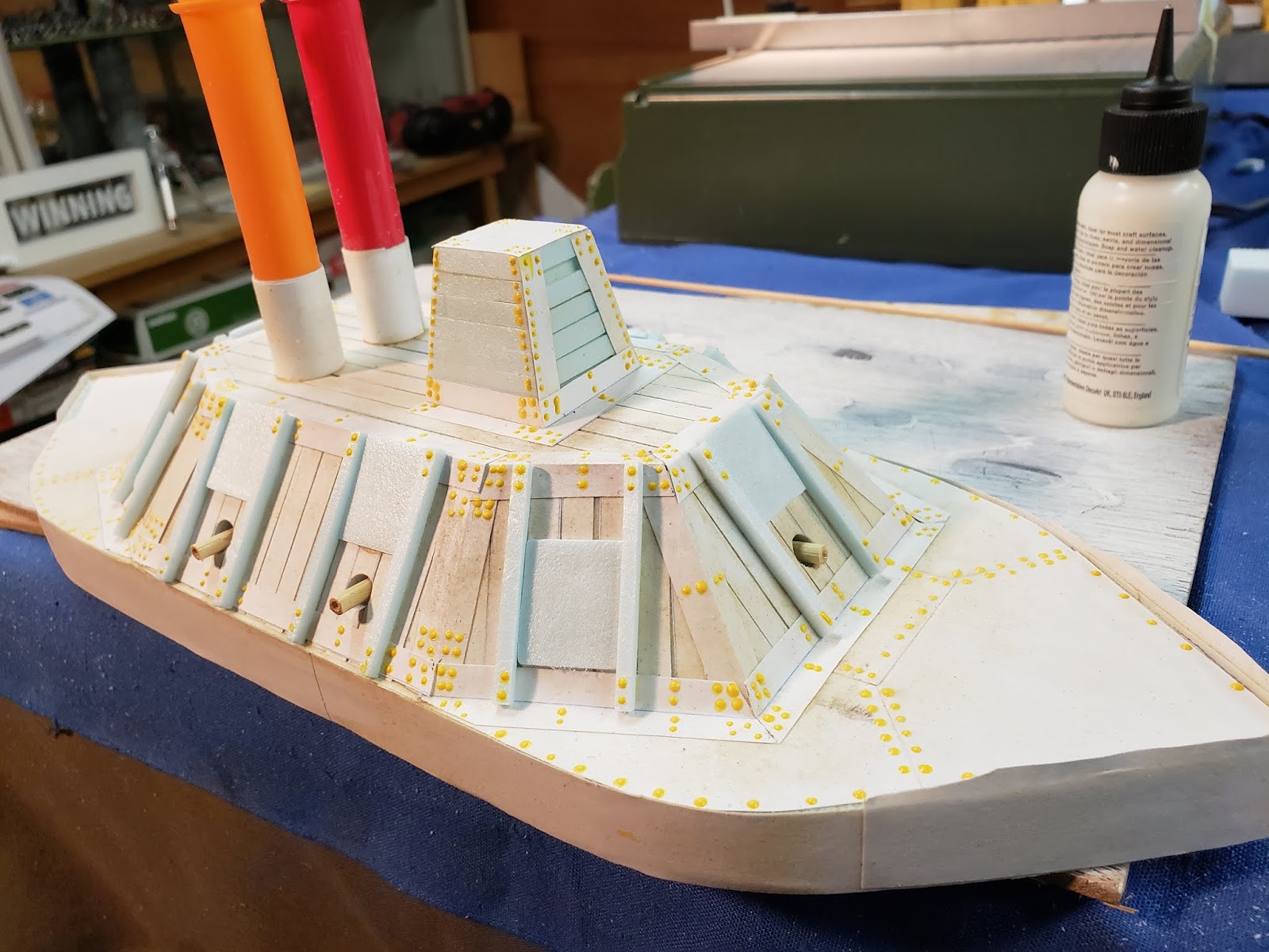

Quaker Guns! the cannon are just bits of dowel drilled out at one end
 and sharpened on the other, then poked into the blueboard

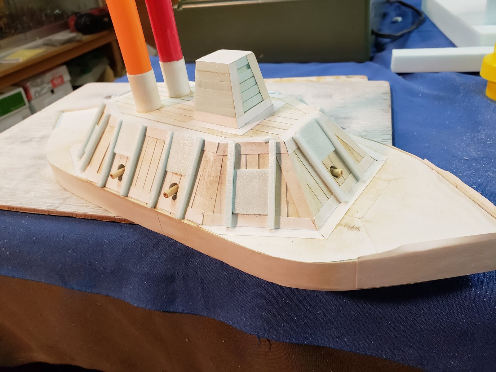

then a liberal application of rivets, all that remains is paint
