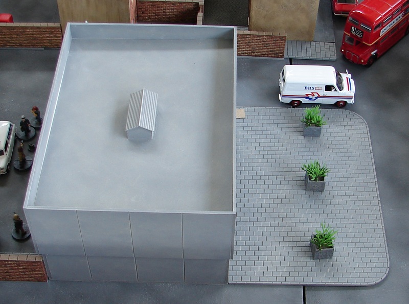

The foamed PVC can be used for basing. If used to base a building the walls should provide enough bracing to limit any bend/warp. It comes in different thicknesses too; 5mm is very robust.  3mm work well for walls and details can be added in 2mm & 1mm. Adding lots of groundwork/filler/etcmight cause more warping, but I have never used it like that.
The large pavement area below is a single piece of 3mm foamed PVC (the building is also 3mm) approx A4 in size and completely free-standing. It has never warped (but can be flexed); Embossed with the pattern, spray painted and drybrushed:
