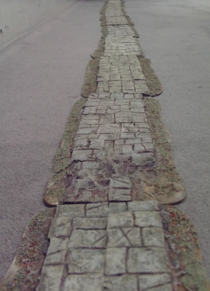

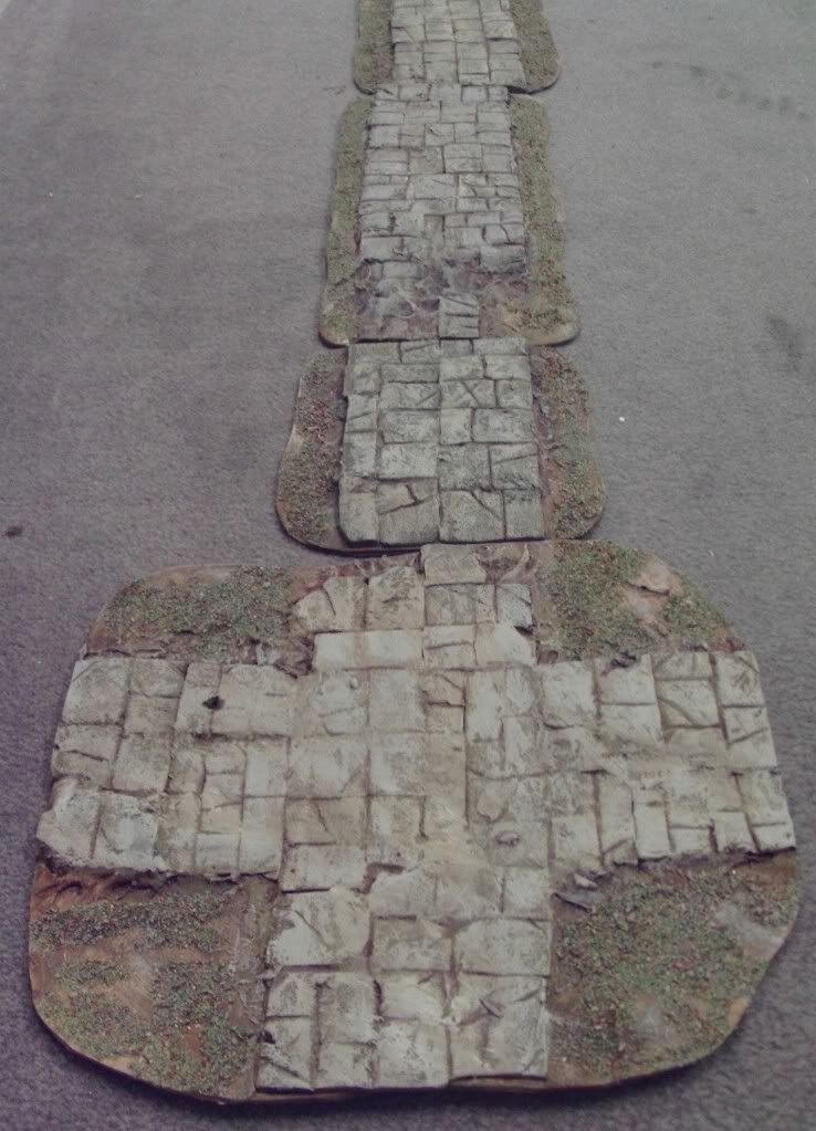

I have now completed 7 feet of military road to run partially behind the wall, in convenient 8" long sections, with a crossroads. I wanted it to have a run down, ancient look in keeping with the wall and it ended up looking vaguely like a Roman road so I was quite pleased with the result :)

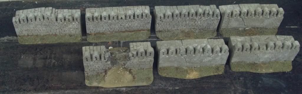

the wall sections (still WIP) but well on the way...

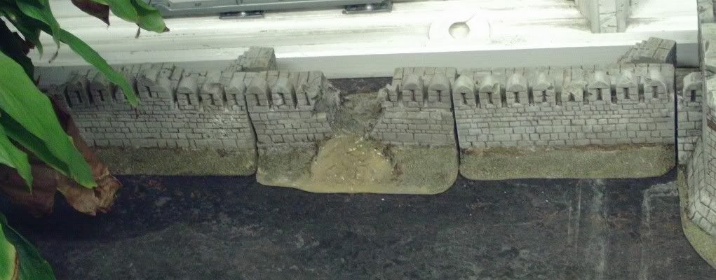

2 wall sections, 4 with removable breaches and 1 breached section. Still to be detailed with debris. Separate debris field bases will be modelled to place in front and behind and there will be a scatter of fallen stonework on the berm in front.
The 8" breached wall (sans debris) between two new 8" wall sections. I have also modelled 4 sets of additional steps to reach rampart level which can be placed at convenient intervals.

Really nice flagstone roads (and walls).
Did you put some thin foam on top to inscribe the surface, or was it made by some other eans?

Argonor,
Yes this is styrofoam insulation board again, with flagstone detailing inscribed with a bluntish pencil. I'm using thin veneers 5 to 10mm thick for the wall sections over an expanded polysterene core, with 15mm thick battlements. The road sections are made primarily from the 5mm slithers from between the battlements, randomly arranged. The trick is not to mind if the pieces are not the same thickness. Any imperfections in surface/cutting become interesting details when painted. Despite having made 7 feet of road the large bag of offcuts/scraps does not seem much emptier... :o
Really good idea to use the offcuts. Must remind myself to keep all that kinds of bits in a bag instead of throwing them.

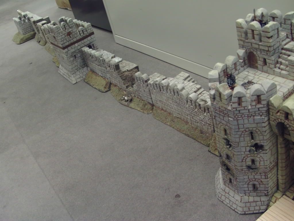

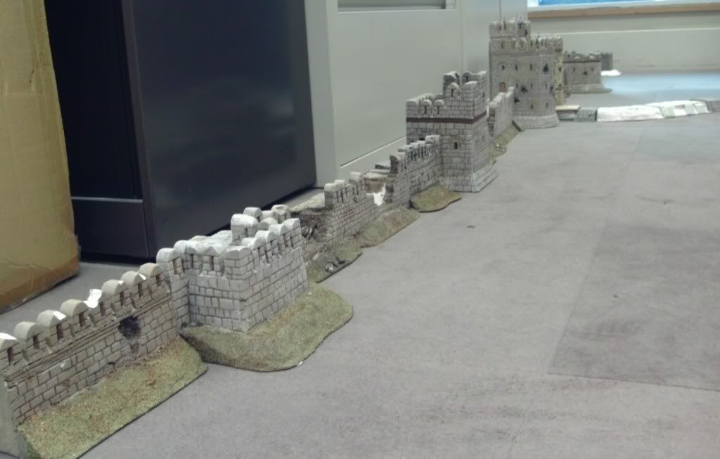

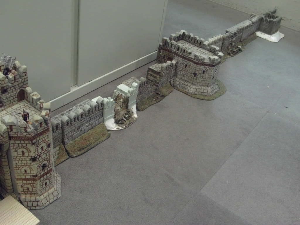

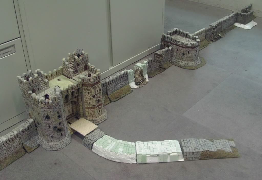

The first full dress rehearsal of all the wall pieces together on the only free piece of office floor long enough. Still lots more to do but you get the idea...
The whole 4 yards worth :D
View from the centre to the left end of the wall
A view from the centre to the right end
An overall shot of the main gate and causeway approach

Very, very nice. I, to, am particularly by the roads. A simple but very convincing design.
