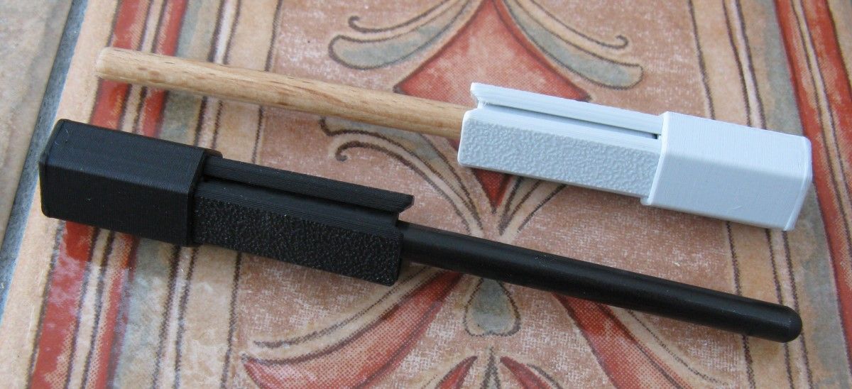

So, writing the initial post really helped me visualise what I was after and this is what I've come up with:
It's a simple two piece construction, with the two parts threaded together. The grip part has a taper inside it at the end, so the ferrule gets retained.
It's very easy to trim the wooden handle away by rolling it under a hobby or utility blade.
From my measurements this design could work for almost any brush up to a number 2, although the hole diameter and taper profile would need to be adjusted of each brush, as they subtly vary between manufacturers.
For larger sizes it would just need to be scaled up.
From some initial testing I think it has merit, so I'll look at making a set (3/0,0,2,4) and spending some time using them.
I'm also considering how these could potentially be made using materials other than printed filament. Seems like wood or carbon fibre would give a light, robust and pleasant feeling handle.
Watch this place I suppose.

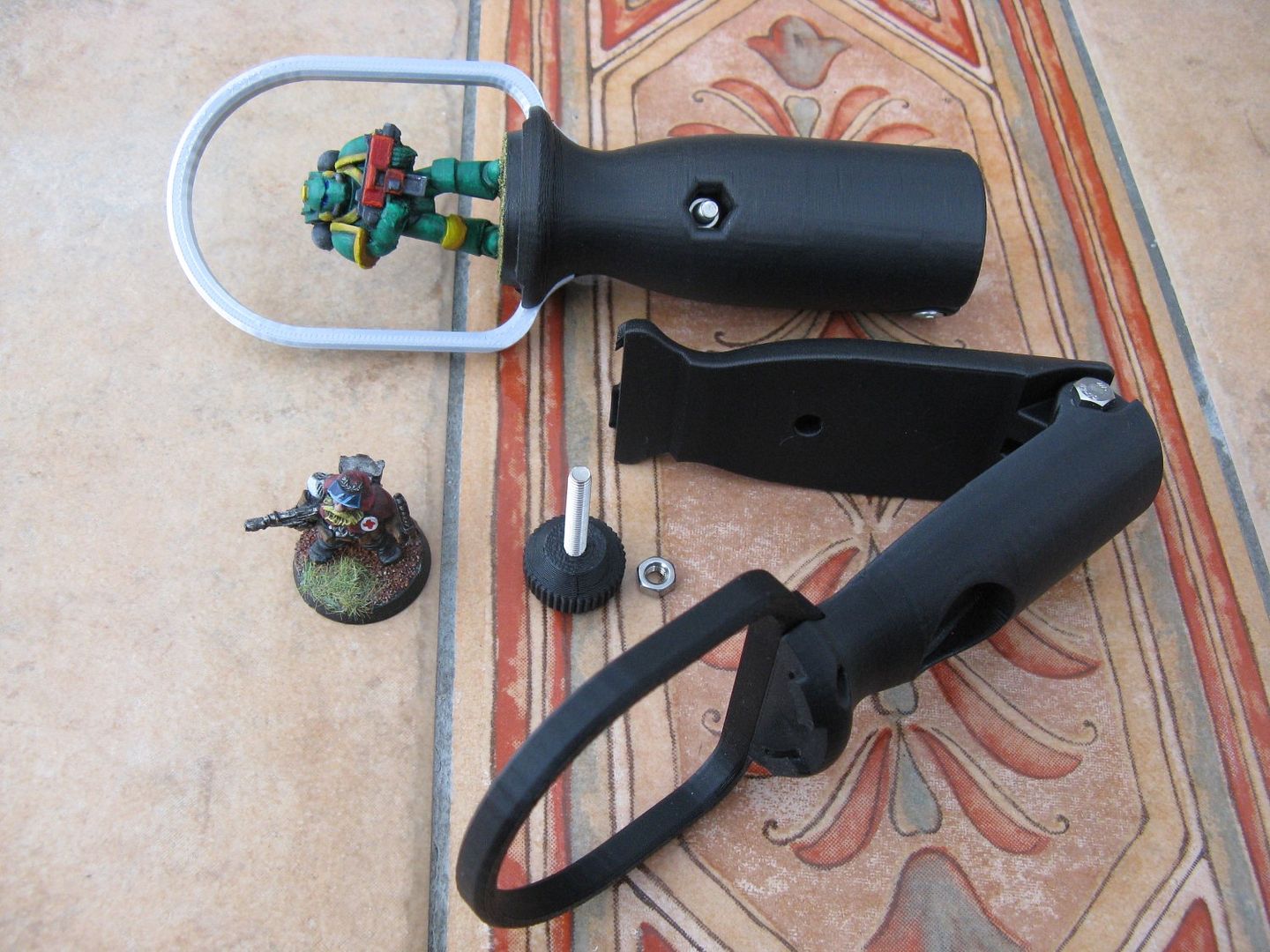

I've been using a miniature holder I designed:
I either rest my palm on my fingers as they wrap around the holder, or I rest my fingers on the support hoop. I probably do need to make the hoop larger though.

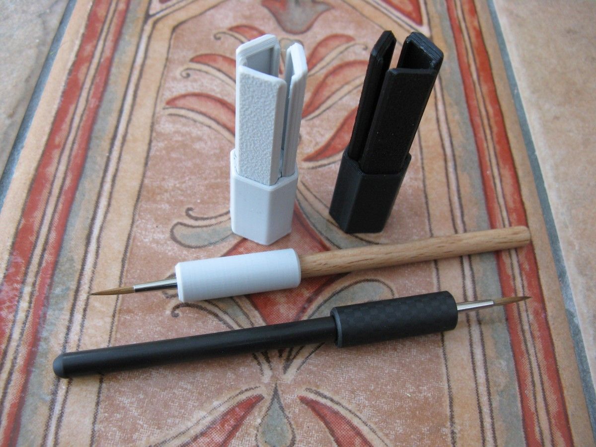

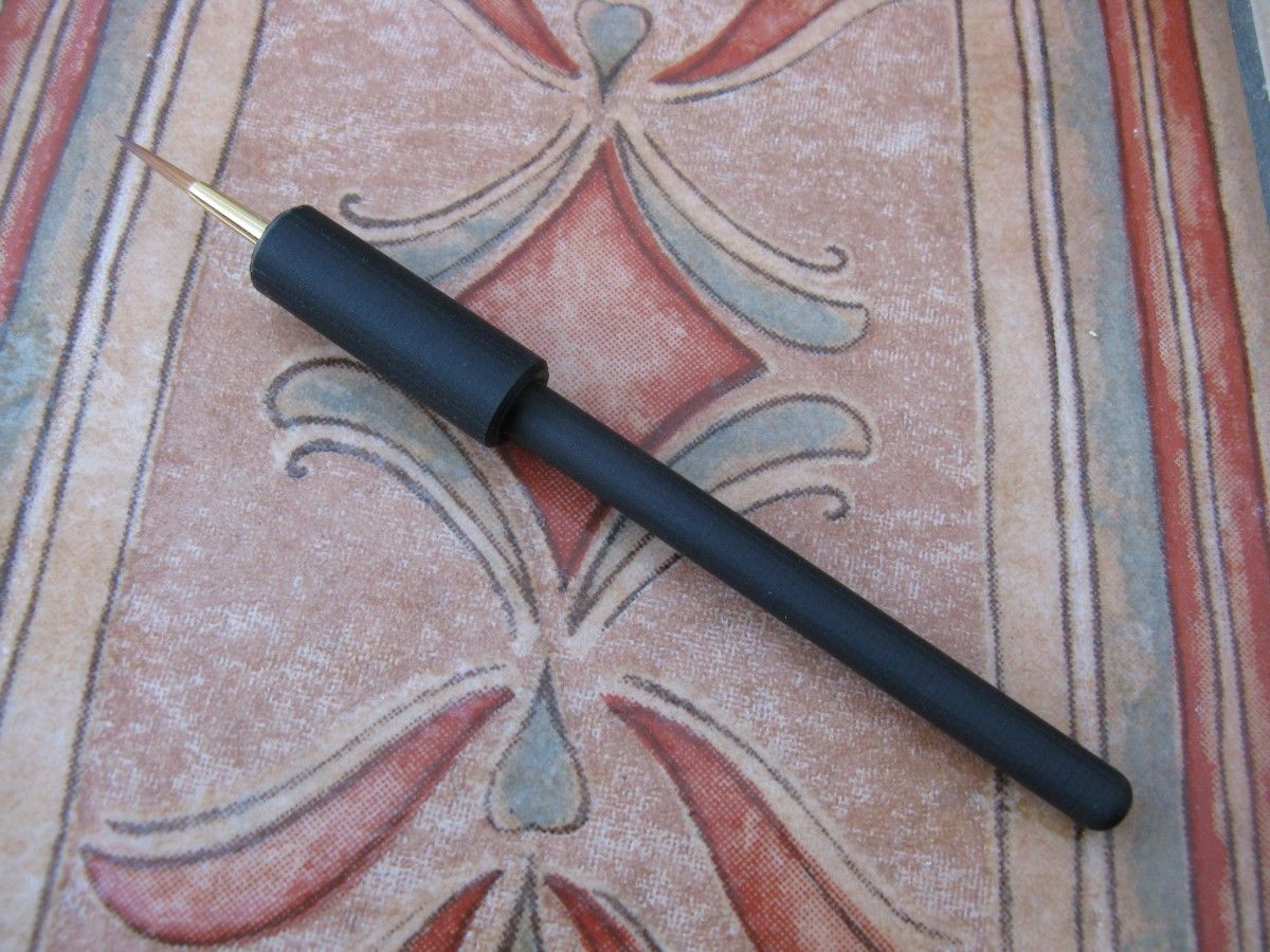

I was able to source some materials, so I've made a wood and carbon-fibre version of my prototype.
The wood is some beech dowel with some Danish oil on it. The front section is light grey PLA.
The carbon-fibre version uses a 10mm OD, 8mm ID tube for the grip, with a black carbon-fibre infused PETG printed insert glued inside it.
The tail piece is 6mm carbon-fibre rod

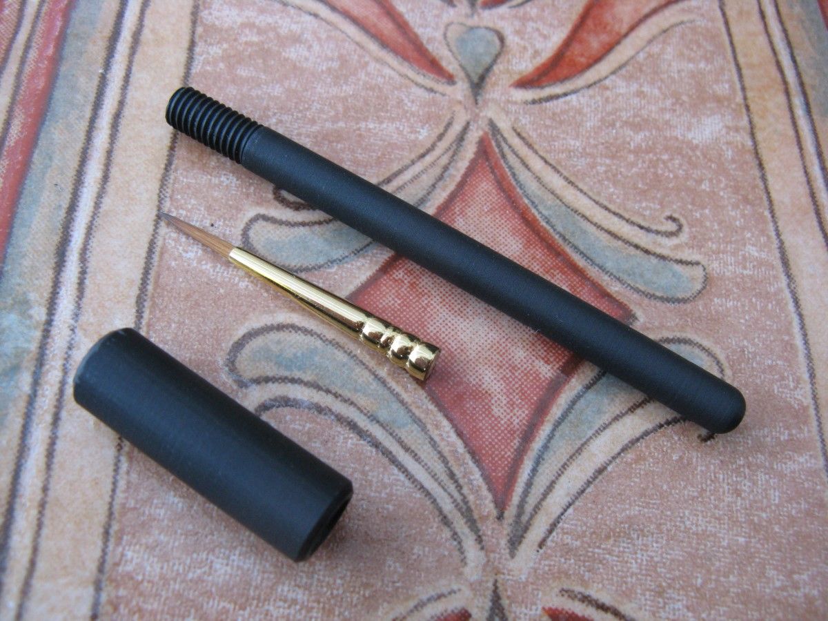

Adding threads to both the wood and carbon fibre was a bit of a trial and error process.
I changed the design of the thread in a couple of ways to both improve it's printability and cutability:
The thread angle was changed to 90 degrees from the more standard 60 degrees (or 55 degrees if you're really old).
Also the thread pitch was increased, but not the depth, so the crest of the thread was much larger than usual. This helps prevent chipping in the carbon-fibre by not cutting it to an external point.
Cutting a thread into the wood was only partially successful as it still wanted to chip and split off along the grain.
Thread cutting on a lathe is done too slowly for wood, so the solution would be to use a dremel type tool with a circular toothed blade as the cutter, instead of a fixed carbide bit.

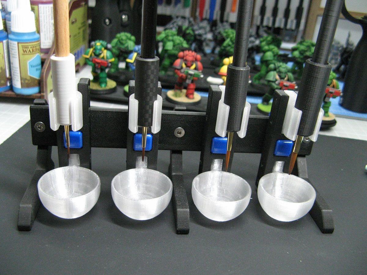

It's not shown but inside the grip is a small insert that is what the brush ferrule actually sits in and this insert is screwed into the grip, from the rear, all the way to the front until it hits a shoulder flange.
This allows the holder to be converted to take pretty much any paint brush up to a maximum size, without having to change the whole grip.
Whether it be a Humbrol, Citidel, Army Painter, Artis Opus or Winsor & Newton brush; the holder should be able to take them without issue.
The next step is to make a full set for myself and see if I prefer them over a longer period of time. Then I suppose I ought to hand examples out to hobbyists for some broader feedback.

So, I've been able to make some progress on this project, with a few brush sets made up and handed out to interested colleagues and friends; for some hands on feedback.
The limited responses so far have been positive, but it's early days.
If feedback is really positive I may move on to a very limited Kickstarter of 50-100 hand-made sets for a broader test group.
They definitely needed a proper cap for transporting them, so I've come up with a crude all printed solution, that just about works.
I also wanted to take advantage of the shape and have an easy access holder for the brushes.
I'm sure the bowl under each brush is totally unnecessary, as even a wet brush will never drip, but I can't do away with it, just in case.
