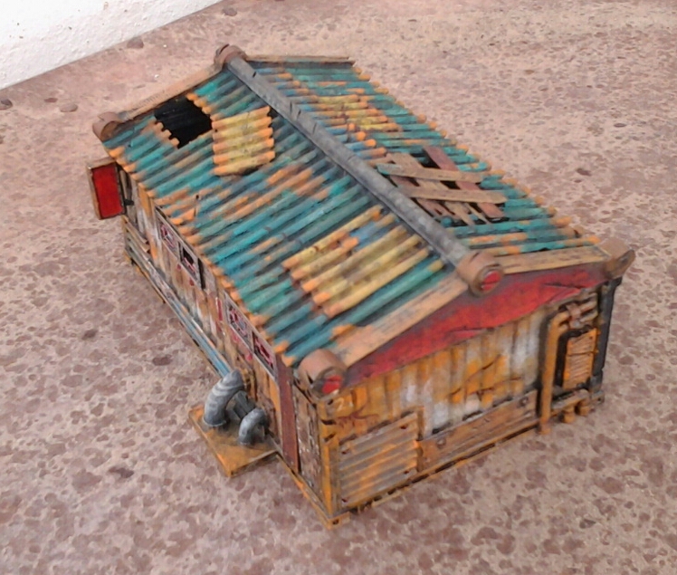

Back in 2017 I bought and painted a lot of 3D FDM printed 28mm scenery from Thunderchrome/Bad Roll which was great. When finished it looked like this:

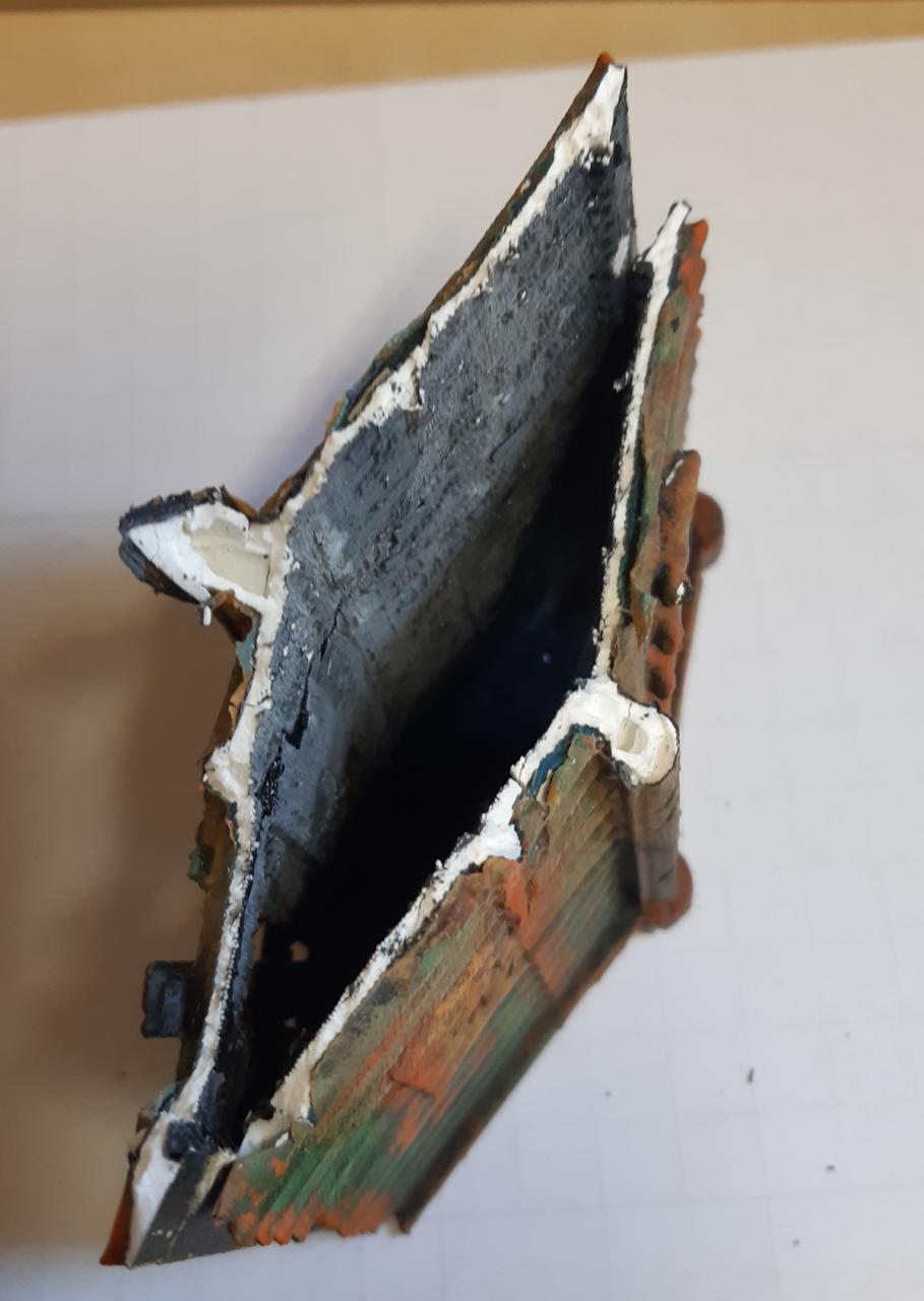

Now the actual FDM material is decaying, sort of crumbling and going "floury" and brittle. The roof of the building above split apart when I picked it up from one end unable to support its own negligible weight

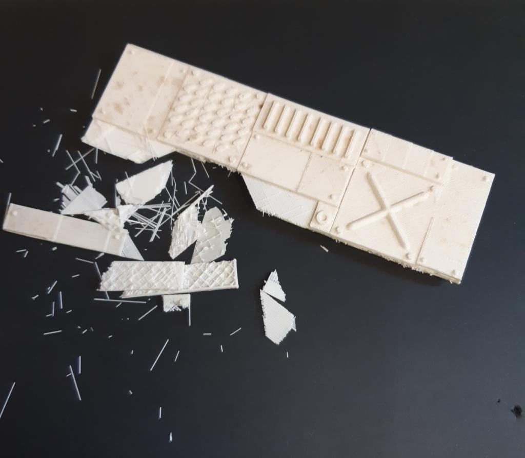

Just touching one of the unpainted pieces (A walkway) is enough to cause it to disintegrate and crumble.

The pieces I painted were completely encased in paints/varnishes (apart from the clip together joint plugs and sockets) but the Chinese style container building above is the worst of the pieces I have, the pale area visible on the underside of the roof is all soft and spongy but no signs of moisture, It is disintegrating from the inside.
