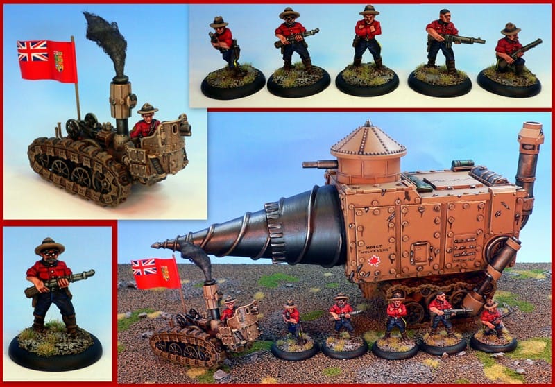

Both are great, but The March West is one of the best VSF entries so far! Outstanding.
The big vehicle is total VSF maddness :-* :-*
You will need to tell us how you built it. I think recognise some of the bits.
I like the paint job on the figures as well.

Excellent idea to use those copplestones as mounties!   :o

Thanks gamer Mac!  This was my first foray into VSF and it was a real blast!  I took a glance over on the VSF section of LAF and found some great inspiration while doing a little bit of "research"  It appears that everything is better with rivets! lol
* The base/frame of the terranef is an outdoor electrical box.  I covered it in plasticard panels then covered the rest with various bitz, and rivets made from the plasticard off-cuts.
* Most of the bitz neat the back are metal bitz for a Rhino/Hellhound (the added weight helped balance the model!) except the smoke stack which is from some GW 40K scenery pack (I think - it's the only bit from that kit that I had)
* The drill bit is from a GI Joe Mole (  :-X Greywolf  ;) ) with another bit to finish the tip.
* The turret is from a railroad plastic water tower, cut in half, and a gun made from plastic tubing.
* The treads are from some GW Orc (or Ork) thing with some gear pieces and pistons from a Transformers toy (Rumble and Frenzy!)
It was their hats!  lol
The only true Mountie model is the Pulp Figures driver of the mini-tank (HMCT "Prairie Dog") PYP 1 - Sgt. Prestown of the Yukon

very smart use of figs for the canadians- they all look juts right for teh part in their uniforms.
Where are the marsians from?

The Martians are Parroom available from Brigade Games. Both fantastic entries, still can't make up my mind
