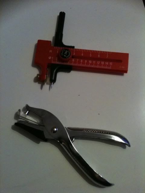

Neil-The plastic sheet is only the thickness of a sheet of paper. Easily bendable. The model gets the strength from the frame on the inside. As well as the circular framework there's also straight sections running the length of the corridor.
Hammers- as Jim says, just take your time with the cutter. Don't try and cut the circle out in one go. There's two cutters myself and Colin use to build things. Ones that compass thing and the other is a hole punch. I'll try and take a picture of it. I think we got it out of Millars the art store.
As I've said I've got the compass one, Xacto brand with a small jointed blade. This one requires a good first groove and a good many turns since it cuts rather shallow.
Then I have one of these:
This one cuts pretty well as long as you change blades regularly. It needs a light touch however. To much pressure and it will cut a new wonky, off centre groove. Also it may enlarge the centre hole making the blade , again, wobble from its groove.

These are the two culprits I use...
The top one is the ackward one. Make too big a circle or apply too much pressure and it goes ski-wiff!! The bottom one has seen alot of use around a certain Zeppelin shaped model!

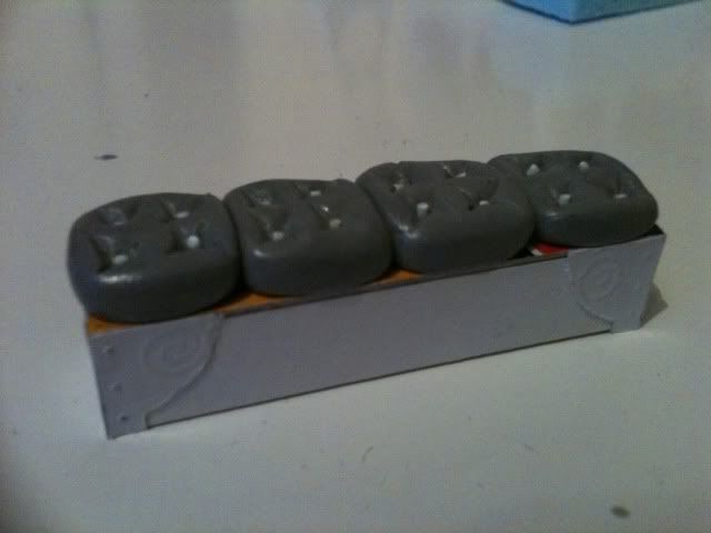

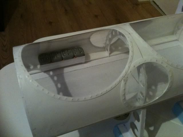

« Reply #64 on: 21 December 2010, 08:11:02 PM »
Viola! One bench.
It's mainly wee bits of card with modelling putty shaped like cushions. The buttons are just plastic rod and the banding is glossy magazine cover with rivets and swirlies embossed on it.
Bench in the corridor.

Re: Clash of the Aquanauts - an early stage project thread for BLAM 2011
« Reply #67 on: 22 December 2010, 12:11:31 AM »
Very nice :-* :-*
But sorry I don't get why there is a bench in the corridor, geriatric crewmen perhaps lol
Yes, that's how that cookie crumbles...
I got myself a variable size hole maker like those pliers thinggummybobs, but with a rotating wheel on which the punches are mounted (get it?).

« Reply #71 on: 22 December 2010, 12:28:54 PM »
Hammers-those wheels cutters are extremely ackward. Colin got one and we could barely make it cut through any decent thickness of material. That small silver punch seems to give more leverage.
