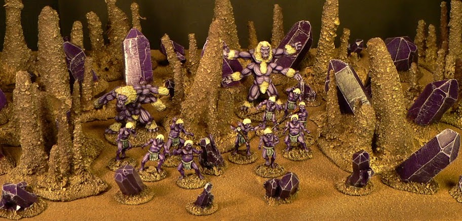

A KINDRED SPIRIT...you have my condolences. I'm also working on a subterranean beasty; in my case, it's an alternate Mordheim setting....I'm using Hang Son Doong as a model AND, since the main gaming table is a hexagon set up to accommodate Geo-Hex tiles, quite a lot of the pieces will be hexagons...right now I'm doing a 3'X3' chamber.
I've had reasonably good luck making stalagmites from floral foam cones roughed up with a saw &/or a hot knife foam tool, then covering the thingy with Woodland Scenics Foam Putty. This also works for Mega-Mushrooms...the latest batch are more or less 9"/23cm tall. I'll P.M. you when I put up photos here or you can check it out here: http://boringmordheimforum.forumieren.com/t4674-maudeheim-city-of-the-stoned-updated-12-26-10  .

We have a product here called Celluclay which is just a finely chopped papier-mâché. I've used it to build very convincing stalagmites and stalagmites by using a dowel rod as a core and building up layers of papier-mâché. If you leave a bit of the dowel uncovered it works to anchor the piece into foam. Fast food chopsticks and bamboo skewers work really well for this.
I don't have access to any of the ones I've made but the process is pretty simple to figure out assuming you can find a finely chopped, pre made papier-mâché. Or get an old blender, some glue, and a lot of newspapers.
