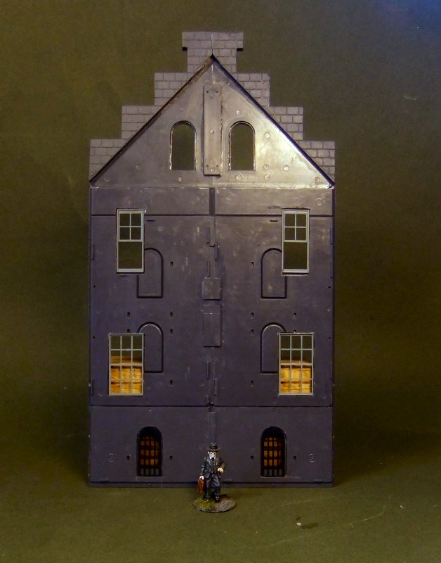

Cutting out windows is a good example.
A razor saw would not have worked since the openings are in the middle of the material. Cutting 3mm hard plastic with a carpet knife may give you better precision but is pretty hard going. The thin circular steel saw jumps and flexes a bit but cuts quickly.
