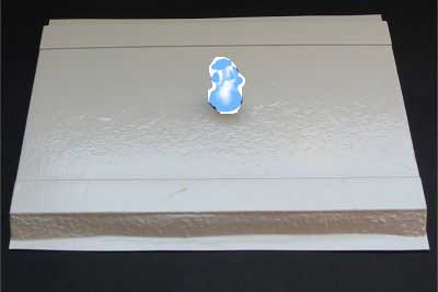

Since I have a table that is textures black gray which is useful as road I could choose between painting the sidewalks on or making them separately.
After quite some thought I'm going for the last because it gives more freedom in setting op scenery.
Having a day off is also great. In between working on my mad doctor I'm busy constructing the pavement for my city terrain.
I started out with big 5 mm thick polystyrene blocks:
After cutting these into strips of 5 cm wide I had quite a lot of material to build pavements from:
For the first test case I drew and the tiles to make sure they would look nicely (sizewise):
After this I used a pen to make deeper grooves following the drawn template:
A few conclusions a this point:
Drawing all the tiles take way to much times. For the next tiles I just mark a few dots and after that use a sharp knif to precut where I want to have the grooves. Only after that do I use the pen to deepen them a bit. Precutting also results into nices tiles.
I already painted a small square to see how the end result would be. Imporant to note is that using you fingers it is easy to just make some of the tiles a bit of uneven. In this case I didn't paint any dirt ow whatever on the pavement yet. putting some sand on, some weed between some tiles and maybe some paper, a soda cans and other dirt will enhance the pavement a lot. I'm sthinking about intrudusing some sewers gutters, but I'm not yet sure how to so this. As of yet I haven't made any corners yet, but have a lot of spare material letft to make them, just a some special tiles containing other scenery.

How will you make it Base-proof? I found out that painting the material with wall-colour will make it more resistant, but I still hestitate to use them as floors (I still buy the more expensive foamcore for that), because the bases leave prints sometimes...

Base-proof...?
hmm, I actually didn't t think about that, but for as far as I can see this stuff is quite sturdy. It already take quite an effort to make an impression, so I guess it will be quite okay...  Time will tell though.. :)

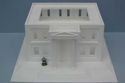

Out of interest, are those the Amera buildings?

« Reply #6 on: 02 May 2008, 12:13:08 PM »
Yes indeed, they are the Amera Buildings.
One of them (the one one with the roof --> not the factory though) has been painted the "difficult" way, using first GW rough coat, then successive drybrushing and weathering. The rest was just sprayed black, followed by fast spraying with  white from a bit longer distance. After that the same weathering using VMC smoke, dabbed on en smudged with some tissue paper.
The drybrushed building is actually way nicer, feels better and is a bit more work. Well... actually it mostly only feels better. If you see the models from a distance longer then 40 cm, you can't see a lot of difference anymore, and even on pictures it looks great.
Next picture is a close up of the factory door and how the walls look after the "spraying" method:
On a side note, I think I need a few more of their buildings. especially the ministry building, of which I hope they will also sell me the think without the pillars, because it will give me a number of complete buildings.
 I also want to order the roads, but want to use them as a sort of canal. (then at least I can use my boats :))
