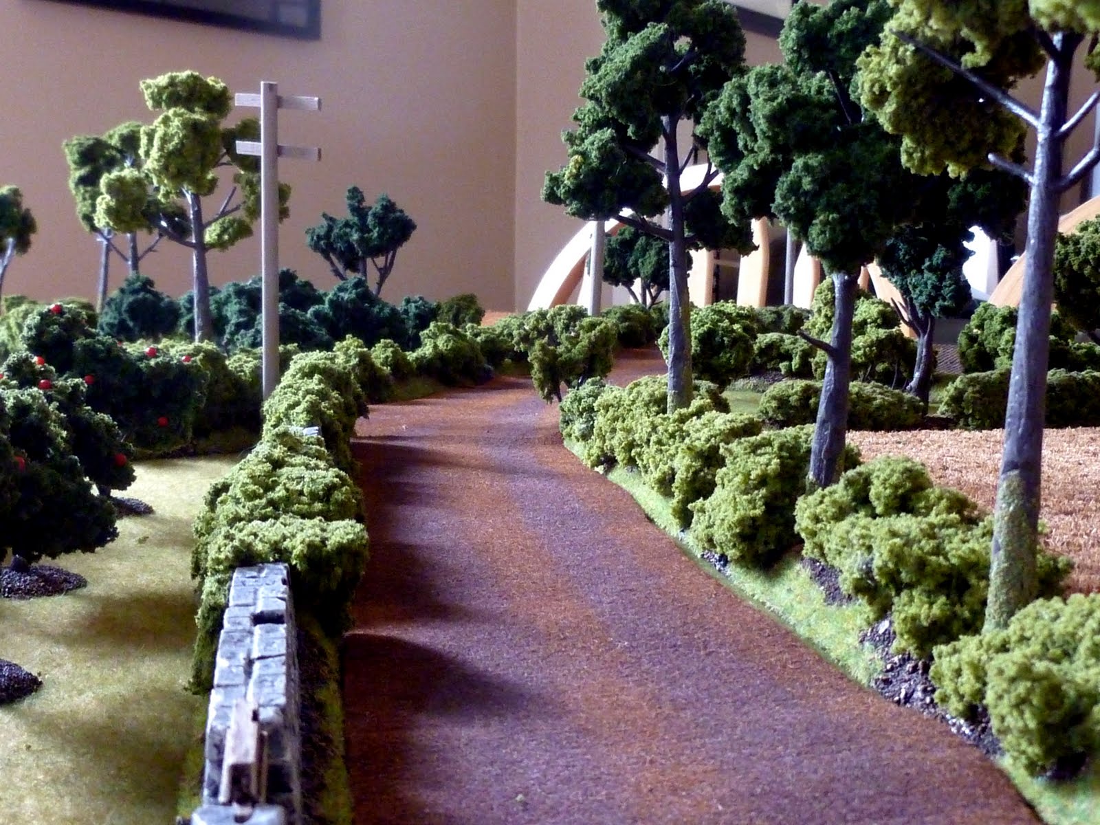

Here's a pic of the bocage on the table with trees, roads, and other scenic bits. I still think I need to go taller with more bushes. Still, they make decent enough pieces for hedges outside bocage country such as in the rest of Europe :)
http://3.bp.blogspot.com/-GWrTEfWrATo/TfV3NzeA7WI/AAAAAAAAAcU/N3micYU6MKU/s1600/Normandy%2BCurve.jpg

Modelling that sort of thing in a way that's flexible enough to use for multiple layouts on a wargames table is problematic, though you could do it for a display game, and bocage hedges like Iron Ivan Keith's are good to go as far as I'm concerned.
As he says it would even better without the (already minimal) rocks.    :)
