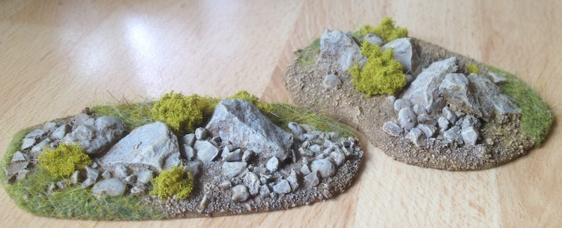

I made a whole bunch of CD based rocks for a dartmoor/Bodmin moor type look.
Here's an example:
I used the £1 epoxy putty from pound stores.
Sold the lot a while back though the images links are listed on this sale thread
http://leadadventureforum.com/index.php?topic=55883.15
