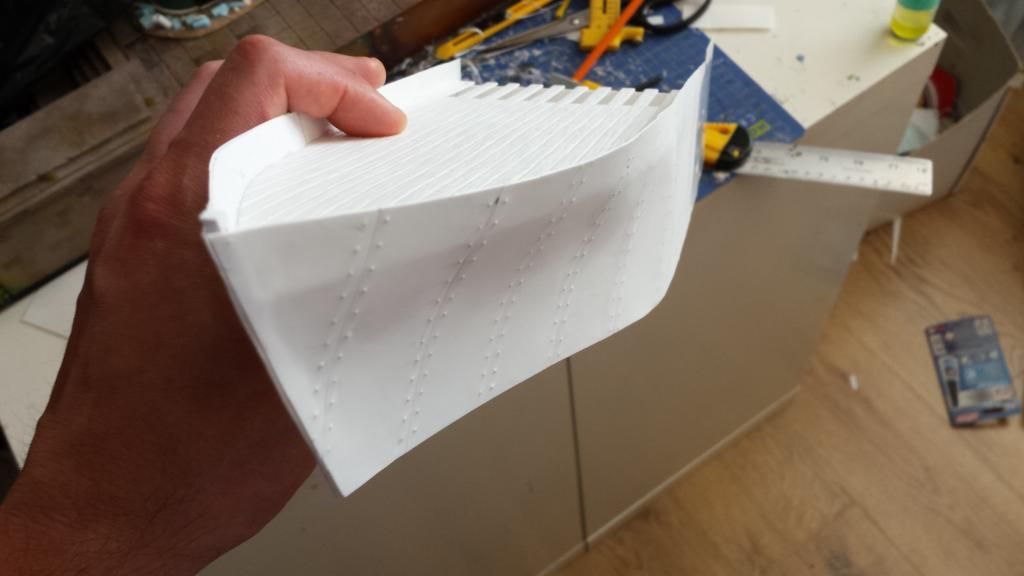

It looks like I might need to fix the port side. You were right Jim, a couple of the plates kinked....

My guess would be that you've used too much solvent mate and as the fumes have no way out between the ribs they have attacked the styrene, hence the 'warping' you can see.
Unfortunately it will only get worse and the only suggestion is to start again.
Soul destroying I know but there's no other option  :(
You might be able to cut a couple of hull panels out and just do those but then again, it might be more trouble than it's worth.

I don't think I'll need to go that far James! If I can pull the top layer off I reckon I might be able to pack the underneath with thin GS and put a new plate back on top. It won't help for the overall shape but it should repair the panel mate!

How about sanding some blue foam to the right shape and placing it inside so it is bulking the panel back out?
It might be easier that way.... ???

Blue foam and styrene glue (the solvent type) don't mix at all. You could coat the foam in pva or some such but it's a lot more work.
I hope the packing out works mate  :)

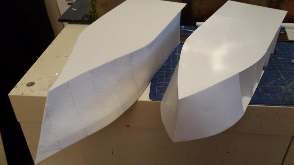

« Reply #27 on: 17 July 2014, 10:15:18 PM »
So I've put together this. It's not got the multiple layers on it yet but at least it gives a general idea of shape!  I think this is pretty close to Frams cargo ship pics.
What do we think? Any better?
My next problem will be the back! Anybody any idea how I shape a round-ish are end AND manage to put on a top layer of plate detail? o_o o_o

Better shape for a cargo ship, yes  :)
Have you got any vent holes for the solvent fumes?
You could get the back vac-formed and then use the pen for the rivets but it would need a solid former of the shape.
The other option would be to keep the angle of the hull the same as it goes down the straight side and wraps round the back, that way you only have one curve to worry about and not a compound curve that would make shaping it difficult.
