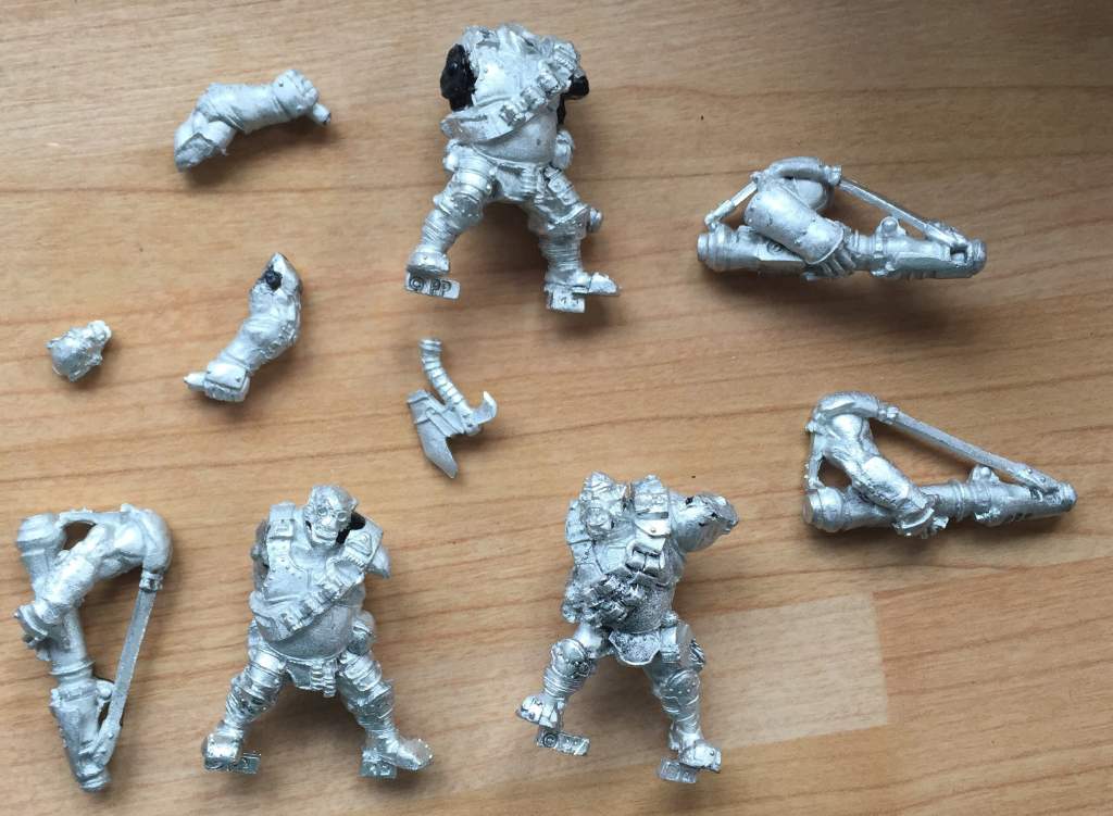

Well, I declare this a success!
Today the postman was kind enough to deliver me some figures that I had bought on Facebook. They were partially painted and the glue was giving up, definitely candidates for stripping. Given I was home alone with the kids today I decided to experiment. I have an ultrasonic cleaner to use for my airbrush, if you use an airbrush and don't own one, go and buy one! It makes keeping the needles etc clean, incredibly easy. Plenty of reviews etc out there for the so I won't go into too much detail.

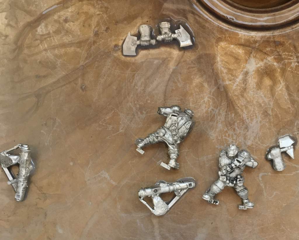

So after about 50mins in the cleaner I took them out to check progress (okay I peaked earlier too). This was the result.

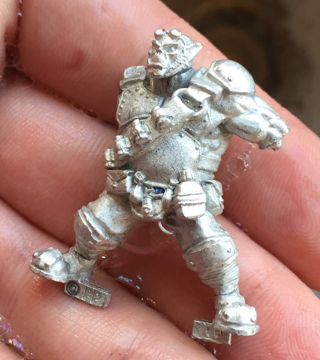

As you can see, most of the paint is gone already and I suspect I could have taken a toothbrush to them at this point and finished them off but that wasn't the point. One thing I did notice at this point is the glue that had been in the figures kept it's paint colour. Made it easy to spot and flick off with a blade though. Back in they went!
After another 40mins I decided to stop and finish the test. An hour and a half seemed like a good length of time and far quicker than normal.
Pretty damned clean. Something I should point out here is that I got a bit carried away and used some water to start cleaning the Dettol off. Anyone who has used Dettol as a stripper knows this is fatal to the process as it combines with the Dettol and acrylic to create a horrible gloop that is nearly impossible to remove. This didn't occur... However I wasn't going to take chances and quickly switched to very soapy water to continue.

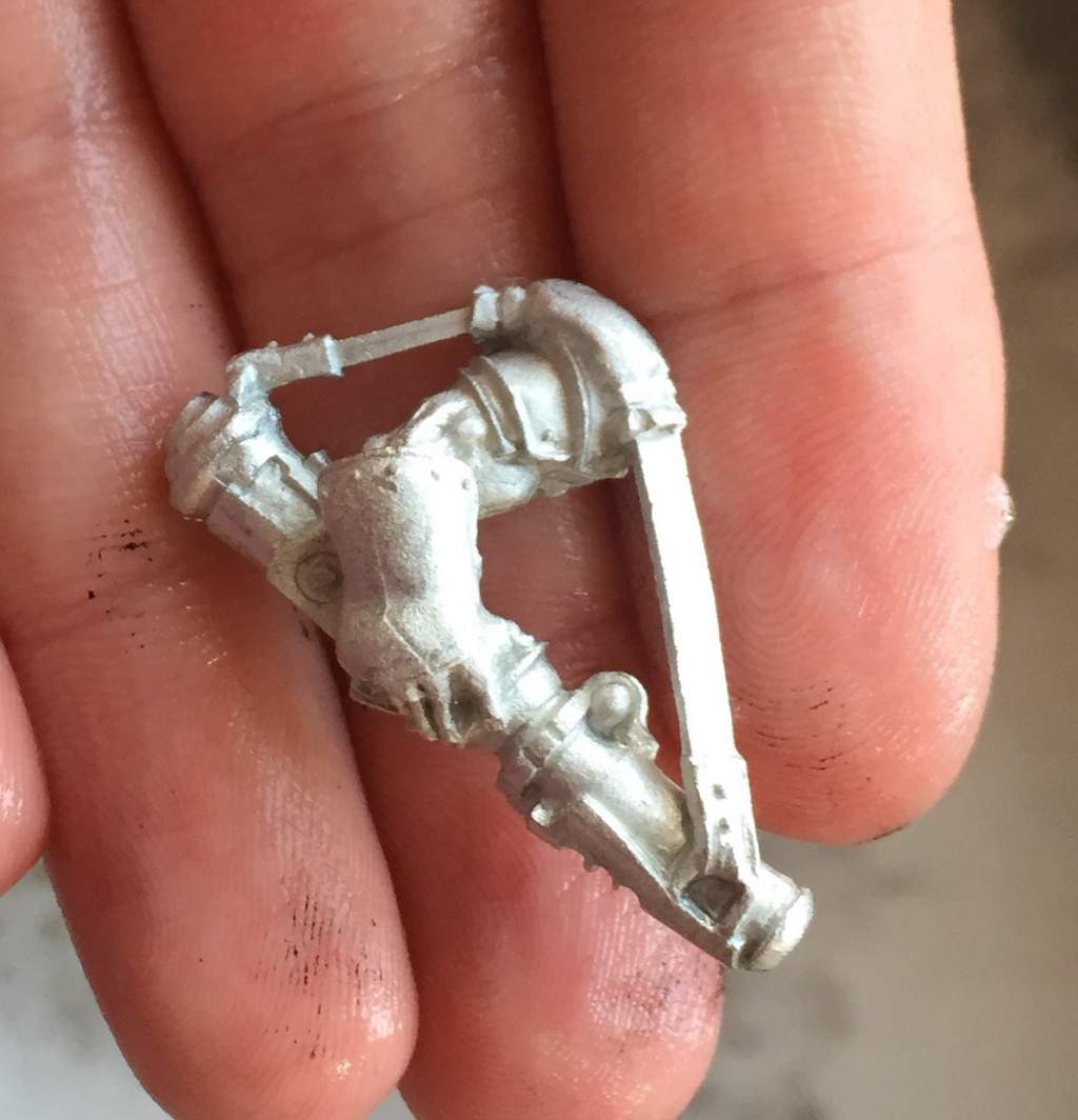

Here is a close up of an arm to show the paint is gone after a rinse in the water, no scrubbing.

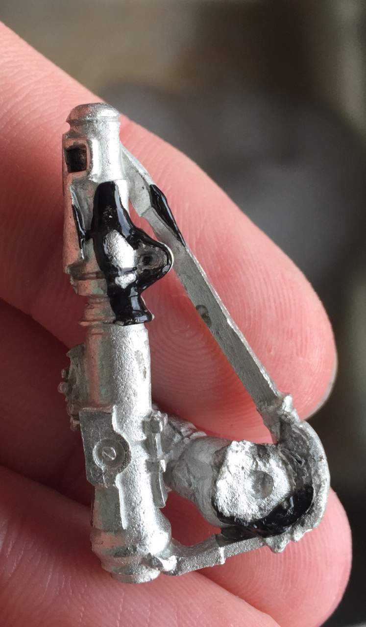

And here is a tiny bit of paint caught in the back crease.
Which came out with the flick of a cocktail stick, no effort required.

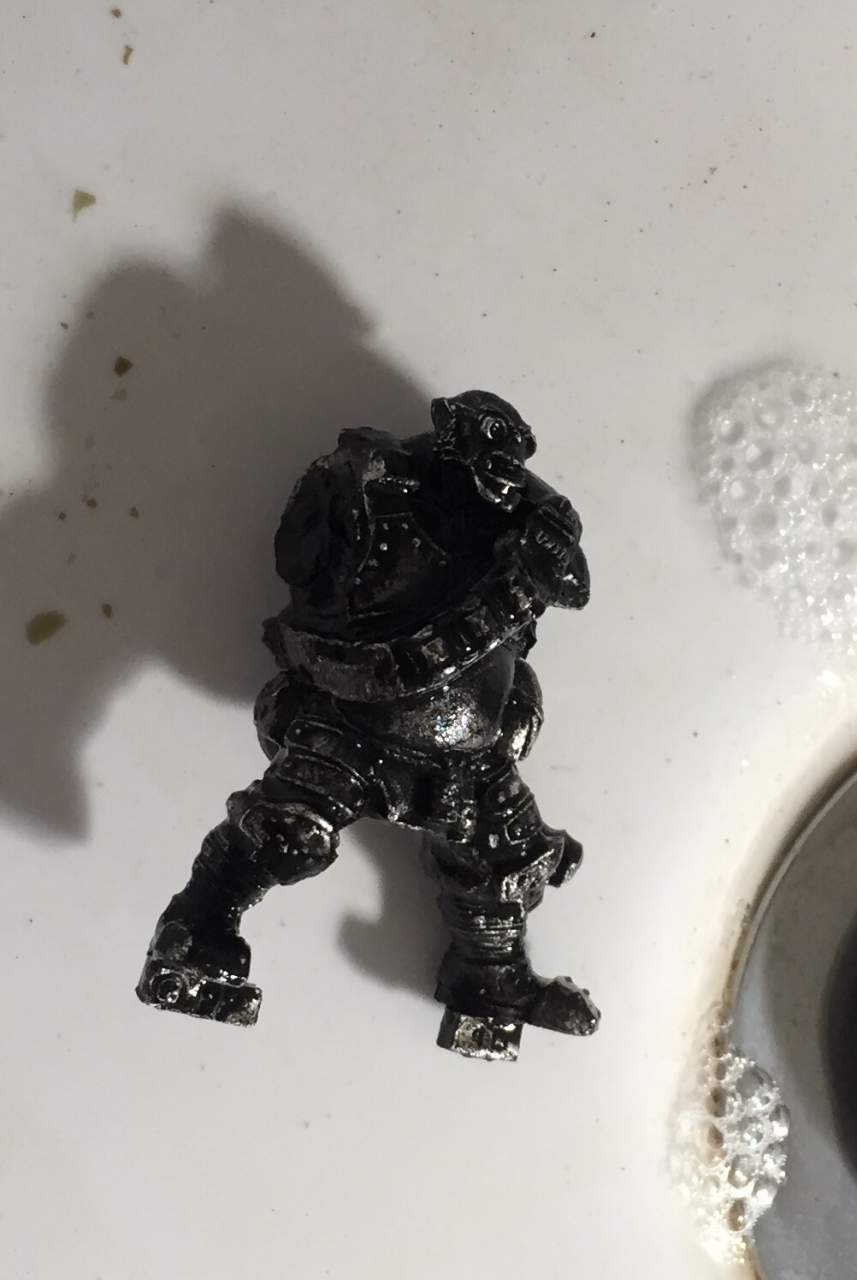

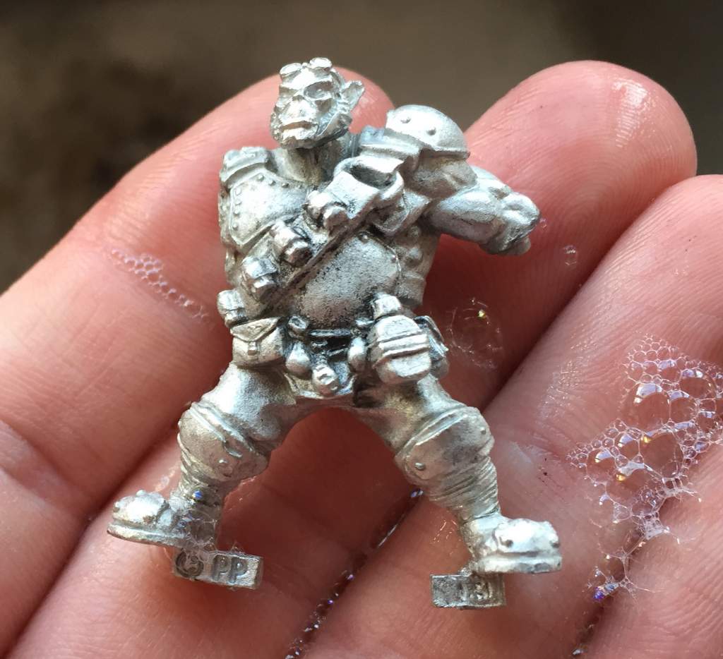

This figure was the 'worst' for having paint still on it.
And after passing a toothbrush over it a couple of times gently...
The colour in the belt is a bubble not paint.
So as you can see, after an hour and a half and practically no effort I have some shiny new figures!

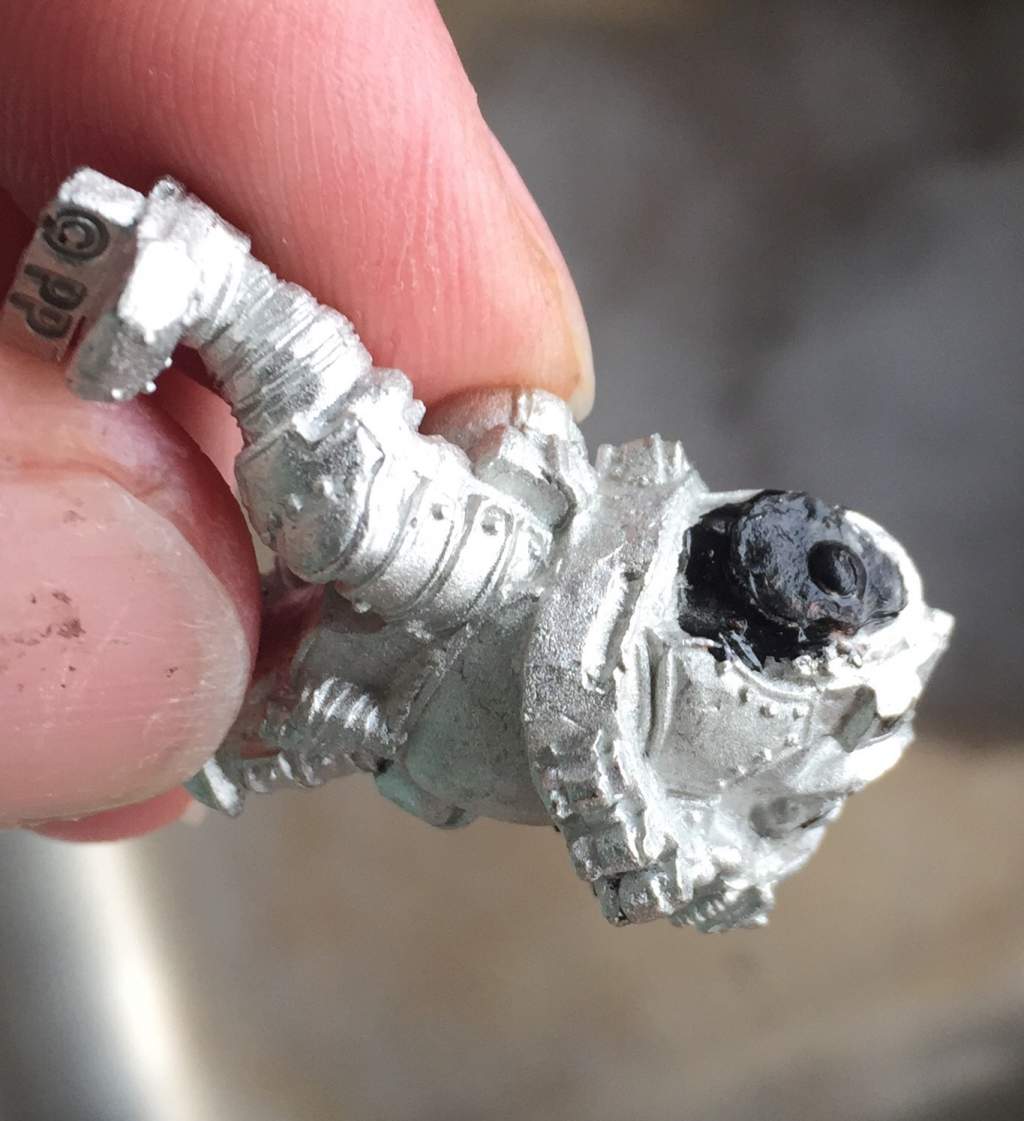

Here's a good close up to show how the glue still retains colour.
And another to show how it can be used to find glue you didn't know was there prior to stripping :)
