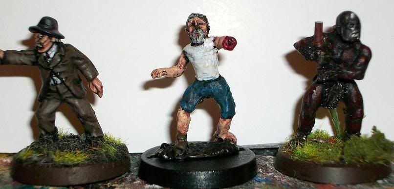

here are some of my results (varied success rate)
and here are some painted pics and scale pics.

the kit is from tiranti and it is £44.00
on turning up at the door its a bit disappointing with everything being so small, but once you get started its amazing, nothing i mean NOTHING has been more satisfying in this hobby for me as casting and painting my OWN miniature.
would anyone be interested in a series of zombies (only maybe) at 75p a cast or 3 for £1.50 i am sculpting some more and wouldn't mind making a profit, ALSO
