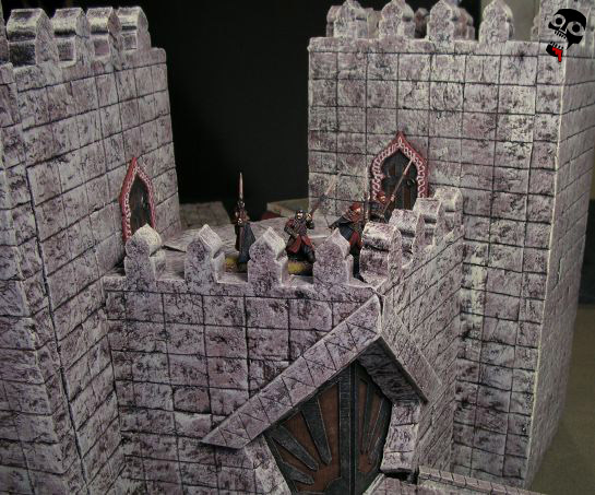

I have an article on how I created a stone castle/walled city here:
http://www.hourofwolves.org/?view=articles&which=buildingUmbar
Here are some highlight pictures:
Thanks

Neldoreth's method would be my first choice. I did some Khazad-Dum staircases years back using insulation foam and it worked perfectly. It's a bit of a pain because it gives off dust when you cut or sand it, but other than that it's easy to manipulate and add texture to.
If you prefer to use foam core, if you peel off the paper then you have a nice stony texture already waiting underneath.
