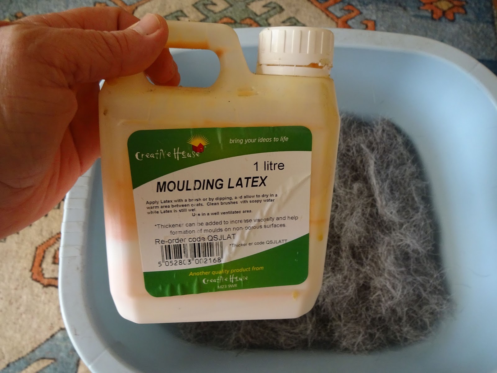

Some of the hair was layered over a sheet of granny grating and placed into a bucket.  I then poured mold making latex thinned 1/1 with water over the horsehair.

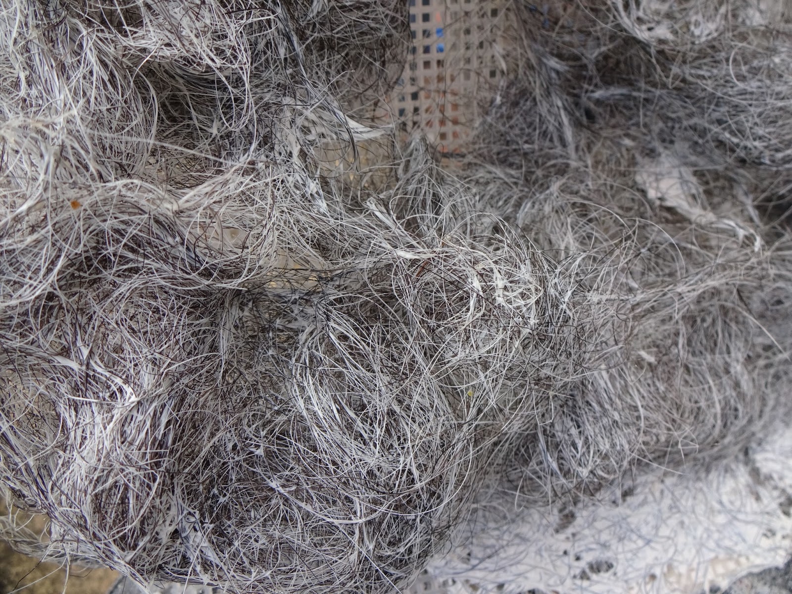

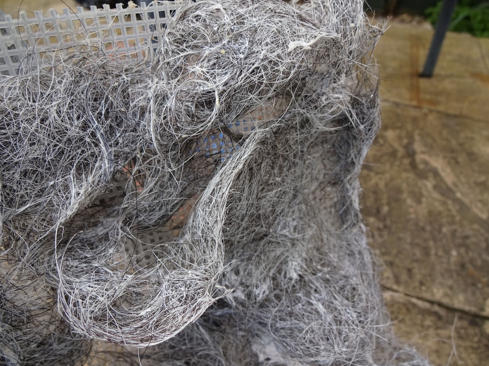

Once the excess latex was strained from the hair it was set to dry.  Here are two images.
Once I build something with it I will post images but it is just as fine as the stuff that I purchased form 4D modeling.  This is quite cost effective since most of the latex was reusable.

Quick update.  The current batch is not working well.  I have looked at it further and I think I need to use main and tail hair.  That will take longer to collect.  The hair from the rest of the pony was too fine and not quite strong enough.  I will post on this thread again once I try with the mane and tail hair.

Now for the Update.  Unfortunately I did not take photos of the process but it is pretty straight forward. First of all use mane and tail hair.  Hair brushed off the body is too fine.  Gather several hand fulls of hair and wash it in dish washing liquid picking out any hay or shavings.  Let it drain and while it is still slightly damp put it in a zippered freezer bag.  The mold making latex is mixed one to one with water.  Then add a couple of drops of dish washing liquid to break the surface tension of the water and mix well.  Pour this into the plastic bag with the hair making sure the hair is well covered.  Drain the excess latex from the bag, remove the hair and lay it on a piece of granny grating to dry.  Once dry it is ready to use.  Cut it up and tease it out before using.  I am including photos of purchased rubberized hair vs home made stuff used to make tree branches.
Purchased
Home made
Hope you like.
Snitchy sends.
