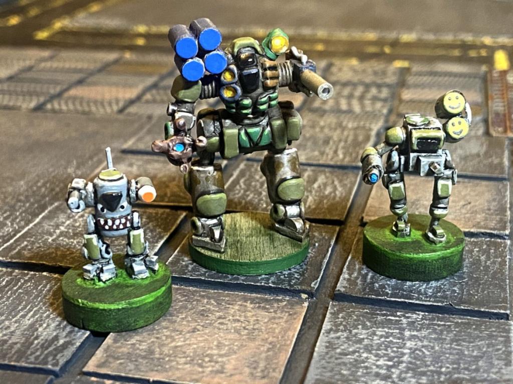

I love PVC board. Yes, it cuts fine with a craft knife. I use a mix of 5mm and 1mm and the 5mm takes a couple of passes while 1mm cuts easily in a single pass.  Not only does it cut well, but it etches well, and I've had good success with both PVA and super glue bonding it to other items. Here is a project where I was using 5mm PVC board to make sci-fi consoles for a 15mm spaceship.
And the finished product:
I also use this material for basing larger terrain items (it can be textured by rolling a foil ball around on it) and I've even used it to carve bodies for 6mm mecha (far right)
It is useful material. I'd buy this every day over foam core or other foam products.
